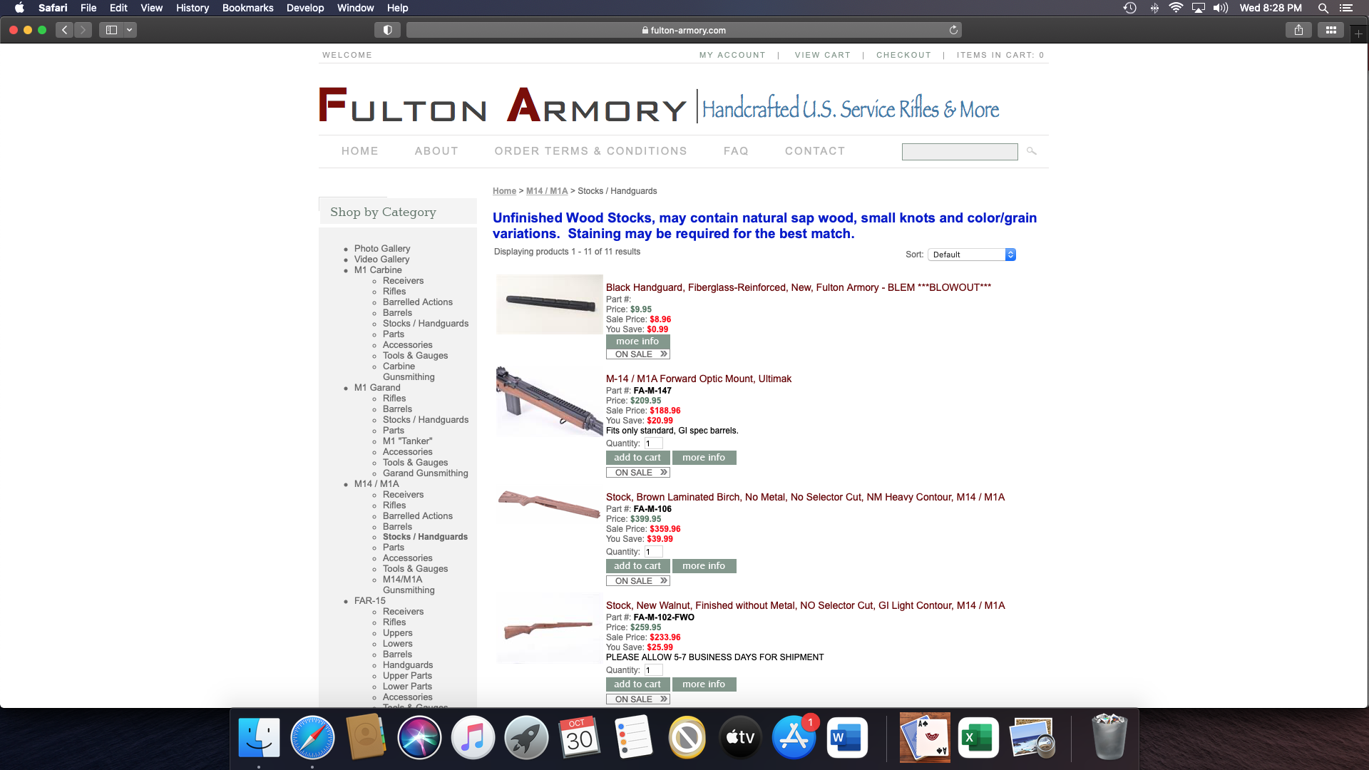

Try this place....lots of choices for an M1A.
