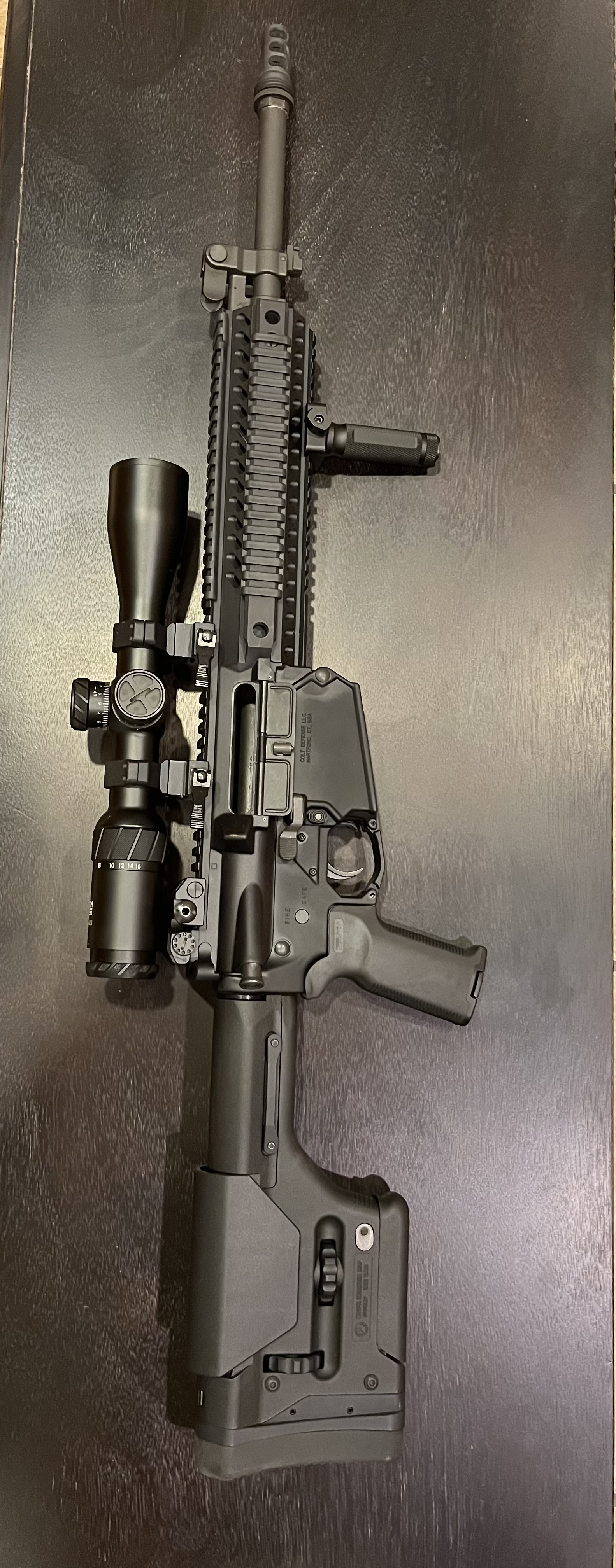

My LE901 is a tac driver. 100-200 yards will put 3-5 rounds touching. I’m a 1”MOA guy myself on my ability, but others “better than me” have put 5 shot groups touching at distance in the size of a dime with my rifle.
Heavy as heck, but it is a fantastic rifle.
