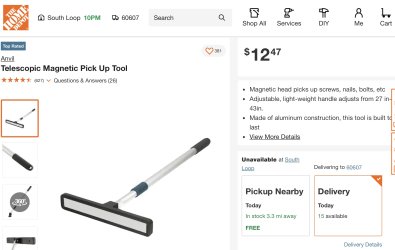

I lost a thumb safety plunger that either launched or rolled away and nowhere to be found. Tried using a smaller magnetic pickup tool to scan the bench but the for the floor I got one of these and got lucky a number of times.
Definitely worth the $13 compared to the cost of all the lost parts (plus shipping) I’ve recovered that have gone missing on the shop floor. Even when during work outdoors recovered missing sockets, bits, nuts/bolts, etc. even a lawn mower cord guide was able to be retrieved after going over the grass.
