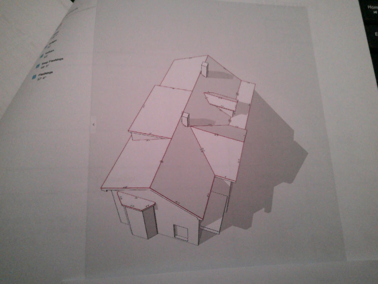

this is satellite generated view of the roof. (there are 2 smaller roofs on the backside, not seen here)
