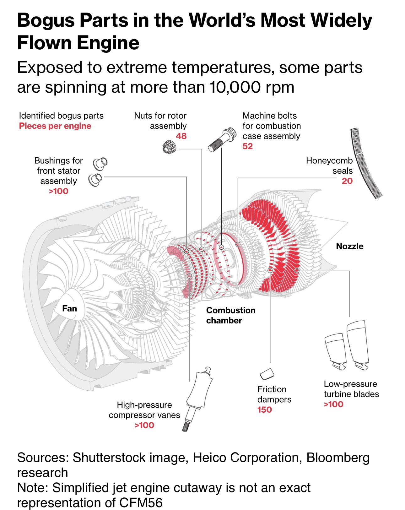

Bolted joints and fasteners are "kind of my thing" and the garbage T10 screws in our RDS drive me nuts. That isn't unique to consumer stuff though, many $100K+ defense articles use 18-8 **** fasteners because proper A286 ones cost $5/piece and there are sometimes 100s of these in an onboard avionics box for instance. But this beats everything I've seen since the Thiokol seals on Challenger, hundreds of low quality counterfeit parts in commercial jet engines!

CFM56 engine; GE Aircraft Engines and Hispano Suiza. I have experience with the manufacture of parts for both companies as well as Pratt Whitney, Rolls Royce and Hamilton Sundstrand. The OEM's are extremely diligent in the specs for their engines. It is my experience that GE is practically fanatical about it. The problem comes in at the suppliers falsifying documents; QA needs to be very diligent about this with testing, vetting certifications etc. A huge issue comes in with maintenance and re-builders. They are not above looking on line for "equivalent" parts or "surplus" parts. I ran into it myself where a company I was at took an order for a small lot of a spare part assembly. They thought they could buy overrun small parts from a surplus supplier. It was pointed out that extreme certifications for materials and testing were required, supplier could not supply. They then tried to have the material testing done themselves and once the costs were realized got the order cancelled and ate the cost for what they had bought. My company was at least honest enough that they would rather eat some costs rather than send parts out that did not meet requirements. There are entities out there that I cannot say that about.

Honestly, nothing will be done about this until a plane falls out of the sky with 3-400 passengers on board. Maybe even that won't be enough!

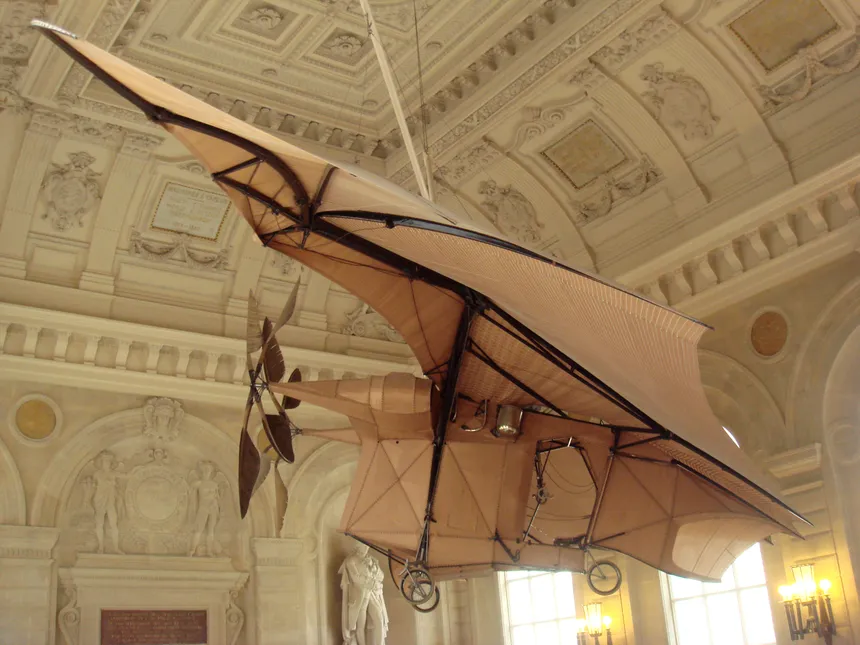

All info points to Gustav having controlled flight before the Wrighjt Bros. The only problem is that he dodn't document or promote it as well.
