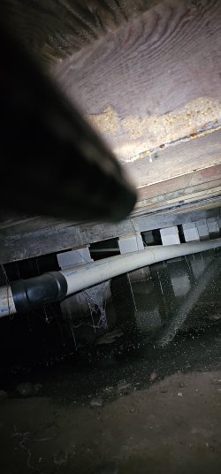

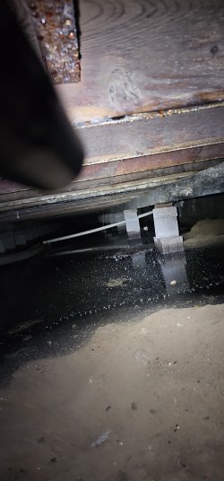

Talk about plumbing issues! I live above a lake....well above a cesspool. So far we've excavated 4' down where the septic line could be and about 50 linier feet. Still haven't found the line. Gray water line we found at the top of the foundation. Time to move out and set the :poop: house on fire! After 2 months of no ac from June and July to this :poop: now!

Hey Tex, Sorry for your troubles, but this is sorta my line of work. Are you looking for the septic lateral from the house to your septic tank? You mentioned a "gray" water pipe....I assume that's your fresh water supply (either from a well or municipal supply)?

Gray as in sinks, showers and washing machine waste water. Septic tank and cleanouts are withing 5' of each other, so that was the easy find (already knew where both were). Septic tank is about 90' from the house and 10' deep at least. Now account for the slope and there's no way for it to be 4' deep at the house's foundation. My yard is starting to look like this

Fair enuf...didn't know you knew the terminology (gray water, black water, etc)...90' run to tank is pretty far...A local pro should have a rod he can run through one of the clean-outs to trace the lateral, if that's your goal.
