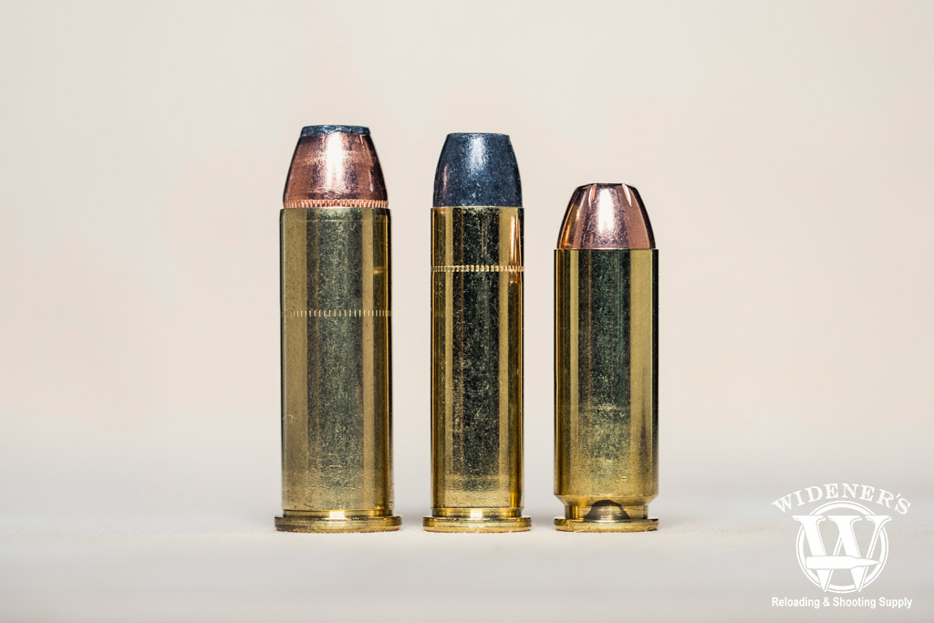

What Is Magnum Ammo?
A generic definition of magnum ammunition is typically “a cartridge equipped with a larger charge than other cartridges of the same size.” While this is essentially correct, it’s still a long way from the complete story.
