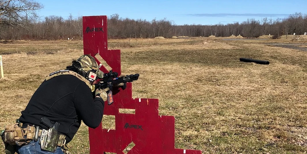

I usually shoot with it like this -
^ Where I cam the pinky and ring fingers in a manner that's similar to my handgun support-hand's "thumbs forward" hold, but you can see how in the picture below, where I've bumped to my support side shoulder to take the shot (under a vehicle) I'm really pulling back on it with my entire hand, in order to obtain more stability.
Now can see in the picture below that I'm using it as a barricade-stop.....
