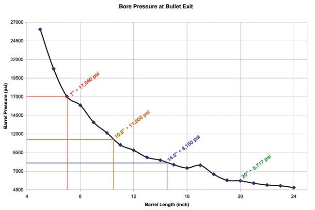

Shorter length M16/AR15 barrels are over-gassed due to the gas port being closer to the chamber vs. the original 20" length for which the 5.56 was designed for.
Chart of barrel length against bore pressure.

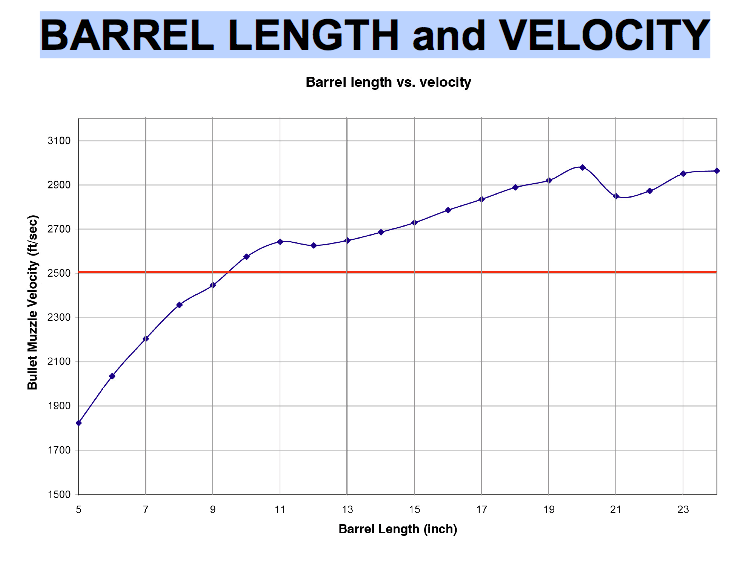

Subsequently, there is an inverse relationship between barrel length & velocity. Peak velocity is achieved with a 20" barrel.
M855 Barrel-Length-Velocity
i don't believe exit/muzzle pressure would be that low, especially on a small bore and chamber pressure @ 55-60k. 17k @ 7".......no way unless it's a sub round then maybe
That's the pressure(s) once the bullet exists the barrel with mil-spec loads.
Pressure goes down with greater barrel volume as the chart indicates.
i realize that, but no way it's that low or concussion from pressure would be less........ask @10mmLife about his experience with a shorter barrel. unless powder has changed (which could happen as it can change exit pressures) to keep velocity the same, there's still no way for it to be that low. i'll try and do some reloading on those projectiles and chrono them, but don't have a 14.5 or 7" barrel. hopefully quick load will help out as it takes many tweaks/adjustments to perform correctly. chrono info is a start and much needed for ql adjustments.
The charts are for mil-spec ammo, and you'll get different results with handloads.
Do you have the capability to measure barrel pressure variations?
i would like to have a pressure trace to more accurately verify, but not knowing the exact powder used keeps me from inputting it into ql. the newer powders for mil ammo aren't available like the old days where it was just imr with a different designation. faster burning powders might yield close to listed velocity and will produce less muzzle pressure as it will burn off faster closer to the chamber unlike slower powders. you reload and know about this. probably been reloading longer than me and a lot more as you did prs and/or competition shooting. ql give pressure numbers the whole length of the barrel inputted all the way to the muzzle and if enough of the info put into ql it can give numbers that are within a smaller variance. with others that use ql that will state a chrono is needed to verify as you might need to change values. knowing case volume (h2o) is of big importance along with muzzle numbers. after that you can tweak to meet chrono results. having m855 and m/xm193 i can get a start if i get chrono numbers from barrels i have. i'll also check velocities between other barrels of the same length to get a more well-rounded test. if you need or want some more 140gd's midsouth has some for a good price?
