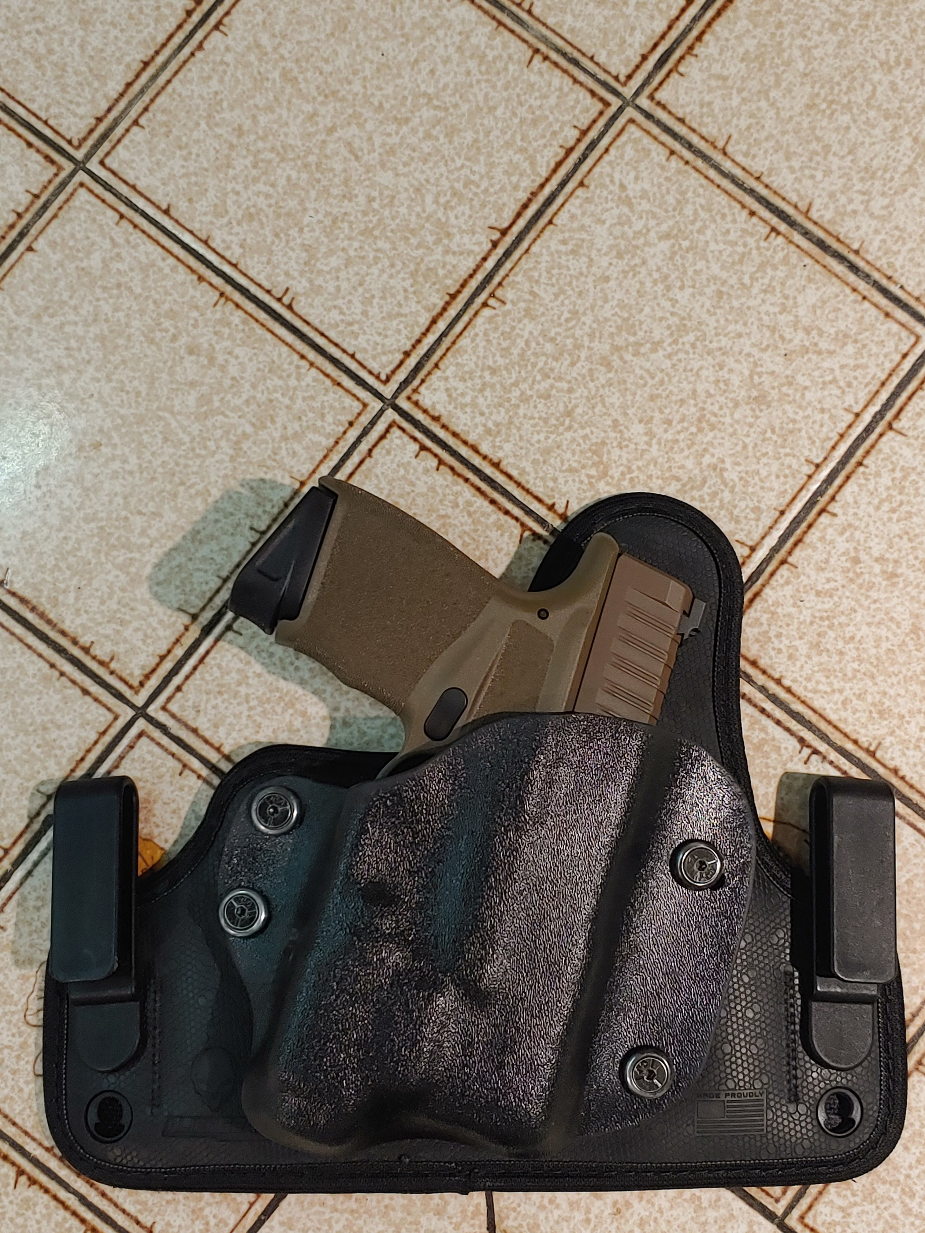

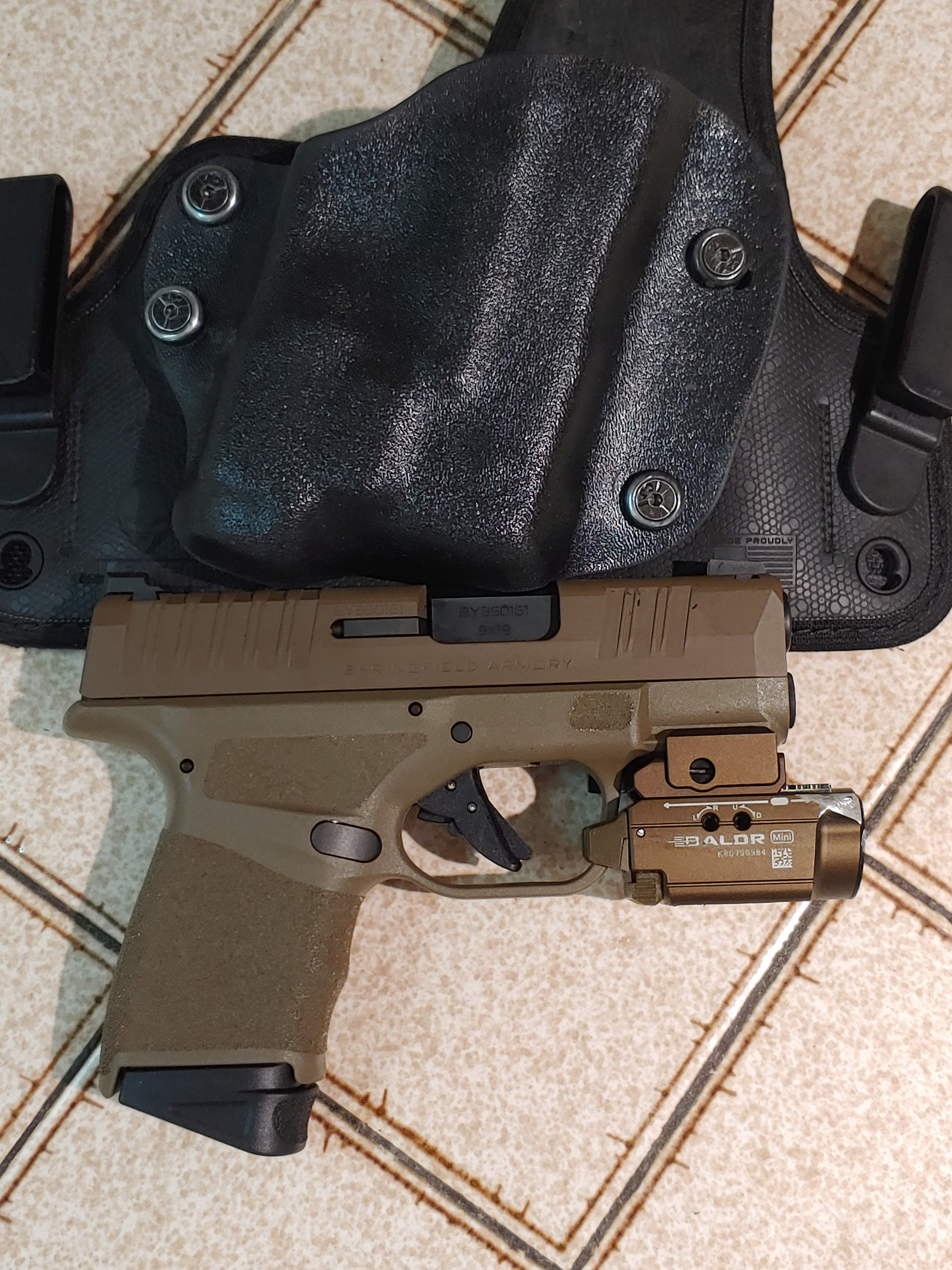

Success!
Third try and I got it right. I was messing with foam densities to get the right "wrap" - and my toaster oven DEFINITELY stinks now - but I have an EDC holster for a Hellcat with an o-light BALDR rechargeable tac light with green laser.
I had to file some hard corners on the leading edge of the o-light so it didn't hang up on reholstering, but it works and retention is excellent. I'll hit the light with some touch up paint tomorrow.
And as an added, unexpected bonus...every time I draw, the holster activates the light! I don't know how I lucked into that...but I'll take it! One less thing to think about if I have to draw under duress.
