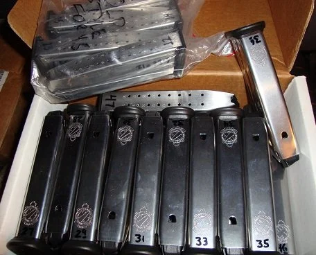

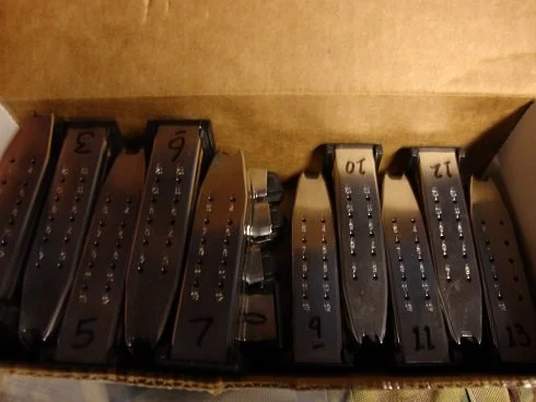

If it is the magazine(s), I'd encourage you to both purchase new replacements as-well-as pursue remediation for any that are problematic.
Provided that you live in a free state, currently, magazines can be had for very good prices. Since magazines are really the one "disposable" part of our autopistols -and is one of its greatest weaknesses- it really only makes sense that we have some backups readily available. If the pistol is used for or is intended for a serious purpose, this would doubly make sense. Larry Vickers himself recommends no less than five (5) vetted/proven magazines for each defensive/duty weapon.
And yes, I have put my money where my mouth is. where it comes to magazines for my XDms -
^ 13-rounders for my 3.8 compact.
^ 19-rounders for the full-size guns...yes. there's a row under that top 10.
....and remember that I've got another 15+ of the 19-rounders in active-use.
Even the new 35-rounders: https://www.thearmorylife.com/forum/threads/xdm-9mm-35-rd-mag-initial-report.10081/#post-133759 :)
Buy them cheap. Stack them deep.
And absolutely keep a running tally of the mileage that your guns have seen.
It's just like the mileage on your car - how else would you know how much/hard it's been used? ;)
Some folks go so far as to keep track of every single round fired - I don't (yet) have any guns that requires that much attention. but I do try to ballpark mine by every 500 rounds or so.
It's not only a great way to troubleshoot, but also gives you an idea of the type of preventative maintenance you might need to do.

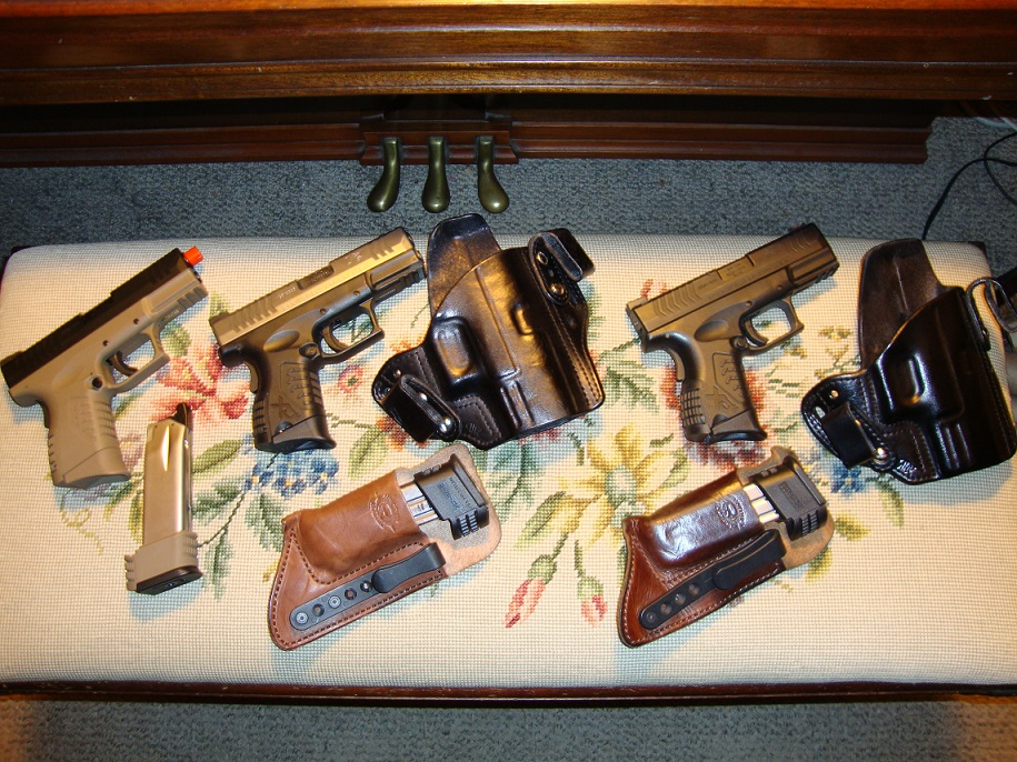

For me, consistency is almost magical. It's -quite honestly- a salve that I can depend on even under the worst times of stress. So, for me, it probably comes as no surprise that I do the same with my defensive firearms. As you read in my post above, for my EDC handgun, I maintain a near-carbon-copy (the only difference is the aesthetics of the slide) for training/range use.
I've made some changes to the holster, but otherwise, I think this picture demonstrates what I mean above. Left to right on my daughter's piano bench: airsoft, range/training beater, EDC XDm9 3.8 Compact.

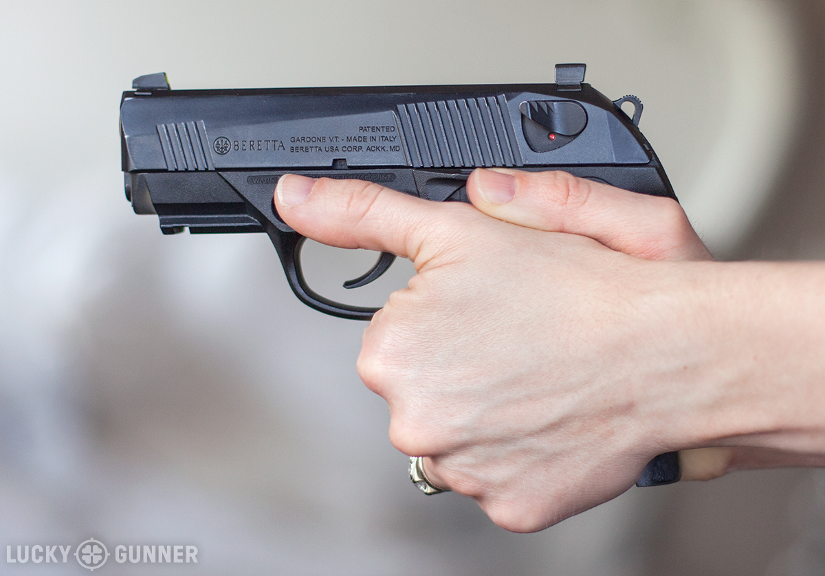

^ When speaking of grip, many of us here - both you and me included, it would seem - favor the modern "thumbs forward" grip.
That said, there's a lot of differences in just how it's executed: https://www.xdtalk.com/threads/grip-this.257169/
In Vogel's class, his demonstration of his "thumbs forward grip" had his left thumb (he's right handed) riding so far forward that it was in-essence coming off the grip:
^ *image not mine, stolen from the Internet.
One of the things that he said in his class is that his grip often causes his slide to not lock back on-empty, but that given his shooting needs, the slide not locking back on-empty is not that important, and that he'd rather compromise that in order to get better recoil control, which *is* what's important to him.

I will be hitting the range again soon and will incorporate the mag labeling, try the off-hand shooting test, and pay more attention to a) what ammo is in use when/if any failure occurs and b) how my strong-hand thumb is positioned during 2-handed shooting.
