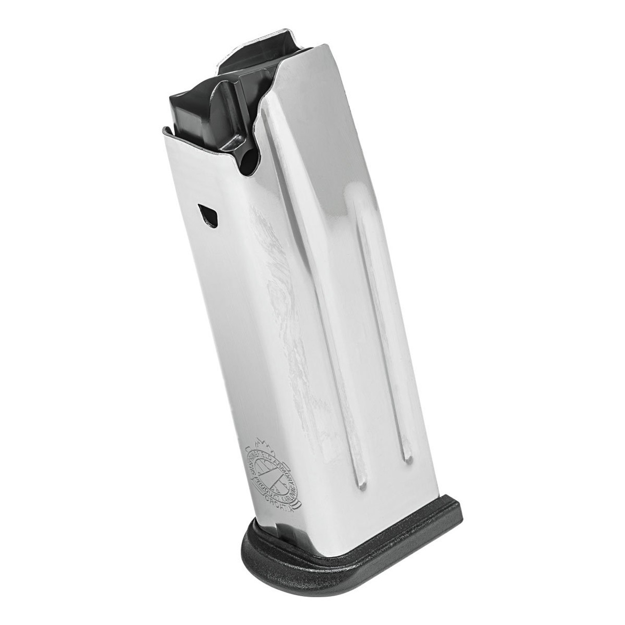

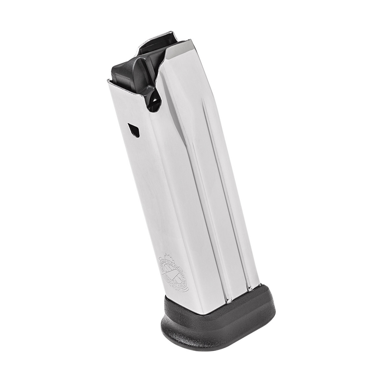

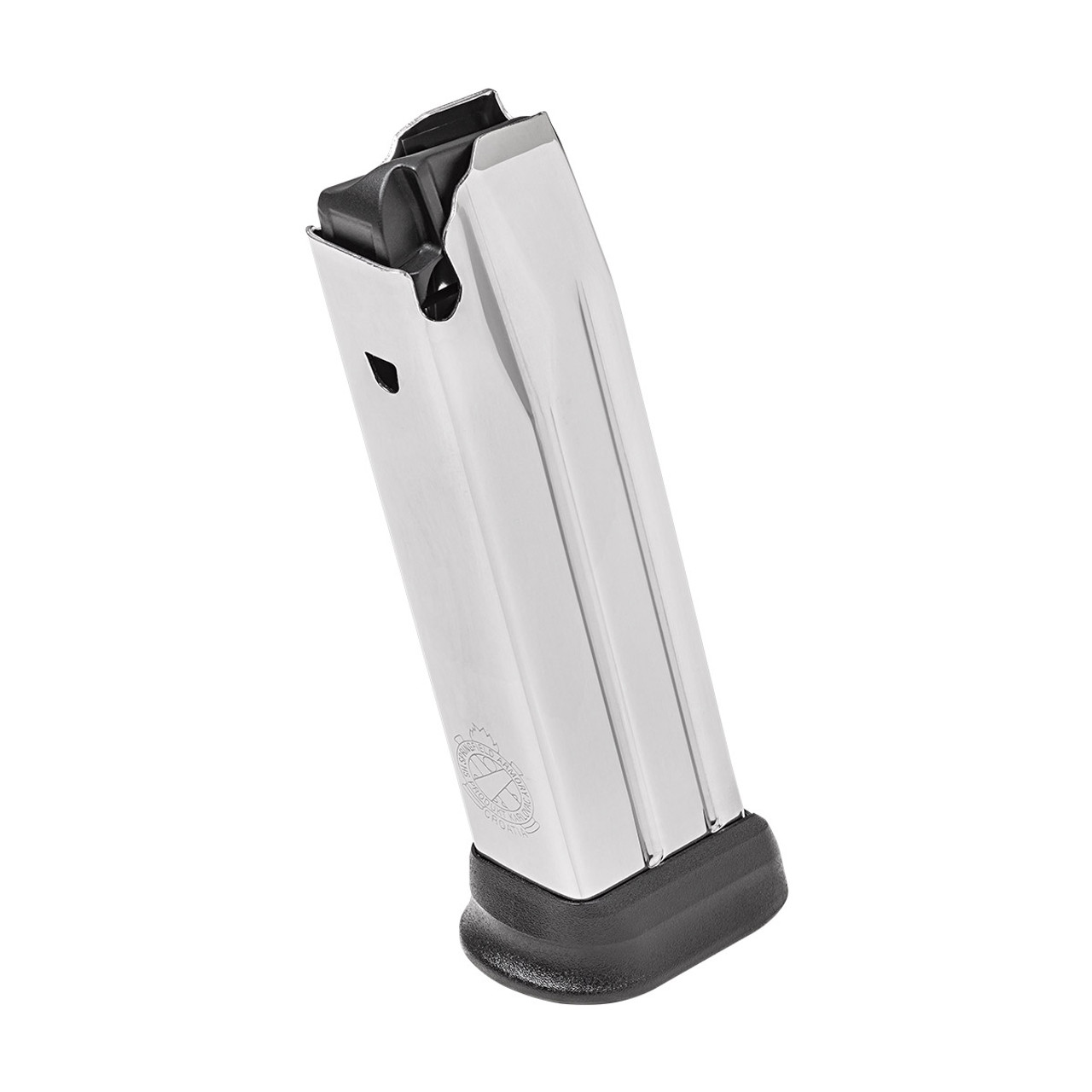

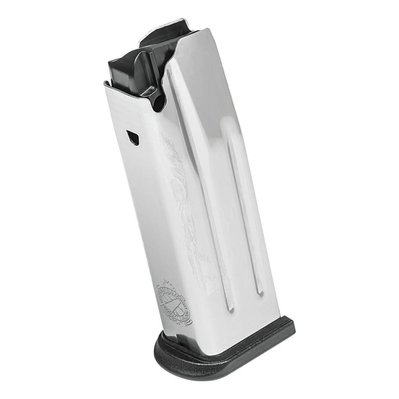

OK, I ordered XDM FULL SIZE MAG 10 mm for my XDM 10mm elite, and it won't stay in the gun. The baseplate is about 1/2 inch on the one that won't stay and the baseplate on the one that will is about 3/4. BUT it goes in the gun, clicks in, but will fall out. Seems to be exactly the same from the baseplate up but won't work. Any suggestions or help?

The magazine for the XD-M 10mm for Flush Fit.
The Magazine for the XD-M Elite 10mm with a Magwell, the extended baseplate not only is tapered to fit, it allows an additional round for a total of 16.
