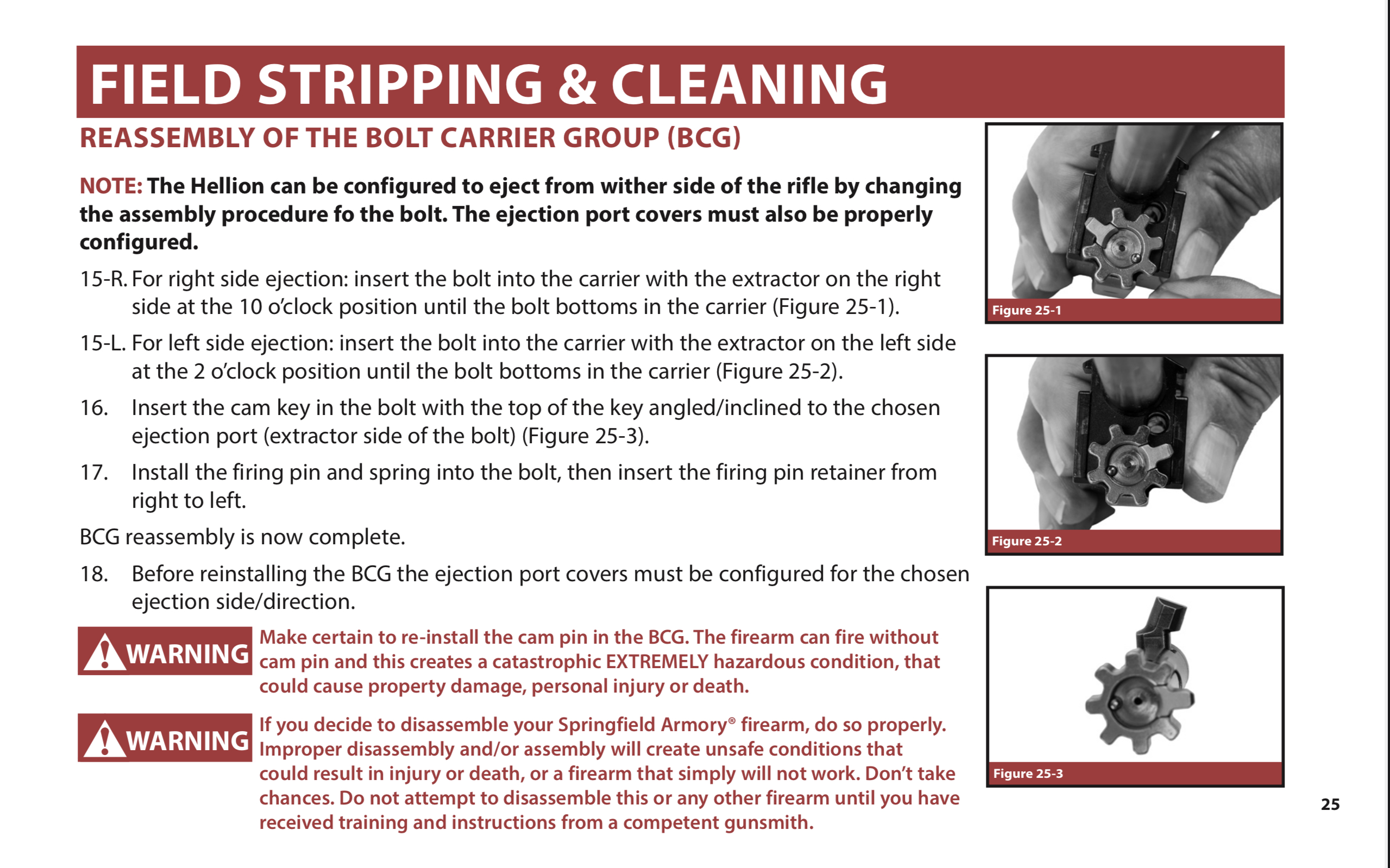

An update from my Croatan Army Friend who has used these rifles his whole adult life, about corrections he sees need to be addressed on the videos he is seeing. (Note remember English is a second language)
1: “so across the videos there were multiple things...usually one per video. most were about changing from right to left”
2: “one said just to open the port on the other side...no mention of changing the bolt”
3: ”while it might work one one or two shots..it will lead to FTE, double feeds, crushed casings”
4:”then when they are showing the change they dont mention that you need to change the side of the cam (not sure if thats the right english word)...they just mention rotate the bolt”
5: ”on one...they say that it has the last round bolt open but that you cant do it manually. (now i am not sure on civilian version)...but on vhs 2 if you pull the charging lever back and stick your fingers into the mag well you can pres the lever inside and leavin it in the rear position...it aint pretty but it works...same like with the magazine after the last round”
6: ”when they are taking the back off...most just rip it
and have issues with it, but with just a little downward pressure on the back it will go out easy as pie.”
7: ”croatian military doesnt use g36 magazines...we use proprietary magazines from HS produkt”
8: ”your version of the rifle has almost everything we wanted on ours....but didnt get”
9: ”for me personally the disassembly pins that cant be taken out are the best
wish we had them so soldiers stop losing them. and QD.”
here is the procedure to proper change ejection direction
