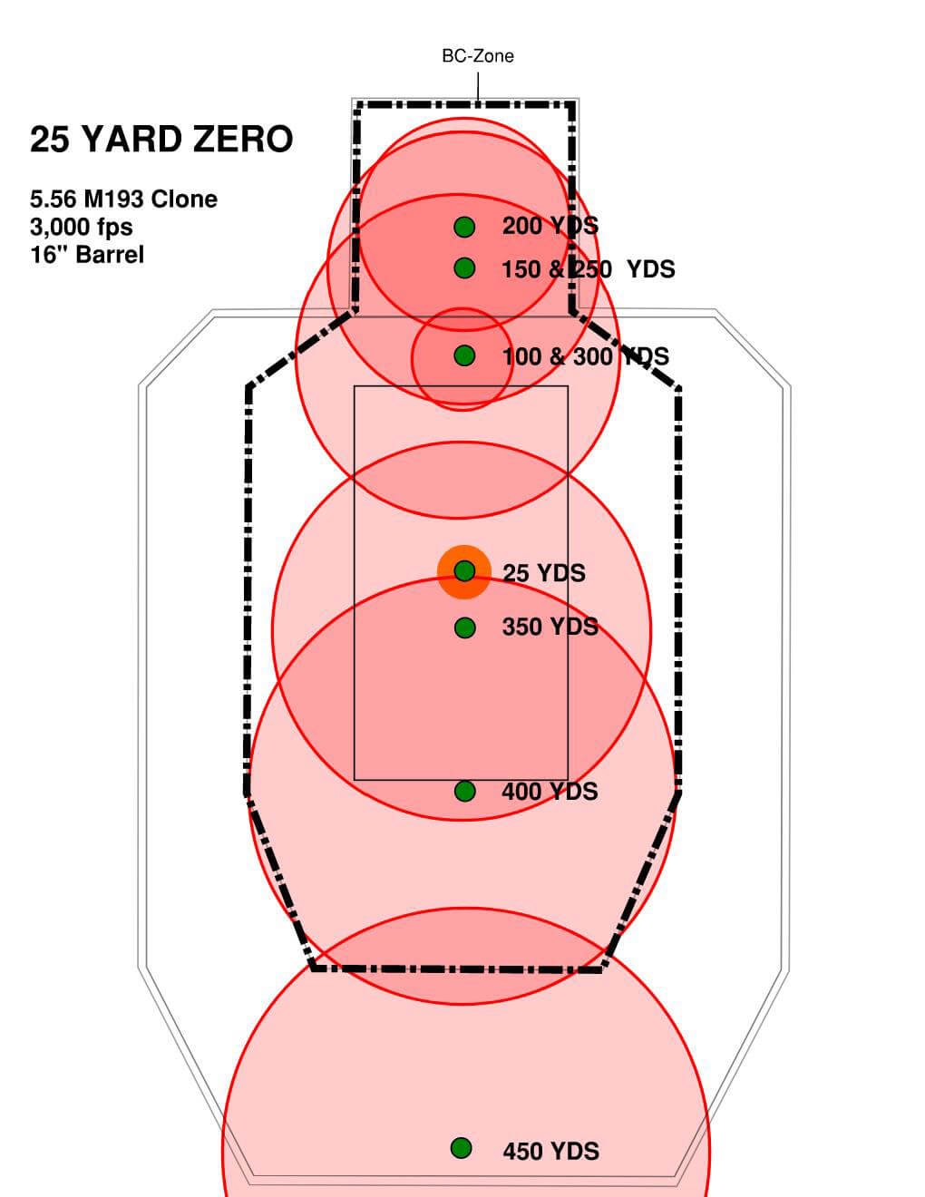

And yes, if you are zeroed at 25, you will be high at 100. How high depends on that exact optic-over-bore dimension. Standard AR's with standard height dots/optics are zeroed for elevation equally at 25meters and 300 meters...anything between the 2 (25 & 300) will be high. (Assuming a 55grain bullet from a 5.56 nato round...bullet weight/velocity affects everything)

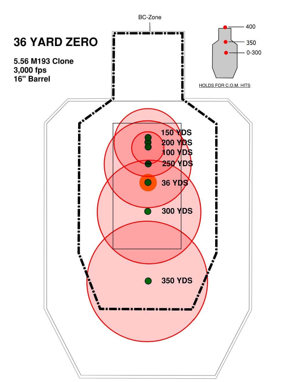

There was an article a while back that showed that the best overall distance to zero, to be able to effectively engage a…bipedal…Target out to about 350 yards was a 36yd zero.

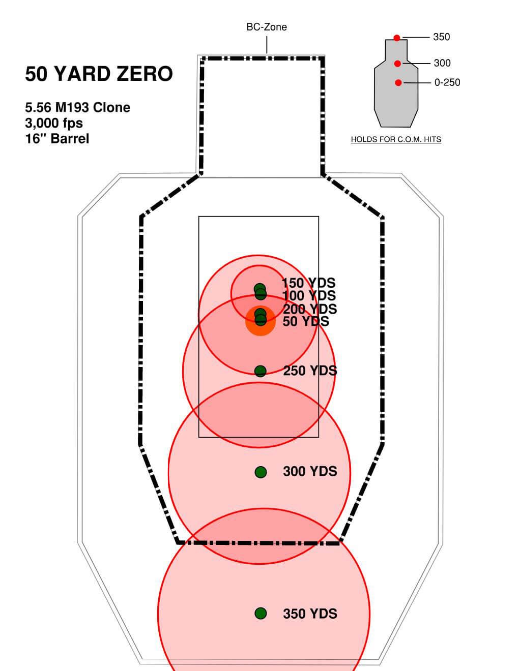

What I gleaned about the 36 yard zero as opposed to a 50 yard zero is it will keep you on a silhouette at 350 yards where you will be low with a 50 yard zero. I zero all mine at 50 which works well for me. 350 yards through an unmagnified optic ? Even with a 350 yard zero that's a pot shot for me. If I'm going out that far I'll use the one with the scope, which is zero'ed at 200 yards currently.

I'm trying to my Hellion. I have an EOTECH WXPS3-0. I'm worried about the Parallax as it sits about 2" over the bore. If I zero at 25 yards will I end up striking high at around 100 yards?
