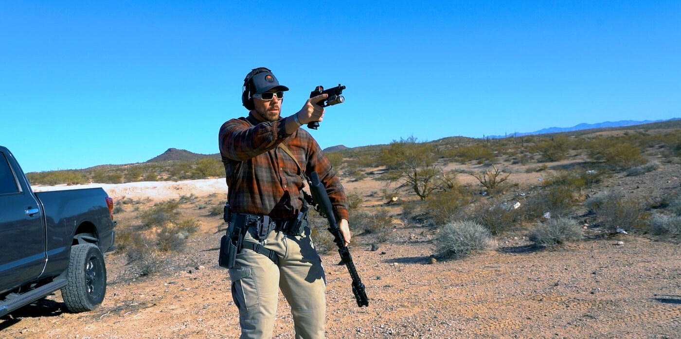

There are a few reasons to do these drills. First, they give you a good chance to learn how the malfunction feels when the gun tries to cycle. Second, they give you a clearance drill training scenario. And lastly, it gives you the opportunity to make a decision between taking cover or transitioning to another tool. In this case, we are using the SAINT Victor 5.56mm rifle and the XD-M Elite Tactical OSP 9mm as our tools for the day.
Man shooting drills with Springfield Armory rifle
The author used a two-point sling on his carbine when practicing the transition drills on the range. This allowed him to retain control of the rifle while engaging targets with his pistol.

So now that we know the why, let’s talk about the how in some simple steps:
  1. Engage the target
  2. Recognize a stoppage/malfunction
  3. Decision time: transition to pistol or run for cover
  4. Index rifle while gaining master grip on pistol
  5. Finish drill or re-engage target
  6. Recondition rifle

The basic steps are going to be the same whether you have an empty gun or a serious malfunction like a bolt override. With dry practice or live rounds this is a pretty low round count drill that will work not only on manipulations but thought process as well.
