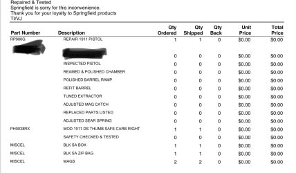

First range trip since getting the gun back from Springfield. Very happy so far. Trigger pull was A hair over 3.5lbs. I should add that before I went I changed the mainspring to a 17lb., added an extra power firing pin spring, installed an Atlas tool less guide rod and kept the 12lb recoil spring. I also installed a new slide catch, installed a short STI trigger and a Nighthawk Customs DTS. Don’t look at me like that. l know I have a problem. I had 2 failures to return to battery out of about 200 rounds. Both were with a Staccato magazine. With the factory mags it ran 100%. The Nighawk website says to expect 3.5-4lb trigger pull. Mine measured around 2.6 lbs. The last two days has not been without it frustrations though. I practically had to blow the thumb safety off with TNT (ok I’m exaggerating….a little). Now I cant get the Streamlight TLR-1 to mount!
