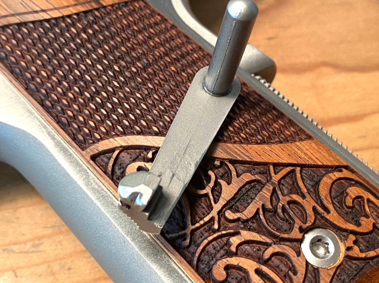

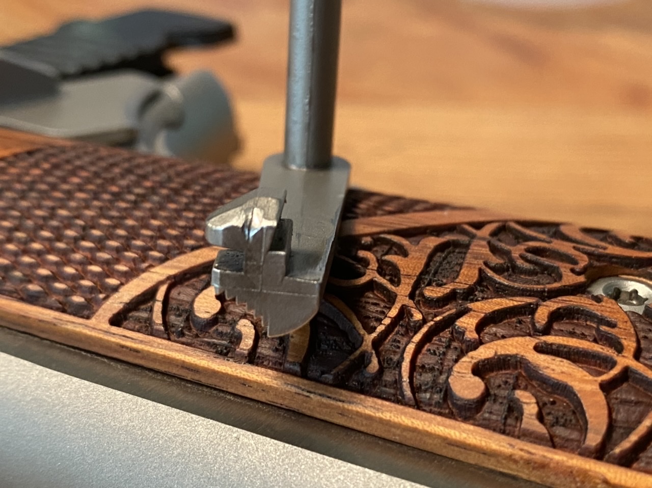

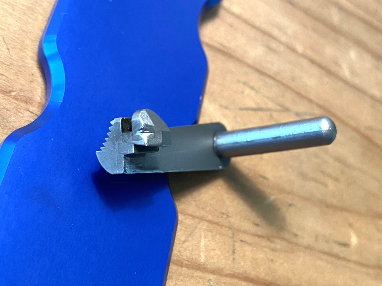

It occurred to me that link I posted above was to a conversation and might not be able to be accessed. Here’s the info on filing a notch in the take down lever.
Basically the idea is that you file a small notch in the take down lever where it contacts the plunger pin. This allows the plunger pin to gradually be pushed back rather than being forced back. I’ve attached pictures that show what I did. It’s not the prettiest, but it works. My Ronin was a dog to reassemble because of an extremely stiff plunger. I did this to my RO too. The link below is a lengthy thread from 1911 forum explaining how to do it. I found that it went very slow getting the groove started but once a groove started to form it happened quickly. You will need a set of needle files to do this

Thanks for the pics it helps a lot
