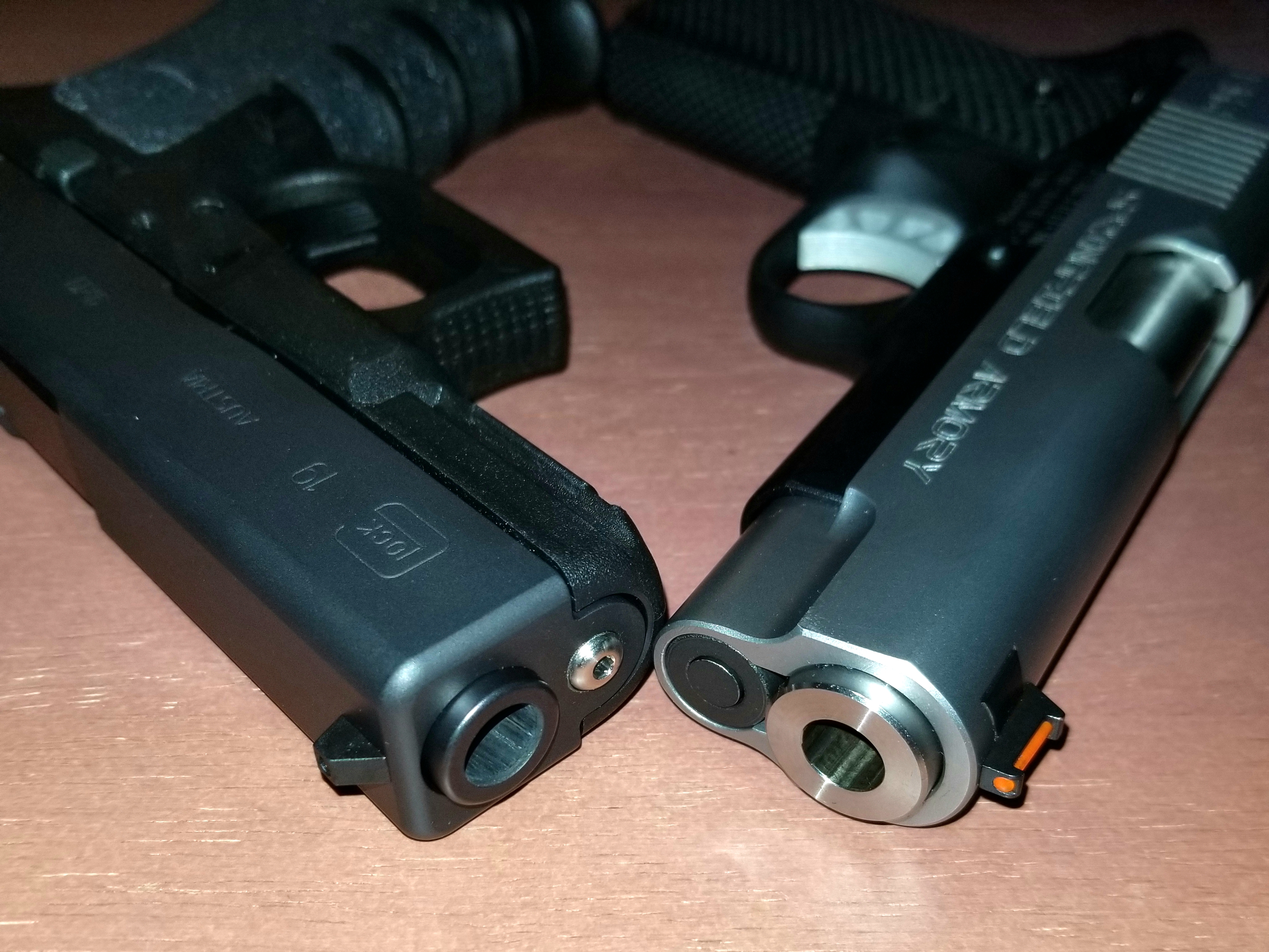

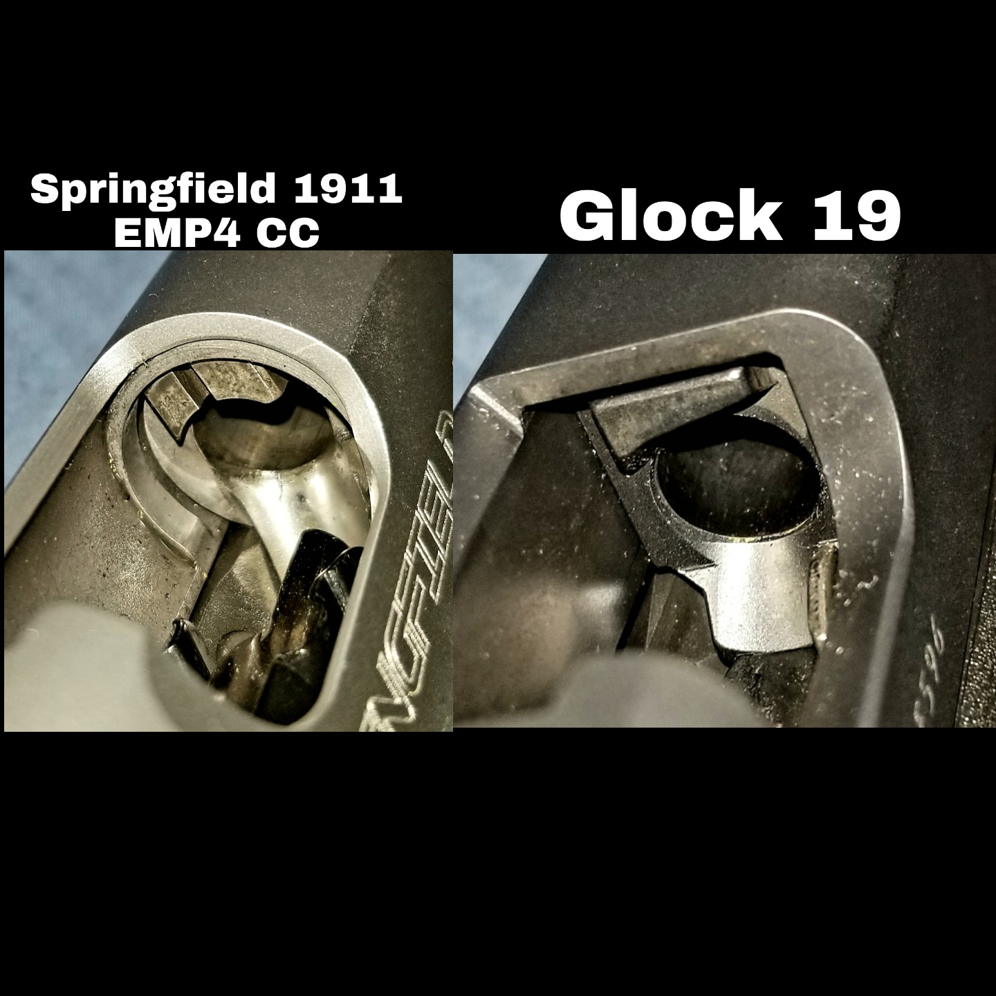

So, after all these issues with the 1911 EMP4 CC I went and bought a Glock 19 while I waited a month for repairs. Here is a picture of both feed ramps next to each other. The 1911 EMP4 CC feed ramp seems to be at such a steep angle compared to the 19. After I sent the 1911 in for repairs, it is working great so far, so this may be nothing.

Great photos by the way, and I don't see how a hollow point could make that ramp.

I agree, but putting the EMP4 side by side to the Glock 19 they are similar in size. The only thing I can pinpoint to a possible problem is the thickness of the match grade barrel, its significantly thicker than the Glock, which may be the reason for the steep feed ramp.
