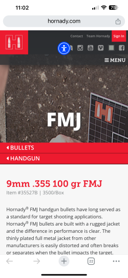

Also I have done the research or at least I think I have. Reason for my question to make sure i am on the right track. I have the Lee reloading book and the hornady app

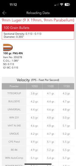

I'm out of state and don't have my reloading manuals, but you can use a starting load for the next heaviest bullet you can find. Lighter bullets use more powder than a heavier bullet which is why you use a heavier bullet data if you don't have the exact bullet weight information. We load using volume measures of some sort, but verify a given volume's weight to ensure we hit our target (pun intended) load.
For some reason I'm being picked on........pretty well versed with auto-comp as I use it. I know Sierra has 95gr fmj's and Speer, so Hornady might have 100gr fmj's? Maybe Lapua does? I'm just getting bed and I'll check load info and post later.
Yea Hornady is the bullet I am using. Appreciate the help; no rush whenever you get a free minute. Thank you

Yeah thats what had me second guessing what i came up with the only info i could find was from the hornady app but didn’t have the same info as the lee book does like starting grains snd Volume CC … I definitely will be buying powder they have listed in the future. Thanks for replying and the info
Ok great Thank you that is helpful. I was thinking of going that way but everything and everyone says be precise and exact. Like anything experience and doing something takes away the anxiety and the second guessing.
