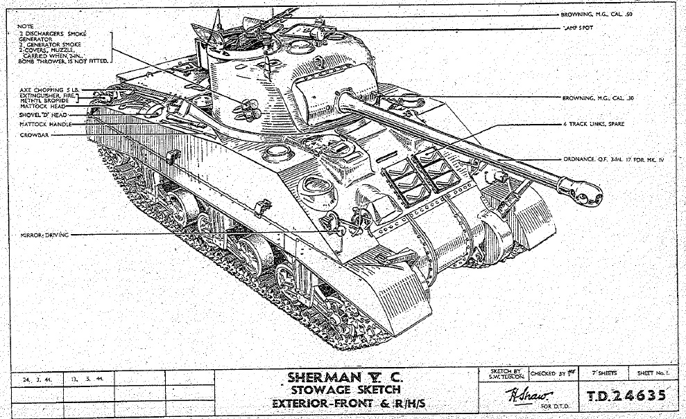

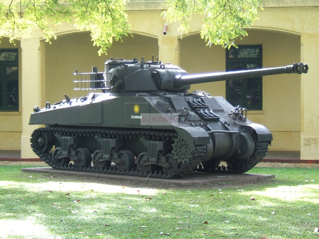

BONUS #3 - Brit Firefly

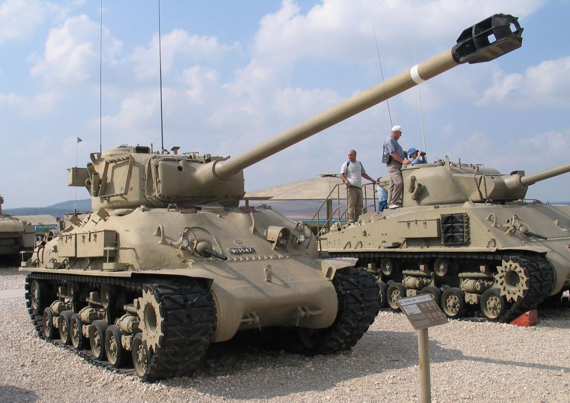

The 105mm M-51 (T23 turret) with a small-turret 75mm M-50 in the back right.

The claim of Israeli Shermans with the 105 being the most powerful is correct only in that it specifies "to have seen action".

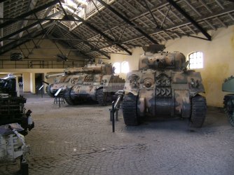

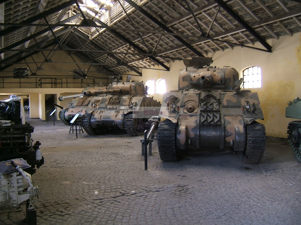

Numerous "Fireflies" were later purchased by Argentina and seriously up-gunned, up-armored and up-engined to create the "Repotenciados" with license-built 105mm guns from the French AMX-13, applique armor, smoke grenade launchers and Poyaud marine engines. Part of a rapid arming up in anticipation of unpleasantness with Chile over border issues that happily, did not take place. From the Museum of the Army, Buenos Aires. My photos. You can see a dismounted 17 pounder on the floor.
