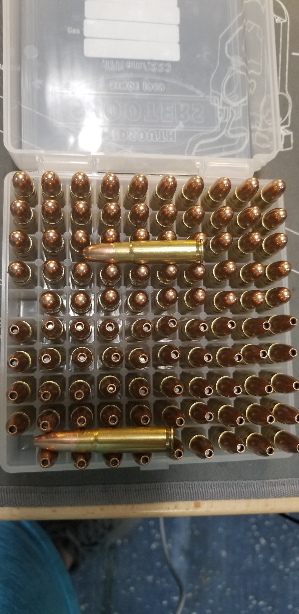

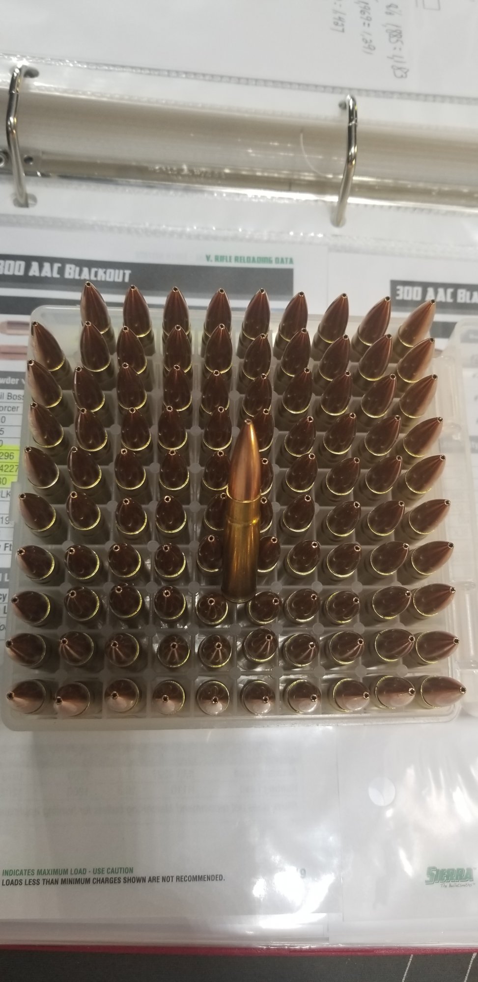

Great looking cartridges.... what are the COAL on those running?8.5" barrel velocities
I'll be loading some 110 here soon and was wondering "how short they would end up?"The 110hp 1.970"
The 110 fmj 1.845"
I'll try to run some threw and find out.I'll be loading some 110 here soon and was wondering "how short they would end up?"
As long as they cycle without a hitch.
