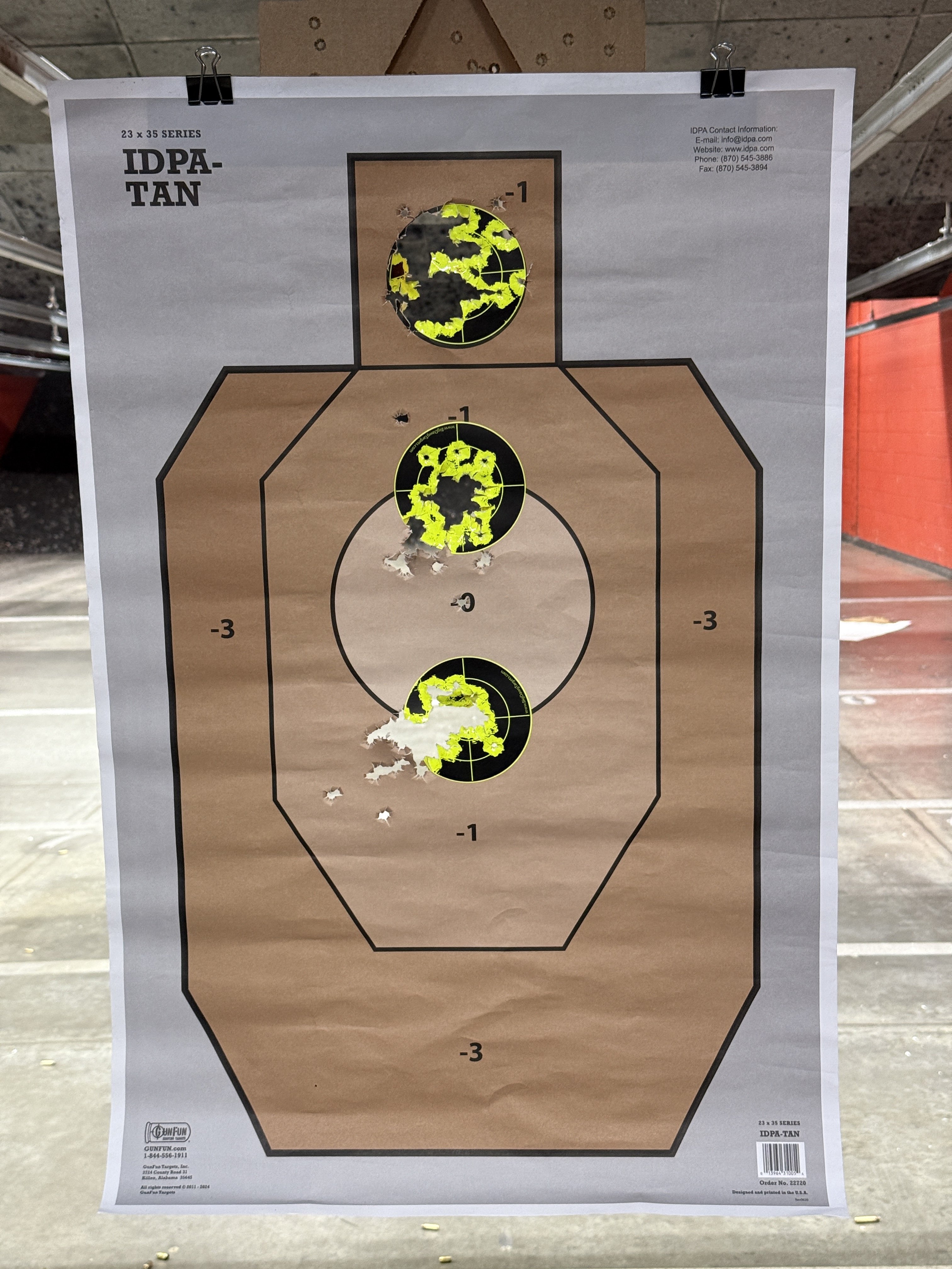

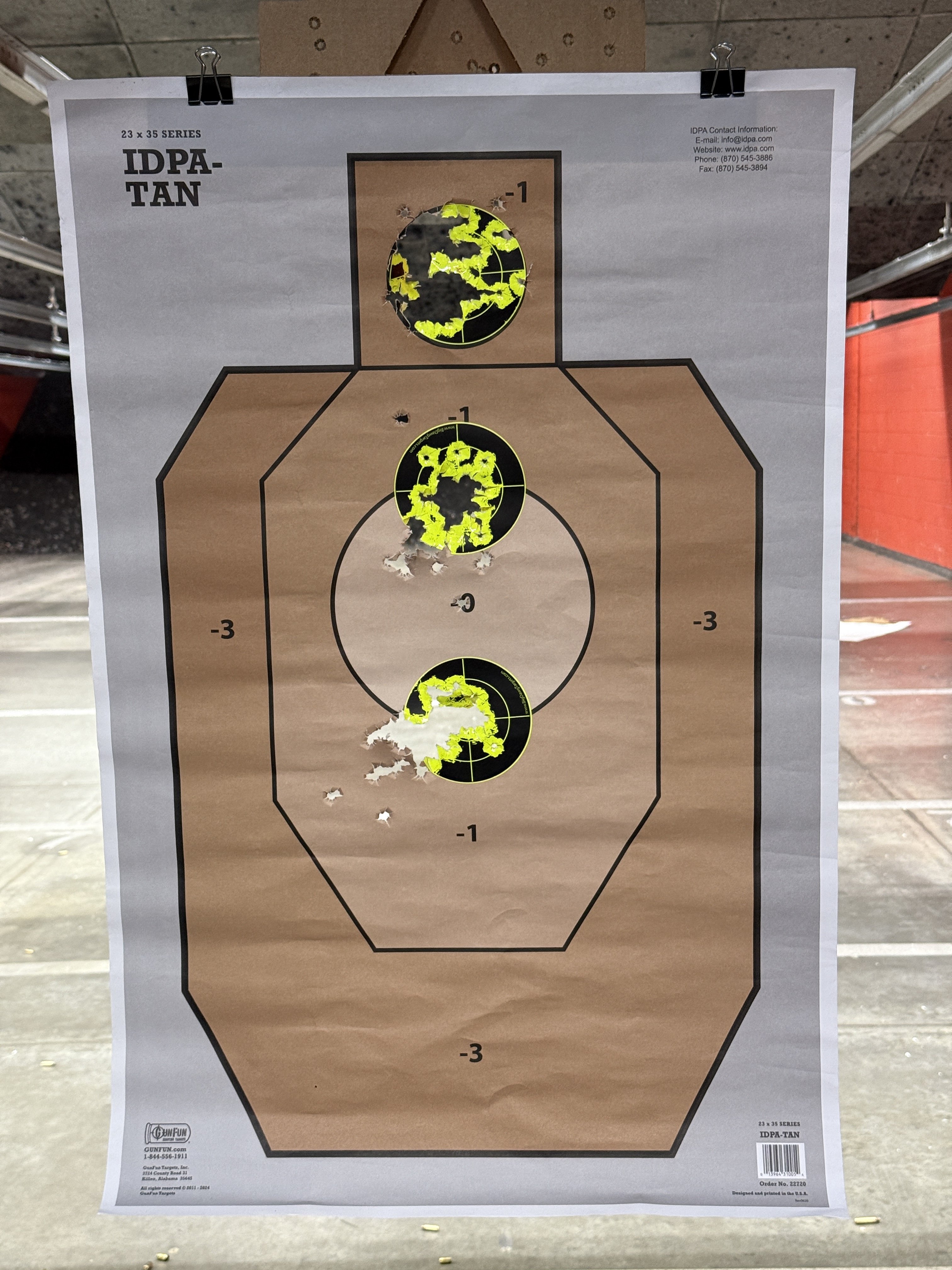

Well right now this new Canik isn't printing anything close to your efforts. Still shoots low and left. Very frustrating!I buy NATO at my local Academy or I order it online. Aa far as POA/POI I haven’t found that to be a problem.

I hate to say it but 95% of the time you find the solution to that in the mirror.Well right now this new Canik isn't printing anything close to your efforts. Still shoots low and left. Very frustrating!
At the ranges we typically shoot the difference in weight of bullets is negligible in terms of accuracy. Shooting low left is common for right hand shooters due to the body mechanics involved. I have seen it hundreds of times in my courses. Try shooting from a rest at 5 yards and see what you get. If you get a tight group off to the right or left a simple sight adjustment may solve the POI. If you are dead on from the rest, look at your grip and trigger management. Adjusting grip and trigger management might clear up your frustration.Well right now this new Canik isn't printing anything close to your efforts. Still shoots low and left. Very frustrating!

The issue with this model Canik it has fixed sights.At the ranges we typically shoot the difference in weight of bullets is negligible in terms of accuracy. Shooting low left is common for right hand shooters due to the body mechanics involved. I have seen it hundreds of times in my courses. Try shooting from a rest at 5 yards and see what you get. If you get a tight group off to the right or left a simple sight adjustment may solve the POI. If you are dead on from the rest, look at your grip and trigger management. Adjusting grip and trigger management might clear up your frustration.
You can still tap the rear sight one way or the other to adjust for windage.The issue with this model Canik it has fixed sights.
If you don't have a sight pusher, I suggest you get a brass punch and hammer to adjust the rear sight. It should drift right or left in the dovetail. If there is a set screw loosen it. Drift the sight in the direction you want the POI to go in very small increments. Don't mess with the front sight. Don't do any of that until you have shot a few groups from a bench rest to rule out shooter induced deflection.The issue with this model Canik it has fixed sights.
Shooting low and left is you the shooter not the gun. You are jerking the trigger. Look into shooting low and left on internet.Well right now this new Canik isn't printing anything close to your efforts. Still shoots low and left. Very frustrating!
