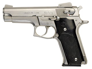

Hans, I'm not personally familiar with the 1076 so I did just a quick search to see what I could find about it. Not many specifics that I found, but one thing caught my eye...... From a visual comparison it appears the 1076 is about the same size as my 659. Can you verify that... or not? In fact, about the only difference I could tell for certain is the safety/decocker on the 1076 is frame mounted right under and behind the slide lock whereas on the 659 it's still on the slide/both sides.
But the visuals sure do look a lot alike. Same apparent frame, same physical size, very similar grips. 'Course my 659 is 9mm and a double stack rather than the 10mm single of the 1076.
Lgth 7.44"
BBL 4"
Wgt 39.5oz

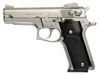

Lgth 7.44"
BBL 4"
Wgt 39.5oz

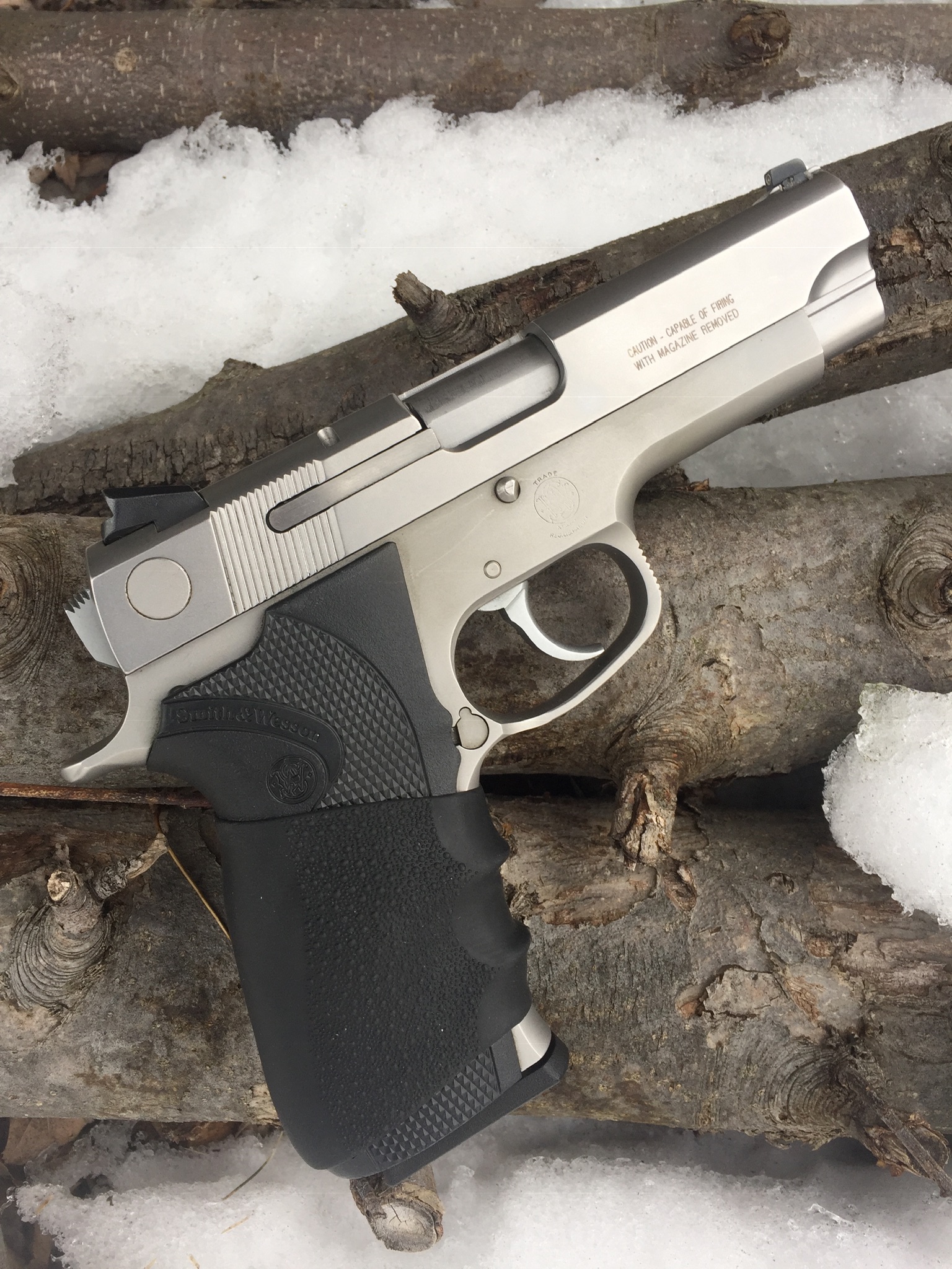

It's a bit bigger; built on the .45 (645/4506) frame instead of the 9mm frame; single-stack, with no safety/decock on the slide. The decocker is Sig P-series style, just ahead of the left-side grip.
This is mine.
