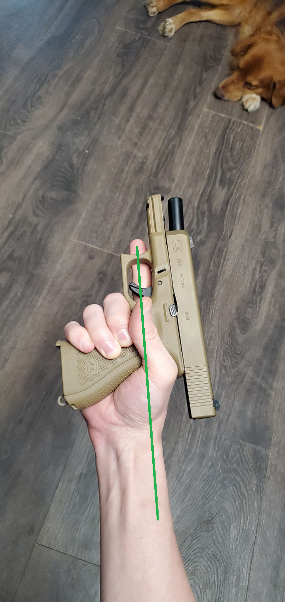

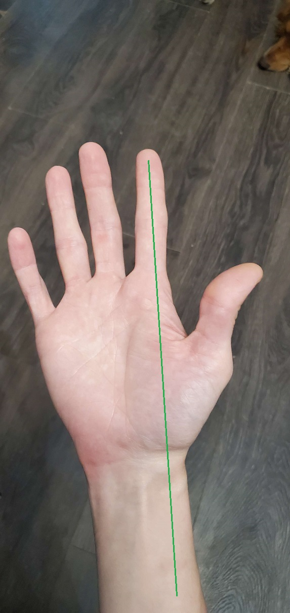

Ever wonder why Gaston Glock went with a 22 degree grip angle for his Glock pistols? Answer: Bad Trigger Alignment. It's the reason people are having their Glock grips modified to reproduce an 18 degree grip angle. Browning had it right with the 18 degree grip angle, the natural angle of a pointing hand. Glocks drive to produce a lower bore axis, a good thing for recoil control, is the culprit. Switching to a striker fired system eliminated the need for the space a hammer would occupy in the frame. This in turn, allowed the grip backstrap to curve much higher facilitating the shooter's high grip. But the trigger stayed low in the Glock creating bad alignment. Sure, adapting and training can compensate for the trigger alignment problem. But why go to that trouble when better trigger alignment can be designed into the handgun in the first place. To get your trigger finger correctly on a Glock, you have to torque your wrist down. This isn't natural.
Your diagram is comically wrong. if you place a glock in your hand such as is demonstrated in the graphic the trigger is directly in line with the index finger. The beaver tail is filled by the meat above your index knuckle and below the thumb. Your diagram is biomechanically incorrect.
As you can see below the index finger stays perfectly aligned with the index and forearm.
