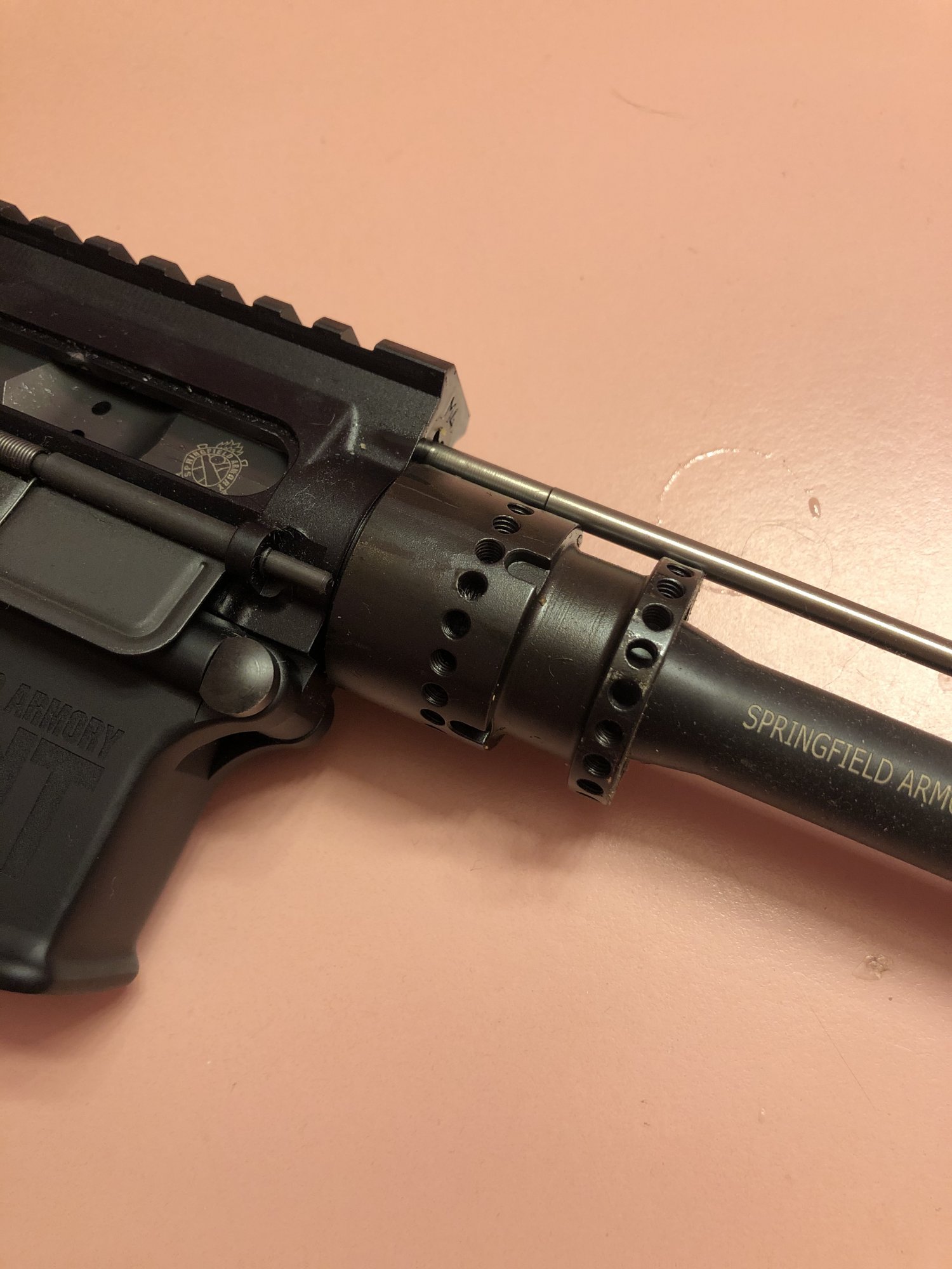

The nut is round with slots for 4 pins. I did call BCM and they said their wrench won't work but I may have talked to a guy who just didn't know. The gun came as a pistol with a brace in 5.56. I had a gunsmith change the barrel to 300 Blk. He has passed away so I don't what wrench he used. I am now going to convert it to a 16" barrel 5.56 to avoid the brace hassle. Actually a 14.5 barrel with an integral 1.5" brake from Faxon. I'm not far from BCM so I think I'll just drive over there. Thanks to all.

trouble with strap wrench is that it will slip, SA tightens the barrel nuts to the top edge of torque. They Do not use locktight, but people swear they do. Then on reassembly it will be harder to time the nut with the handguard With a strap wrench.
They both have the slots, but the difference is that Springfield locks the handguard via screws that go around the nut.
