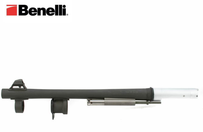

-That neutered magazine tube. There are plenty available from many sources and materials, but I hate the idea of it because there is no reason they can’t install a real mag tube in MD or TN before they send them out.

I have a lot of shotguns. Probably 6 of them are SD shotguns ( 500, TS-12, KSG25, etc.), but I still want an M4. Model 11714 to be exact. I think if I was you I would look at getting the adaptor and putting an SGA stock on it or the skeletonized 6 position deal. And definitely get a mag extension.
