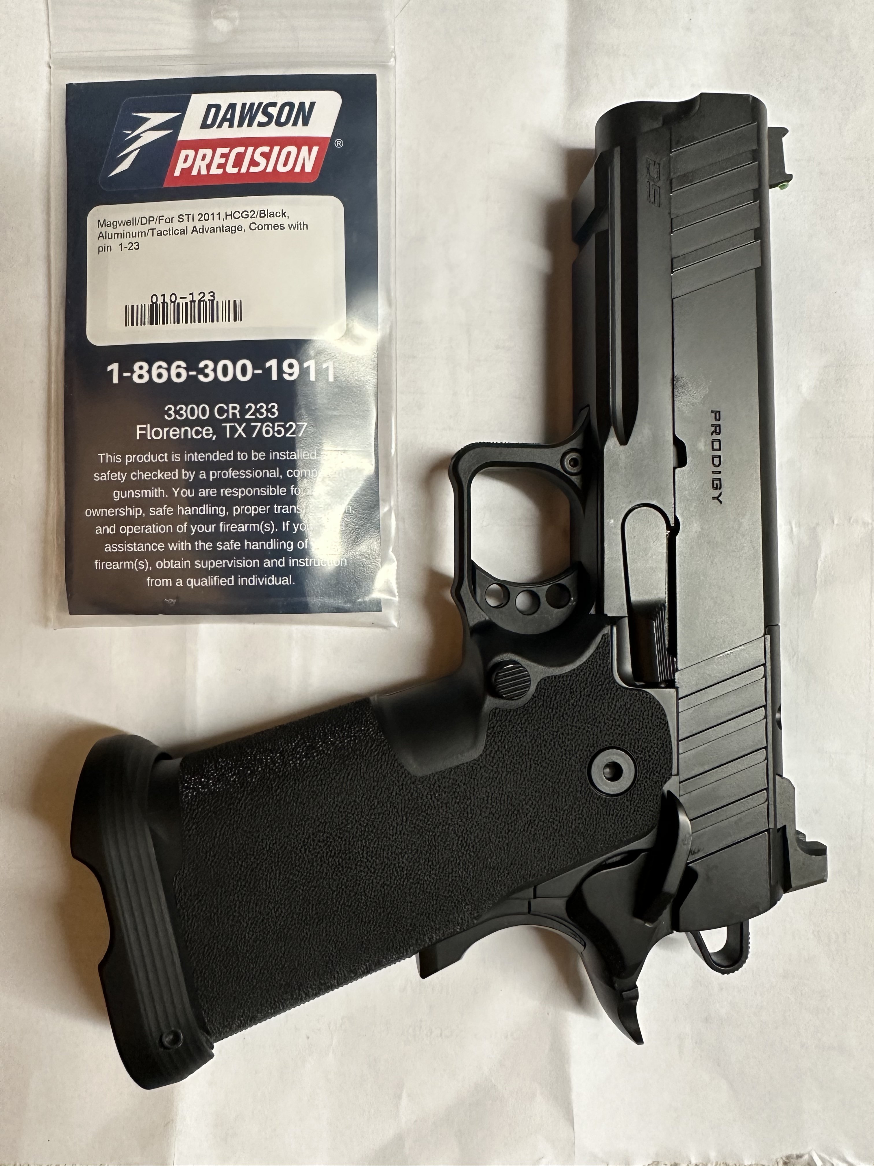

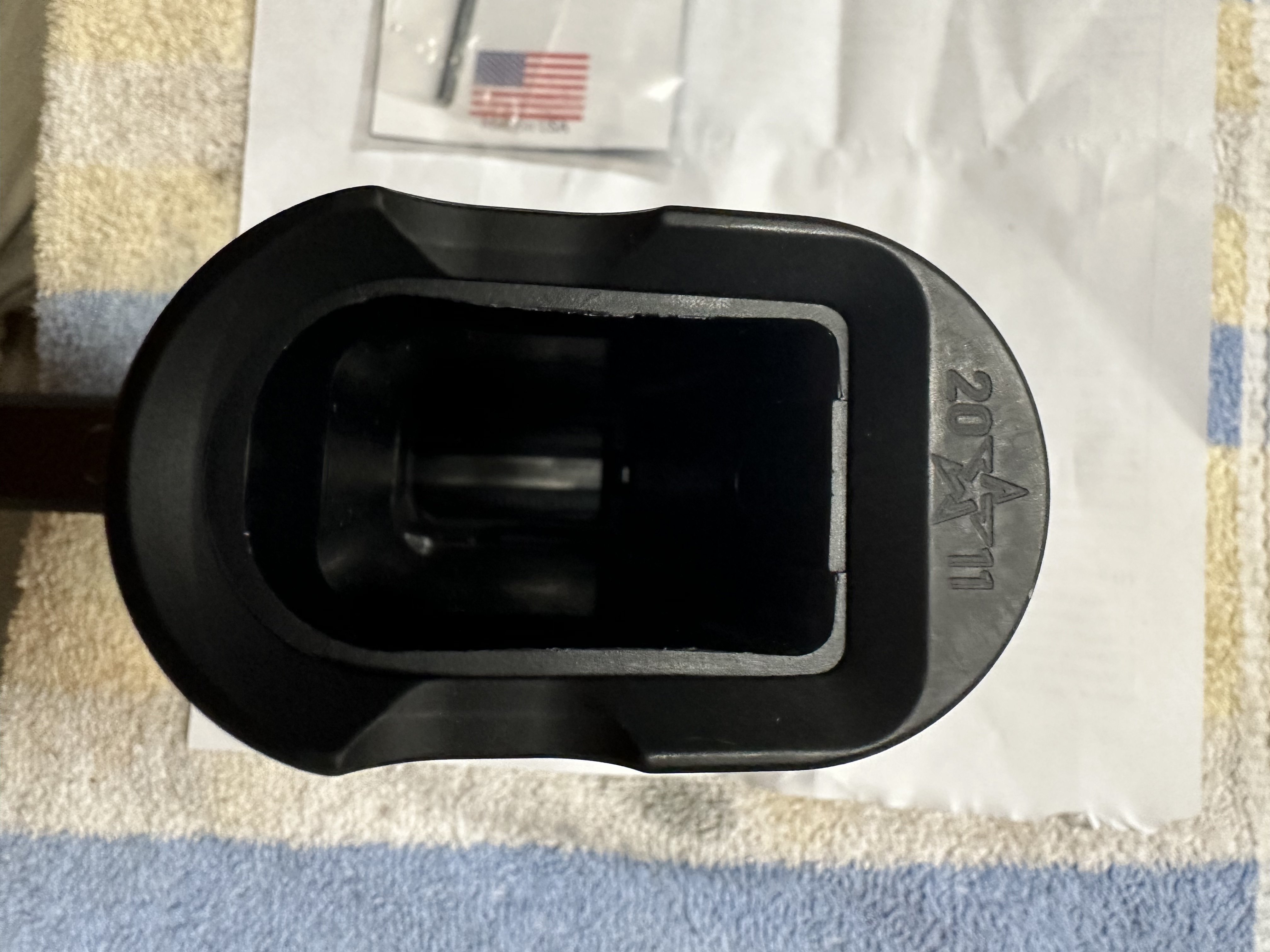

That's helpful, particularly the 2nd pic. Because the two don't mate perfectly, I'd imagine the bottom of the frame is going to get chewed over time, but I'll be curious to see what your mileage shows after using it for a bit.

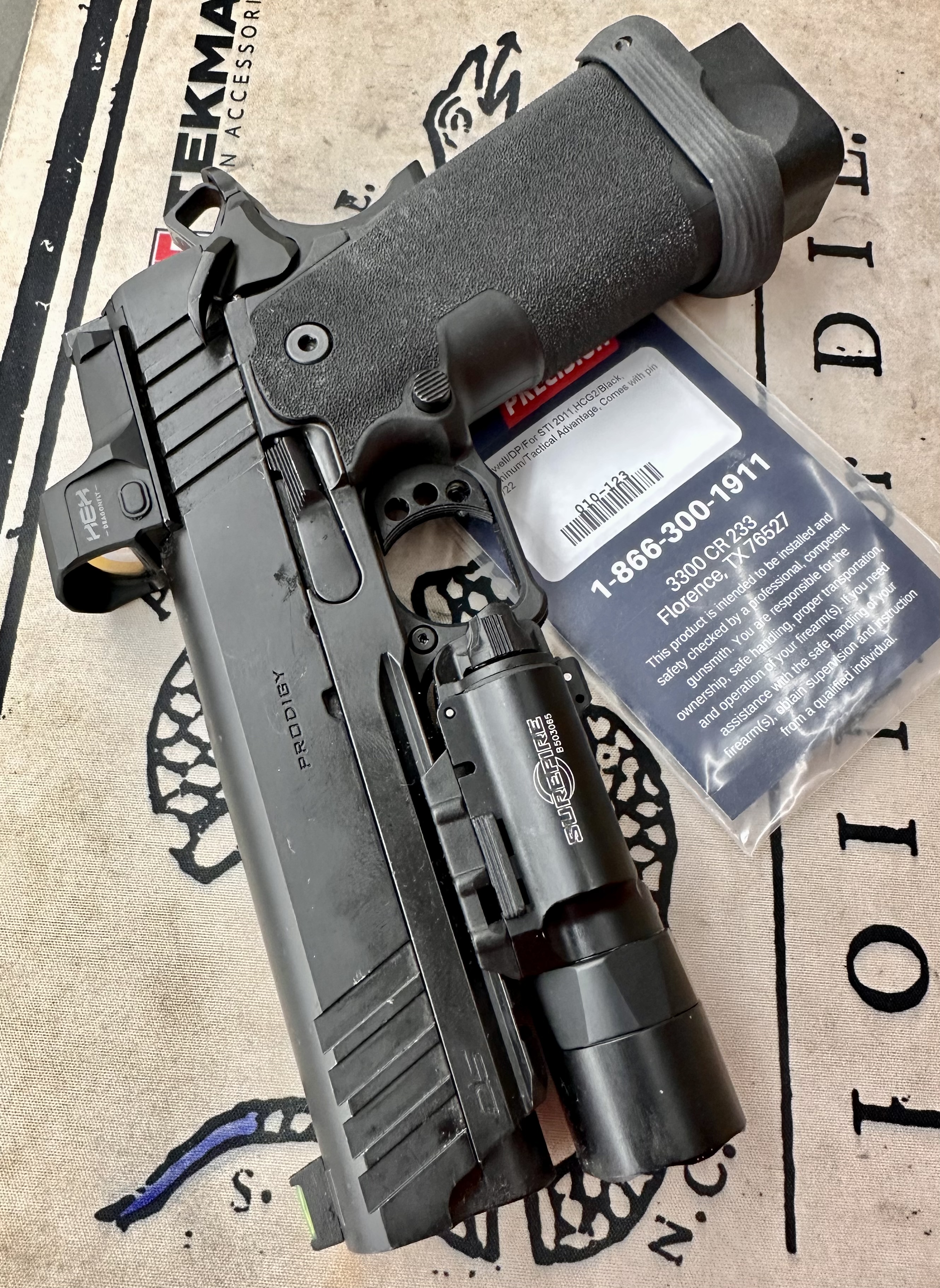

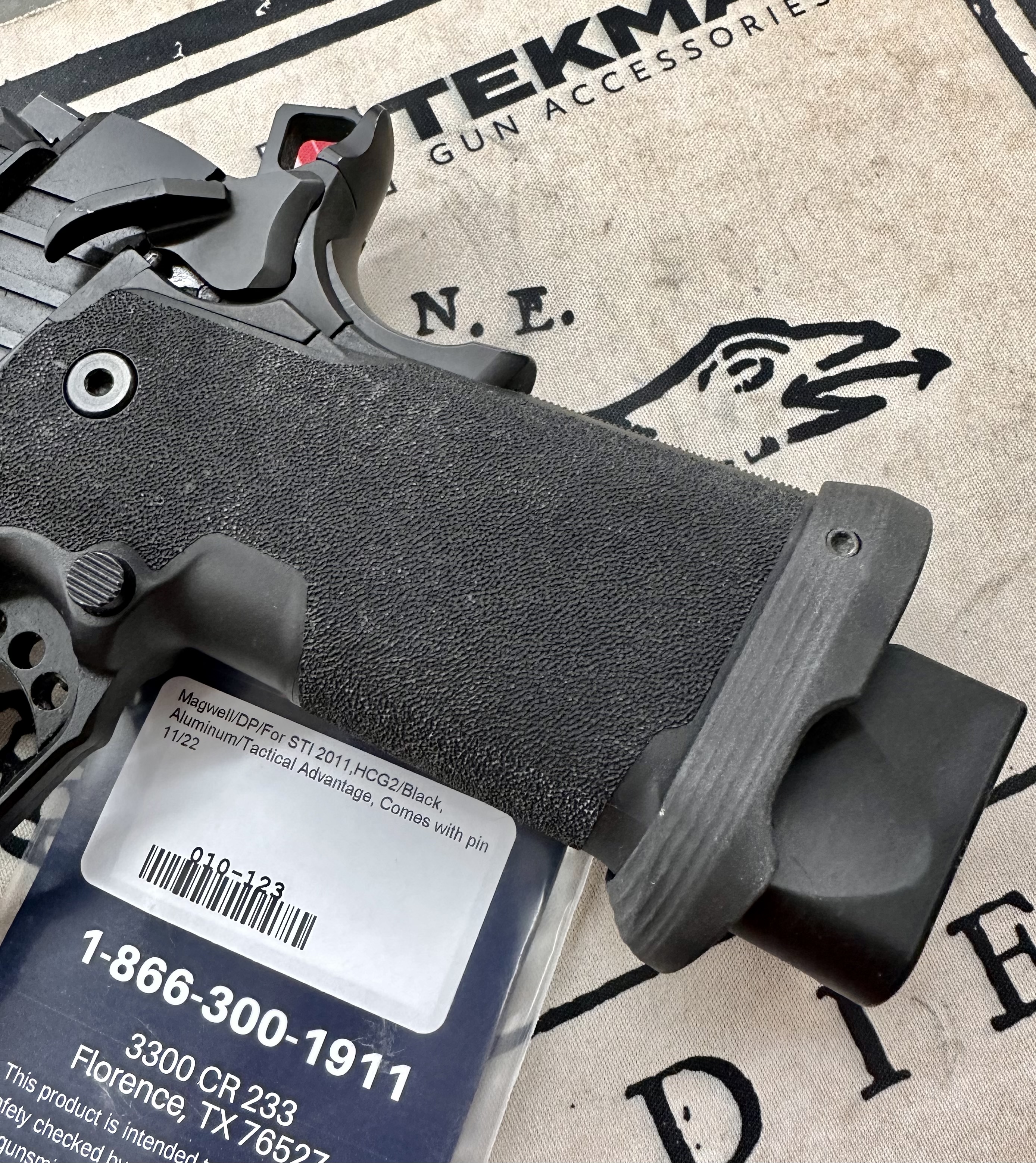

Might as well post a few pictures for interested parties. I love it.

None whatsoever. Just hook the front of the magwell on the grip and push it up in the back while trying to align it to the rear of the grip. It will be tight.
You can try to use your hand to tap it into place, but in the end you will probably need a few taps with a rubber mallet to push it on. Like I said it is tight, but it isn't necessary to remove any material and the ridges were no problem.
I did use a bit of lube on the parts to help in putting the magwell on.
Quick question ... Do you mind saying what kind of lube you used? I wasn't sure if it mattered but thought some kinds might cause damage to the polymer.
I simply used a dab of the gun grease I usually use and applied it to the rear inside edges of the mag well and to the grip where they contact. I don't know if it really made a difference, but I thought that it might reduce friction and help the two parts go together easier.
Any type of gun lube will work, either oil or a light grease. You will use the same type of lubes when you clean and maintain your pistol so they should not harm the polymer.
