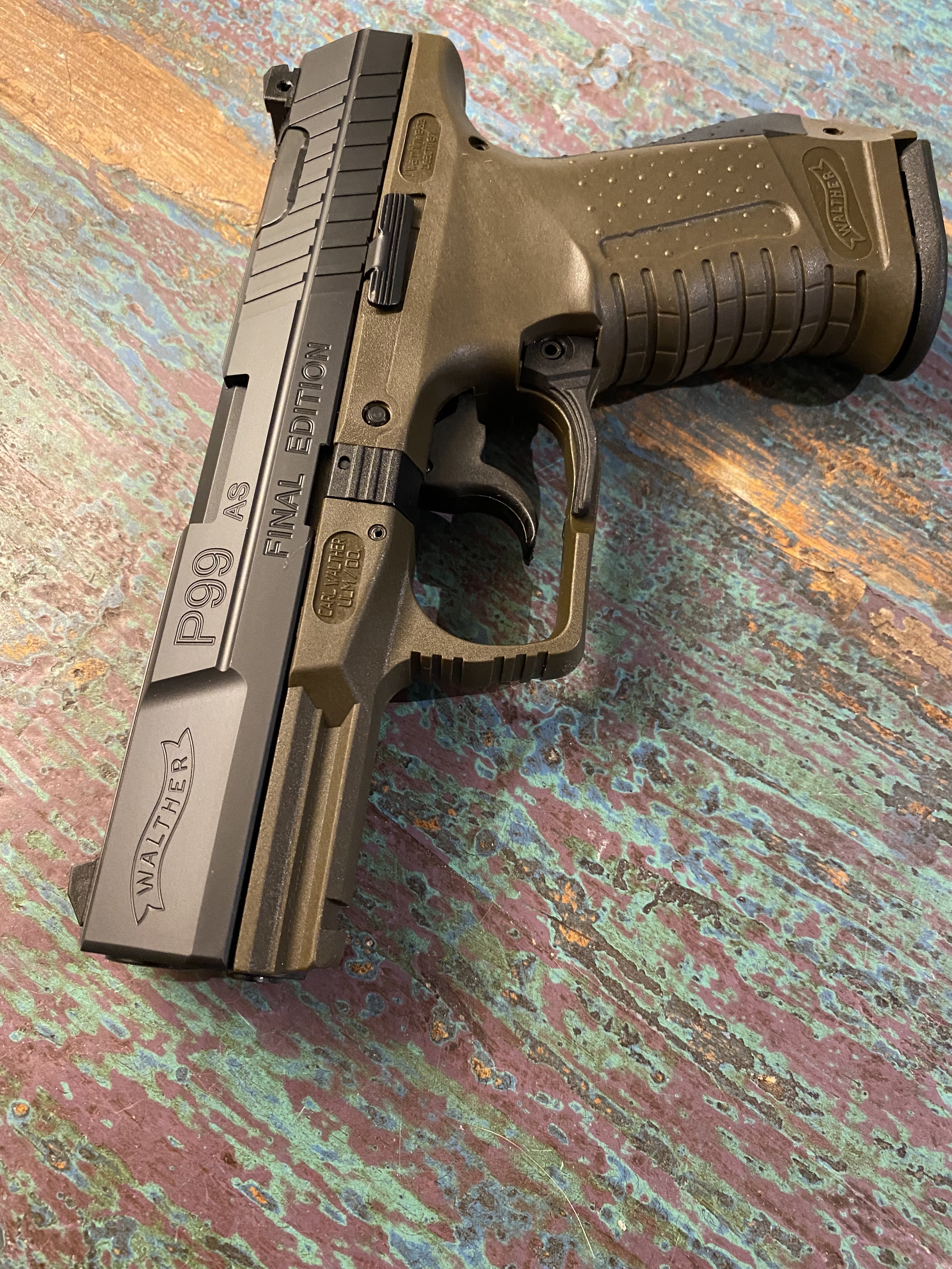

The article forgot the Unicorn: the DA/SA striker fired pistol. I know there aren’t many, but this one is brilliant.
