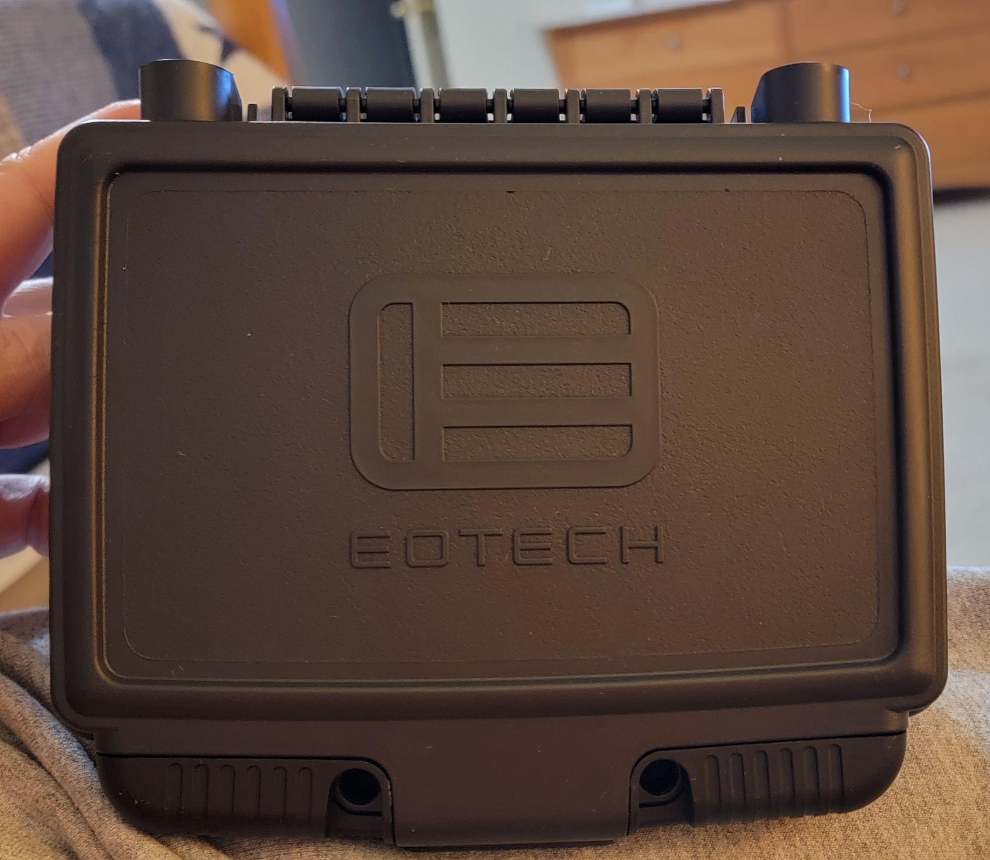

View attachment 33161View attachment 33162

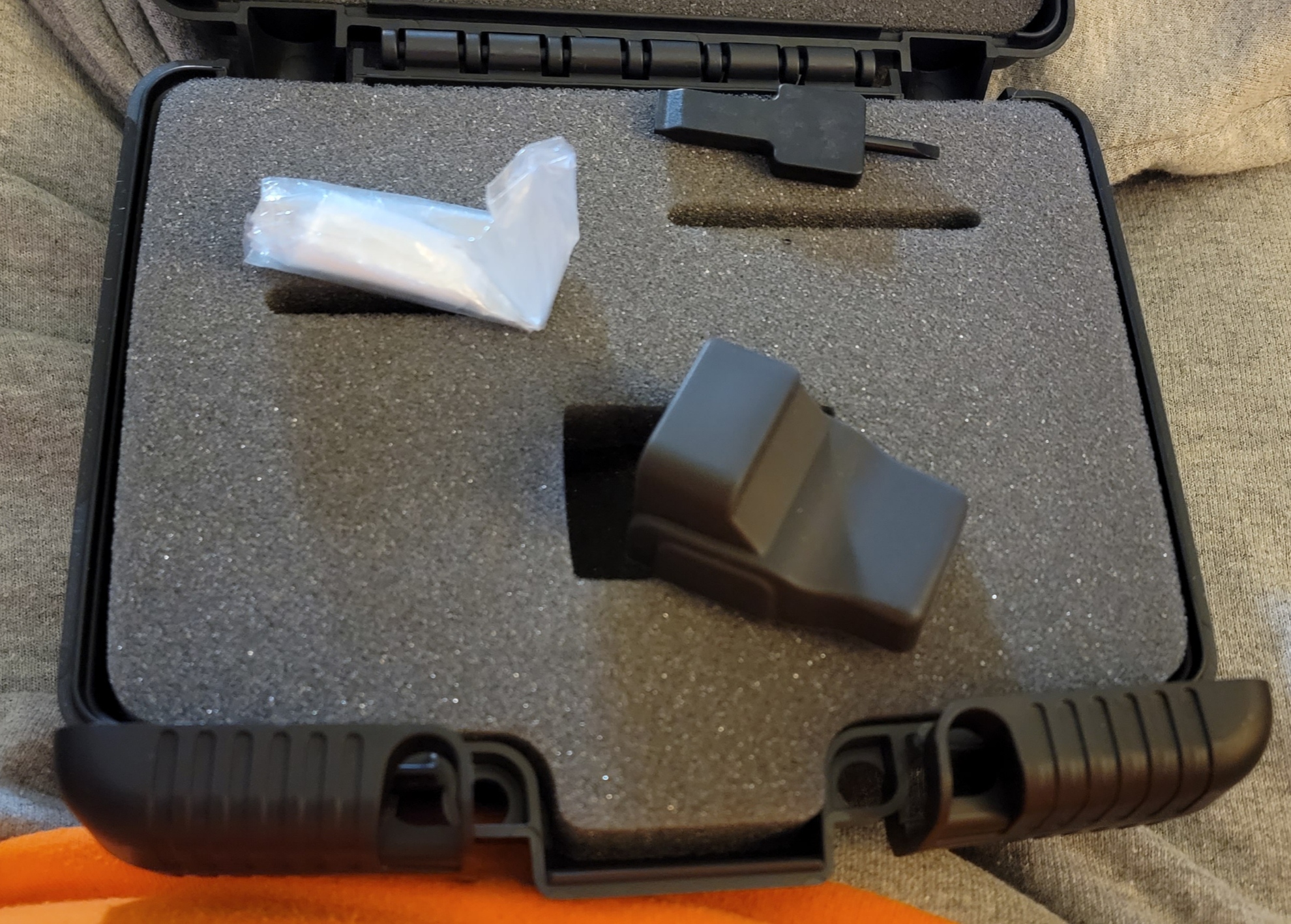

What's in the box?
  • The Red Dot (Battery Installed)
  • A Silicone Protective Cover
  • A special tool to open the battery case and adjust the zero
  • In the bag two mounting Torx screws
  • In the bag a Torx Wrench for the screws
Not in the Photo
  • A Manual
  • A Warranty Card
  • A Registration Card
  • An EOTECH Decal

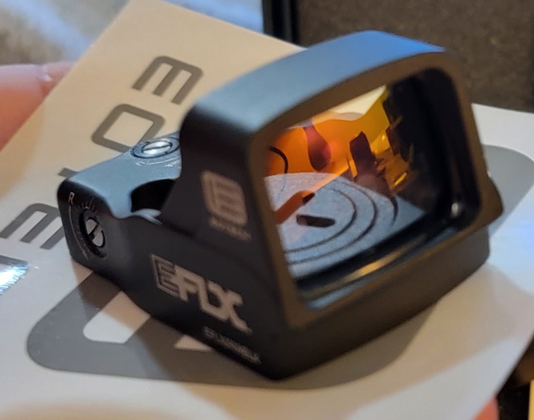

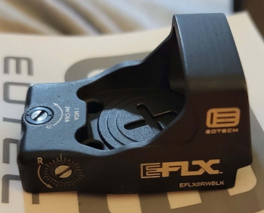

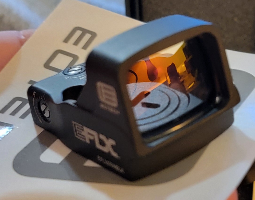

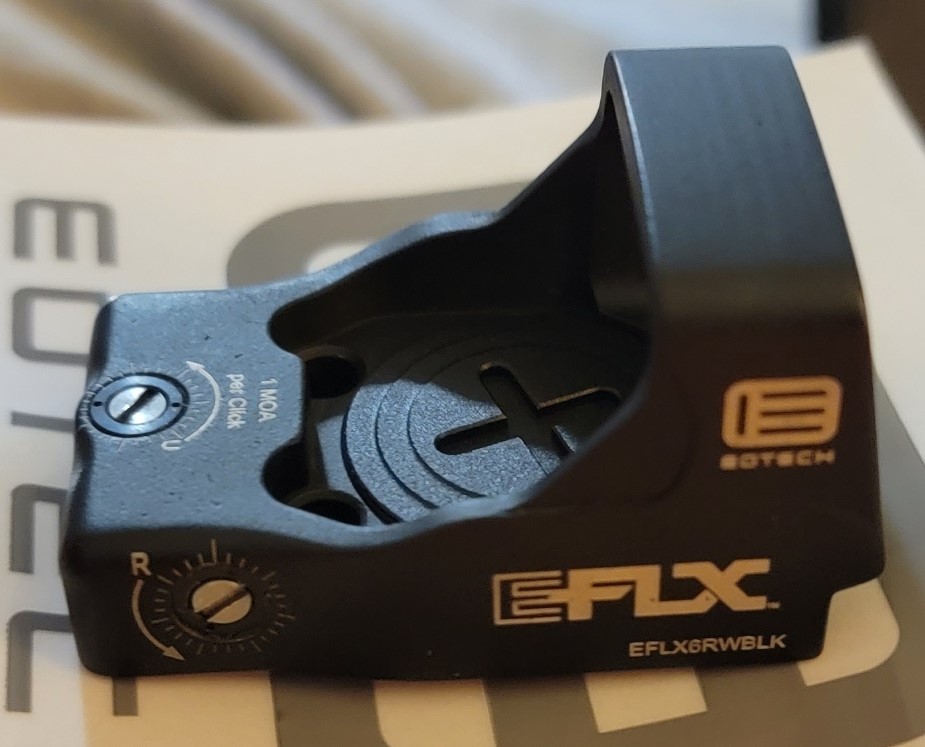

The Sight itself
View attachment 33165View attachment 33166
The screws are the exact correct length to fit the XD-M Optics Mount Plate and not extend past the plate....
The Vortex and some Trijicon (usually the screws that come with the mount plate, not the sight itself) are too long and require filing or cutting down...
It has a top load battery, 25k to 20k battery life (lower for the bigger 6 MOA dot), and a feature to switch to always on until turned off or set an auto 12 hr shut off...

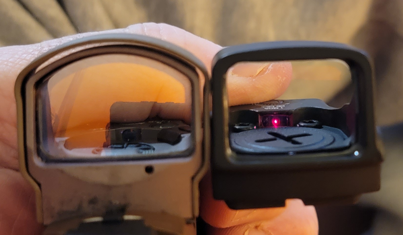

I measure it at .72" tall and .94" wide, to put it within 1/100" surface area of the Deltapoint Pro, it is more square than the DPP. The DPP being .68" tall and 1.01" wide.

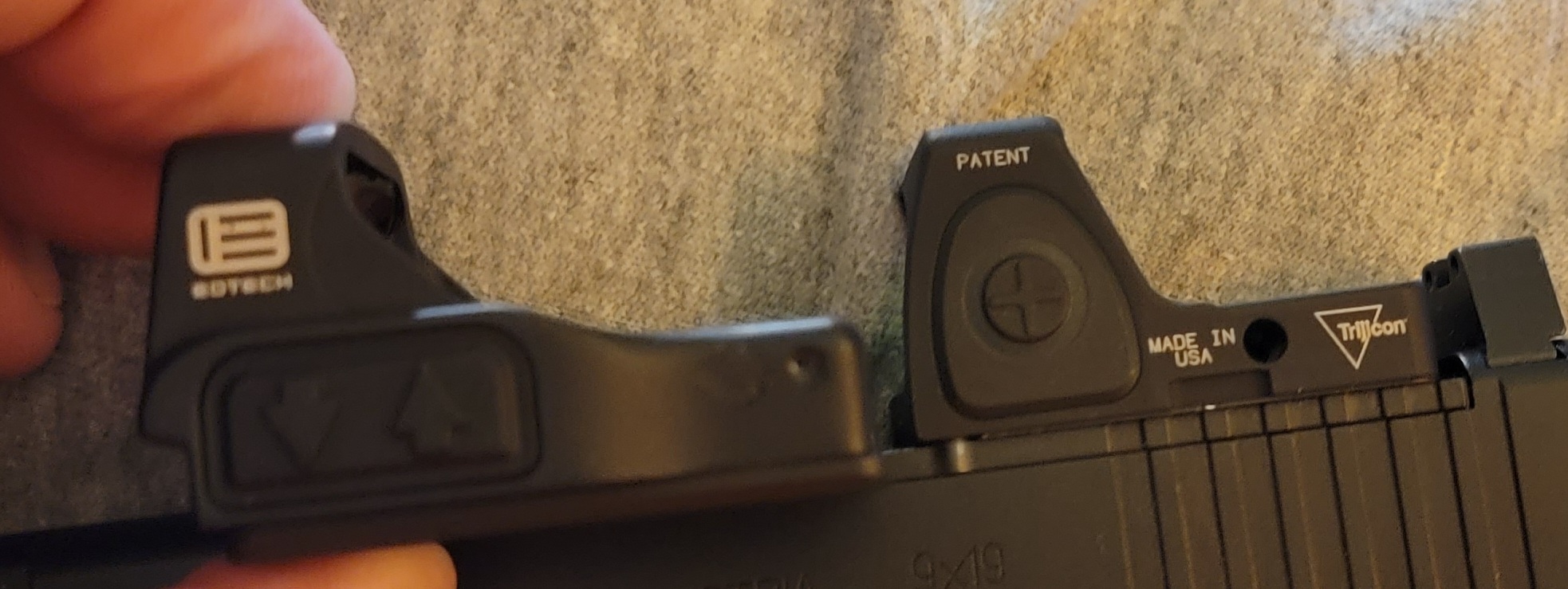

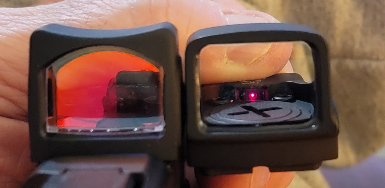

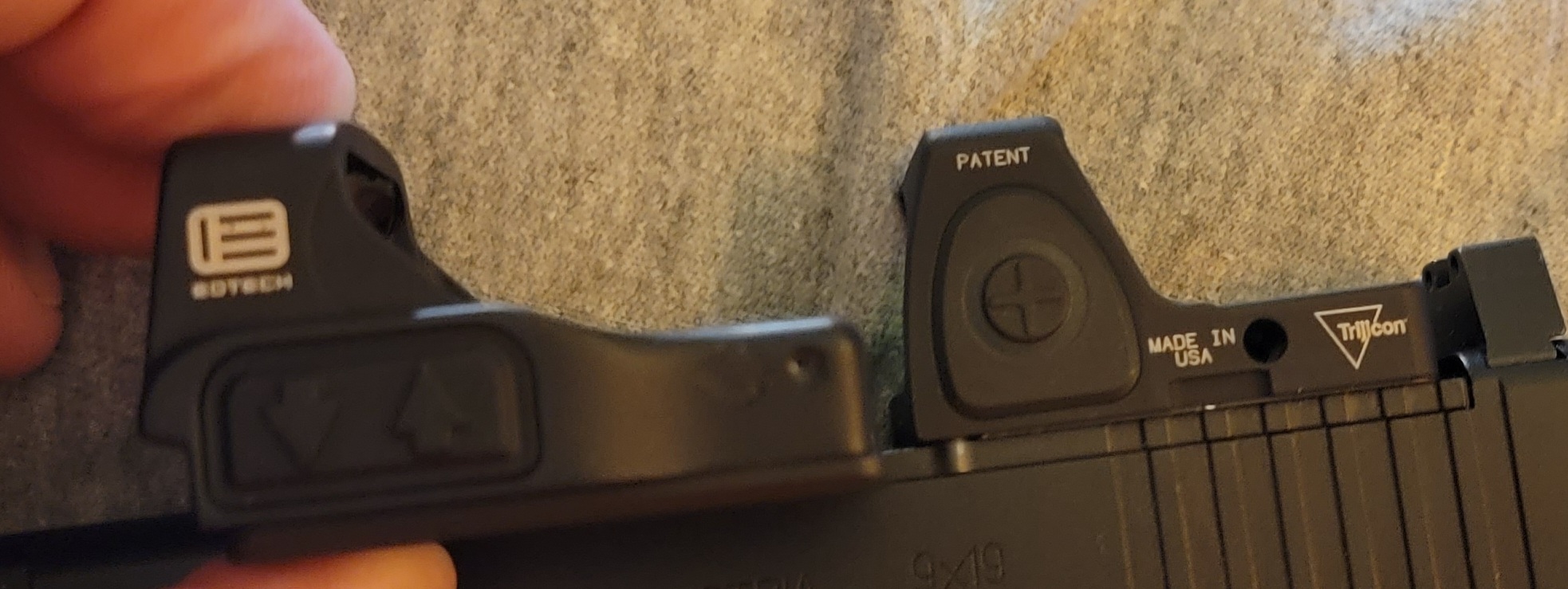

Compared to a Trijicon RMR
External Dimensions, its the same length and .1" taller and wider than the RMR
But notice, the base of the EFLX is taller than the RMR, more on that later...
The EFLX measures and looks bigger and more square as well...

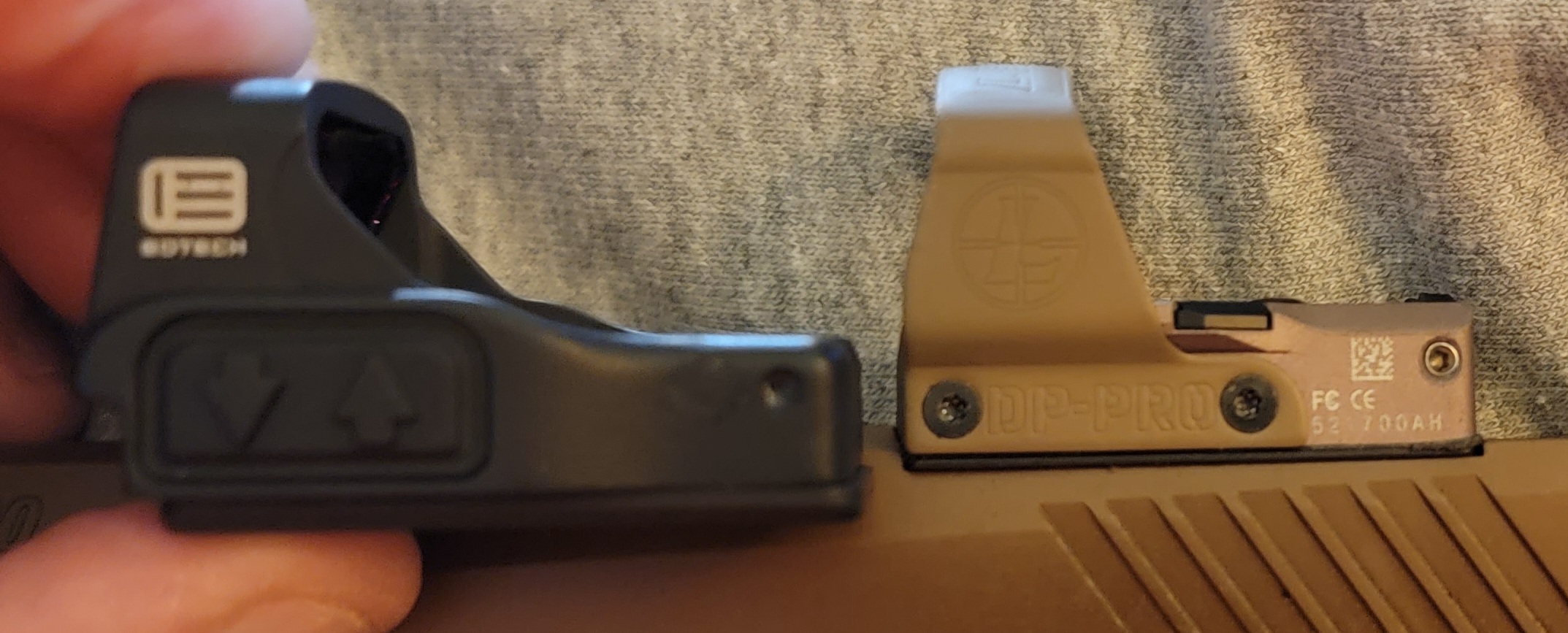

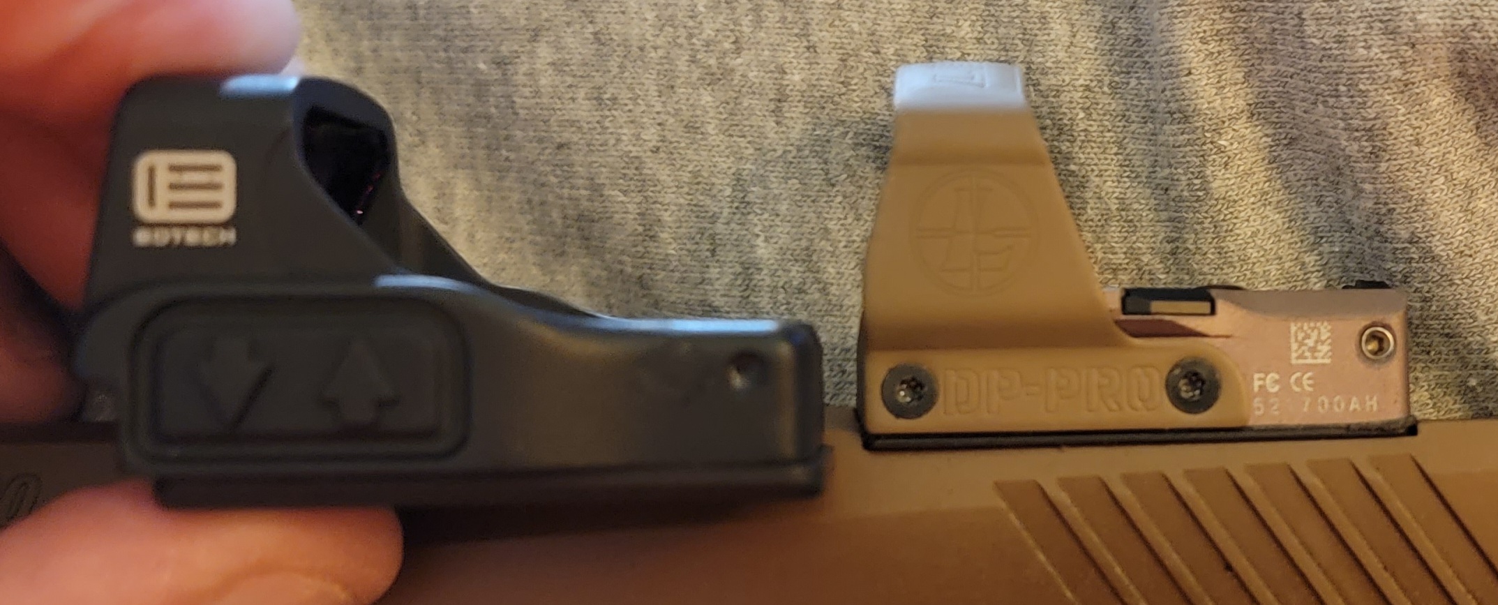

Compared to a Leupold Deltapoint Pro
External Dimensions, its .3" shorter and .1" taller and .1" narrower than the DPP, so pretty much the same size window in a smaller package...
The Base of EFLX is slightly shorter than the DPP, which is notorious for being too tall for even suppressor height sights to co-witness...
Windows about the same size (by height x width, the EFLX is .01 sq in smaller) but the squarer EFLX window looks better to me...
