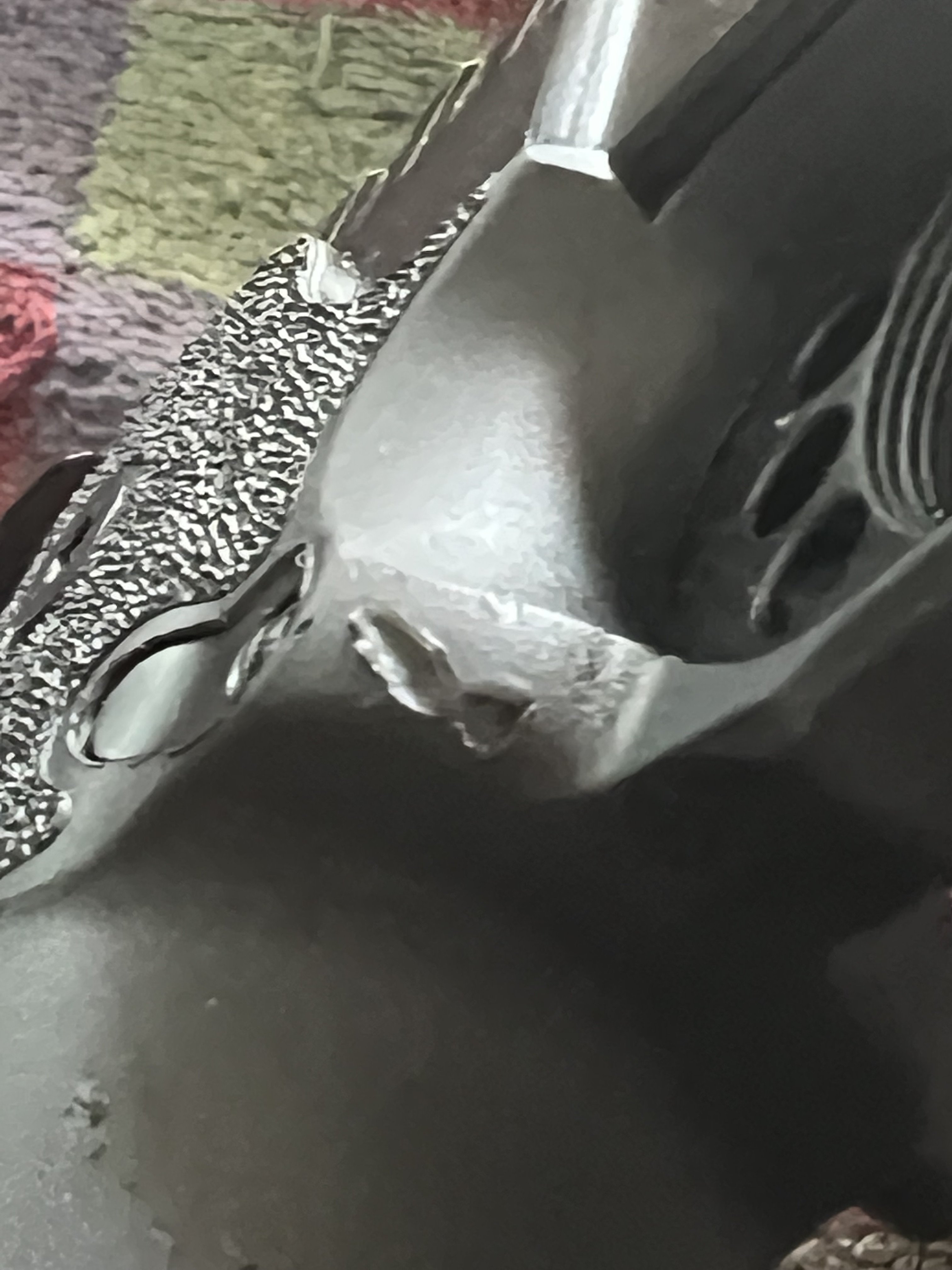

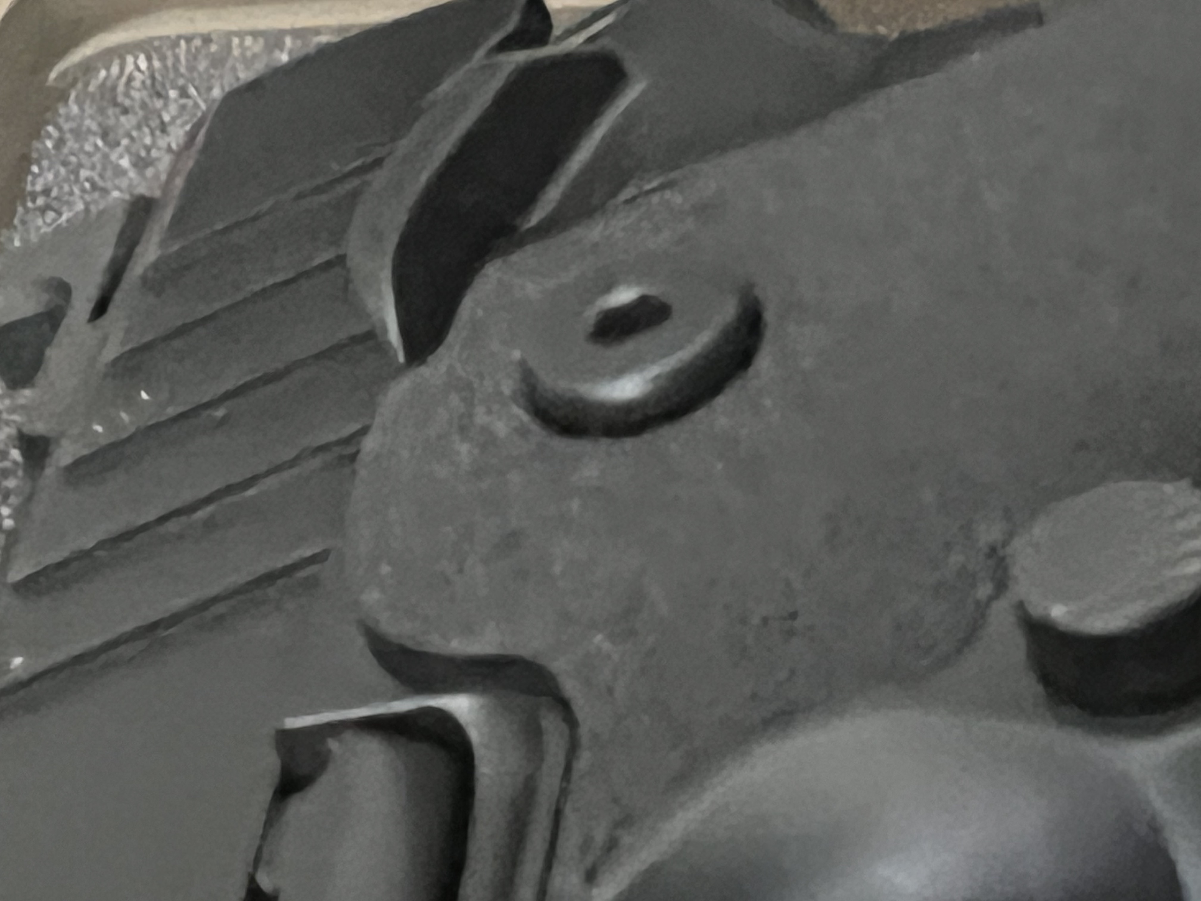

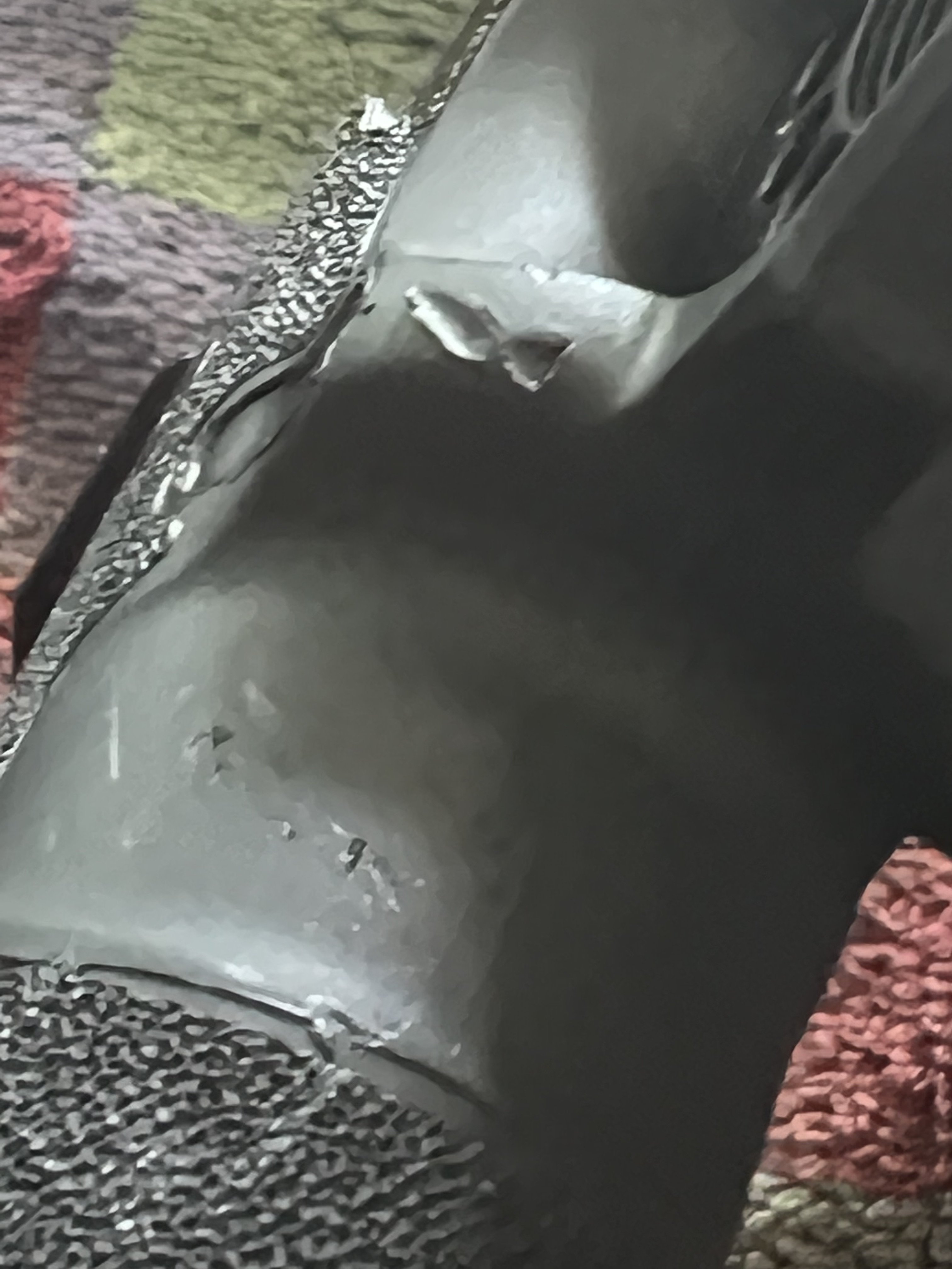

Im curious if any of these damage marks and the screw could of happened during shipping? Me, being a logical thinker would have to think no one in their right mind would let it leave the repair shop like this. Any sane person like yourself would do what you did and send it right back. That just makes the repair workers MORE work and cost them more money. Its a lose all around.Well, I received both my Prodigy's (4.25 & 5") back from Springfield today. Let's just say I am extremely disappointed. I opened the box for the 5" and found: Rear Sight Plate loose, Both Grip Module screws loose, Slide still getting stuck on the disconnector (original problem along with the FTF issues, two new magazines and the grip module damaged around the right side mag release cover and around to the front of the grip module and below the trigger guard. Large gouges like were it had been in a vise or something. Totally not acceptable as there was no damage to the gun when I sent it to them.
The 4.25" found both grip module screws loose to the point, the left one basically had 1 thread holding it is and fell out with a touch. Had two new magazines as well but could not tell if they actually did anything to it other than fire it as it was dirty when I got it back.
Called Springfield within 15 minutes of receiving them and told them my issues and was taking it to the LGS where I bought them and letting them deal with it.
At the LGS, called Springfield and spoke to a supervisor were they explained to her the issues and condition of the guns when I received them back. I told them I want a new grip module for the 5" since they damaged it and I want the disconnector issue fixed since they did nothing to correct it the first trip in. So she arranged for a FedEx tracking # to be sent to my LGS for them to ship the 5" model back to them to correct/fix everything. She also said it would be a "Priority" repair when they receive it.
I asked he about the quality control as it seems they have none. How could they damage a gun, leave e loose screws and plates and send it back to a customer in that condition. I asked if they even had a quality control to check them after repair as it appears to me they do not.
I kept the 4.25" as it is easy enough to tighten the grip module screws and I want to take it to the range to see if the FTF issues are still there or not.
I would have just fixed the 5" issues and I know how I can get the sticking on the disconnector resolved and would have rather done it myself at this point but the damaged grip module is on them and they need to make it right. View attachment 30808View attachment 30809View attachment 30810View attachment 30811

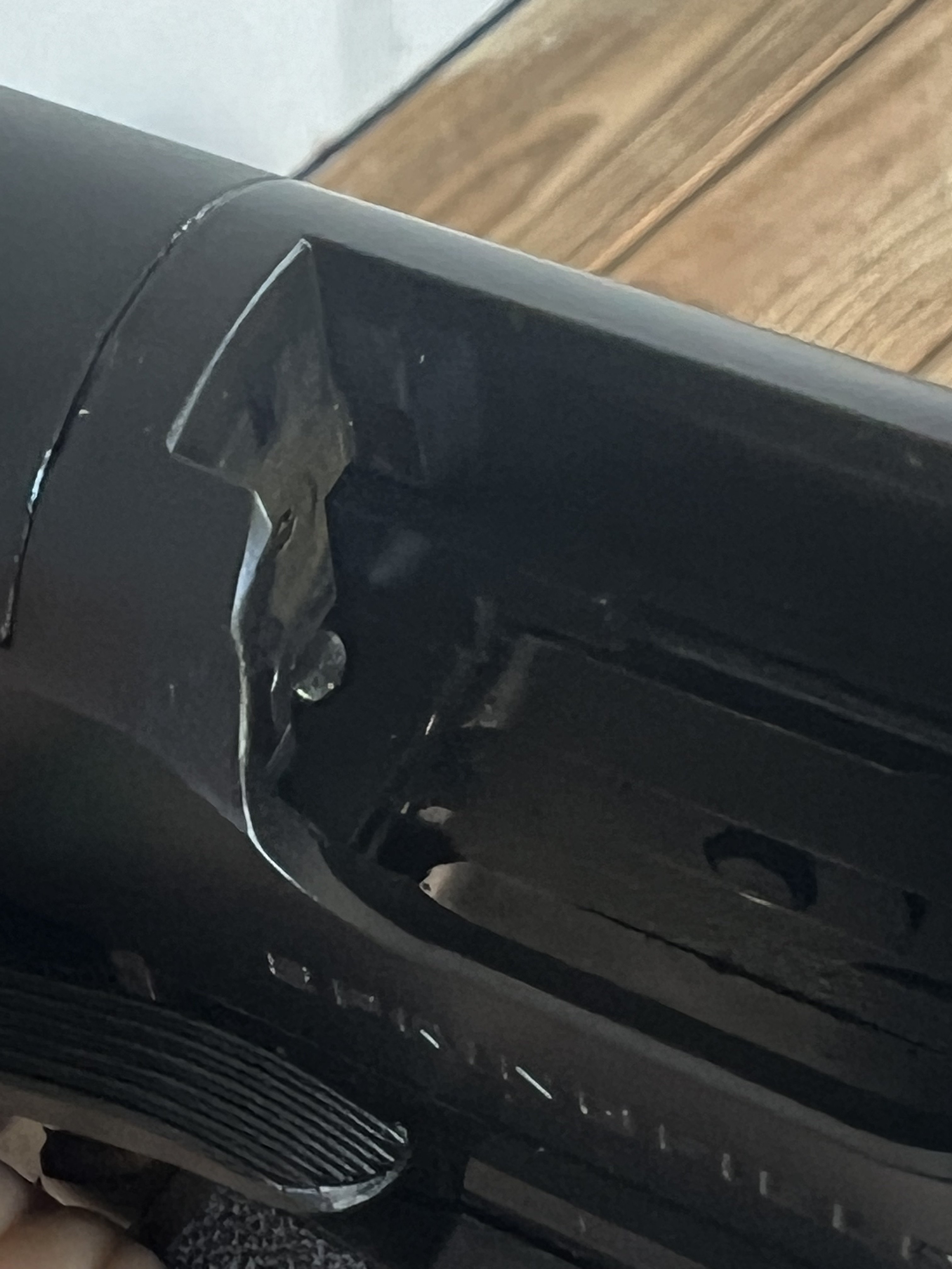

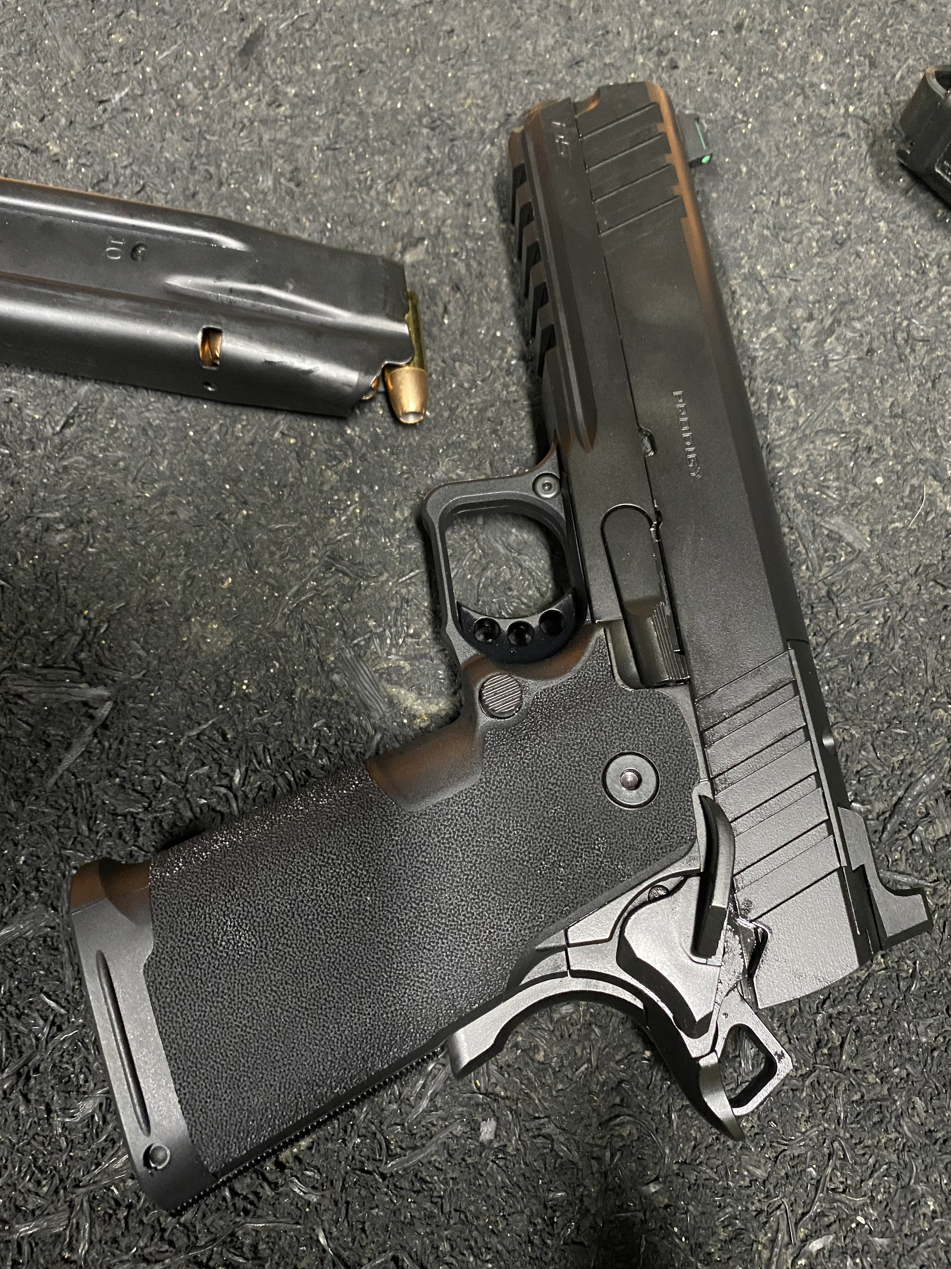

Thanks Simon! I’m obviously a novice but one who wants to master. Your ‘hold the slide and hit the grip’ took me two tries but ejected the live round.Have you tried holding the slide in one hand firmly while you slam the web of your other hand against the grip safety. This is an acceptable way to unjam a 1911. Obviously make sure you keep your finger away from the trigger and the pistol is pointed in a safe direction. This is almost certainly what your gunsmith will do. I had my Prodigy jam twice while I was at the range while trying Sig V Crown hollow points. That is exactly the technique I used to unjam it both times.
Here is one of the jams. Look familiar? You’ll notice that my slide was a couple of millimeters out of battery like yours
