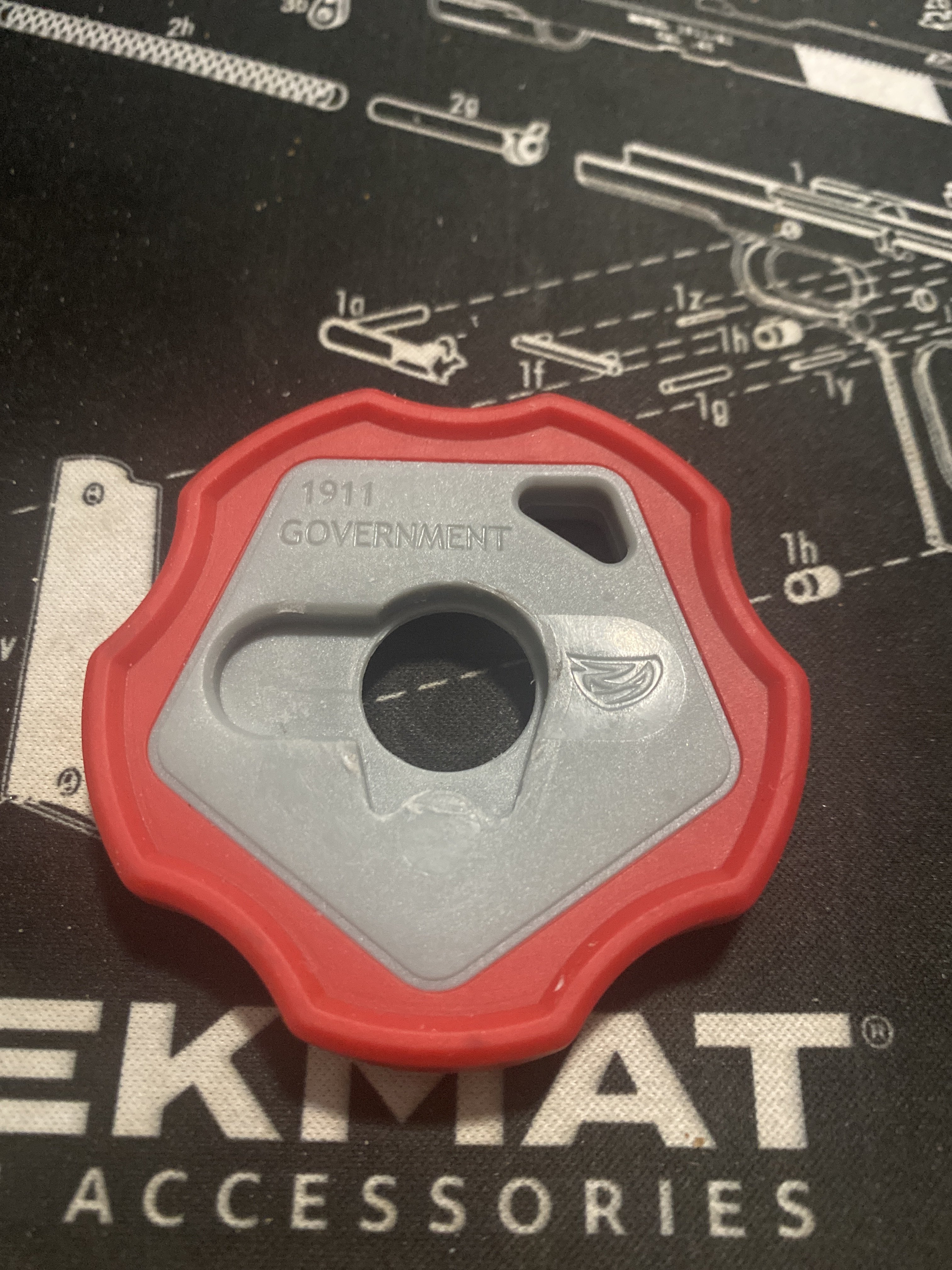

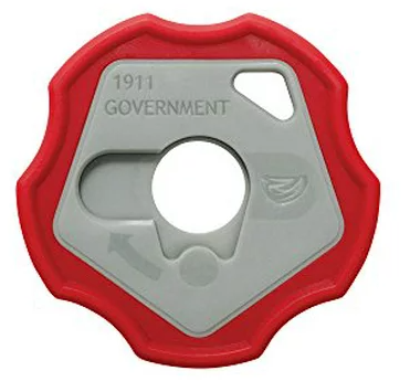

You can use a Takedown Tool to capture the spring plug and spring on the guide rod for disassembly/assembly of your 1911/2011 pistol. Lock the slide to the rear, insert the tool into the hole on the guide rod. That’s it! The guide rod, recoil spring, and spring plug come out as one piece, making disassembly and reassembly easy.
No way it doesn’t work to put on unless someone tells me I doing something wrong. Easy as 123 when taking off
I use that exact tool to lock my full guide rod plug. It's near impossible to push one of those plugs down to seat the bushing with your naked fingers. I am able to push the plug down enough to catch a bushing finger and finish with that tool. That extra 1/8" is murder on your finger or thumb.
