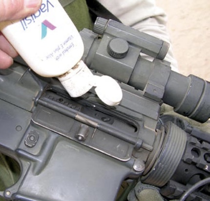

One of the reasons I started this thread is because I was kicking around the idea of putting either some Weapon Shield grease or some Seal 1 on the rails and cam and channel of the carrier and some up near the middle of the bolt. And by putting some grease I mean just a light coat, not slathering it on. I chose those two types of grease only because that's what I have. Frankly I would feel much more comfortable lubing generously with either CLP or better yet LSA. However I can't find any LSA from anyplace I trust and the modern equivalents (Bray 460, etc.) are insanely expensive.

So let's assume it is 4 degrees fahrenheit. Is this light coat of grease or Seal 1 on my BCG going to cause me any problems ?
