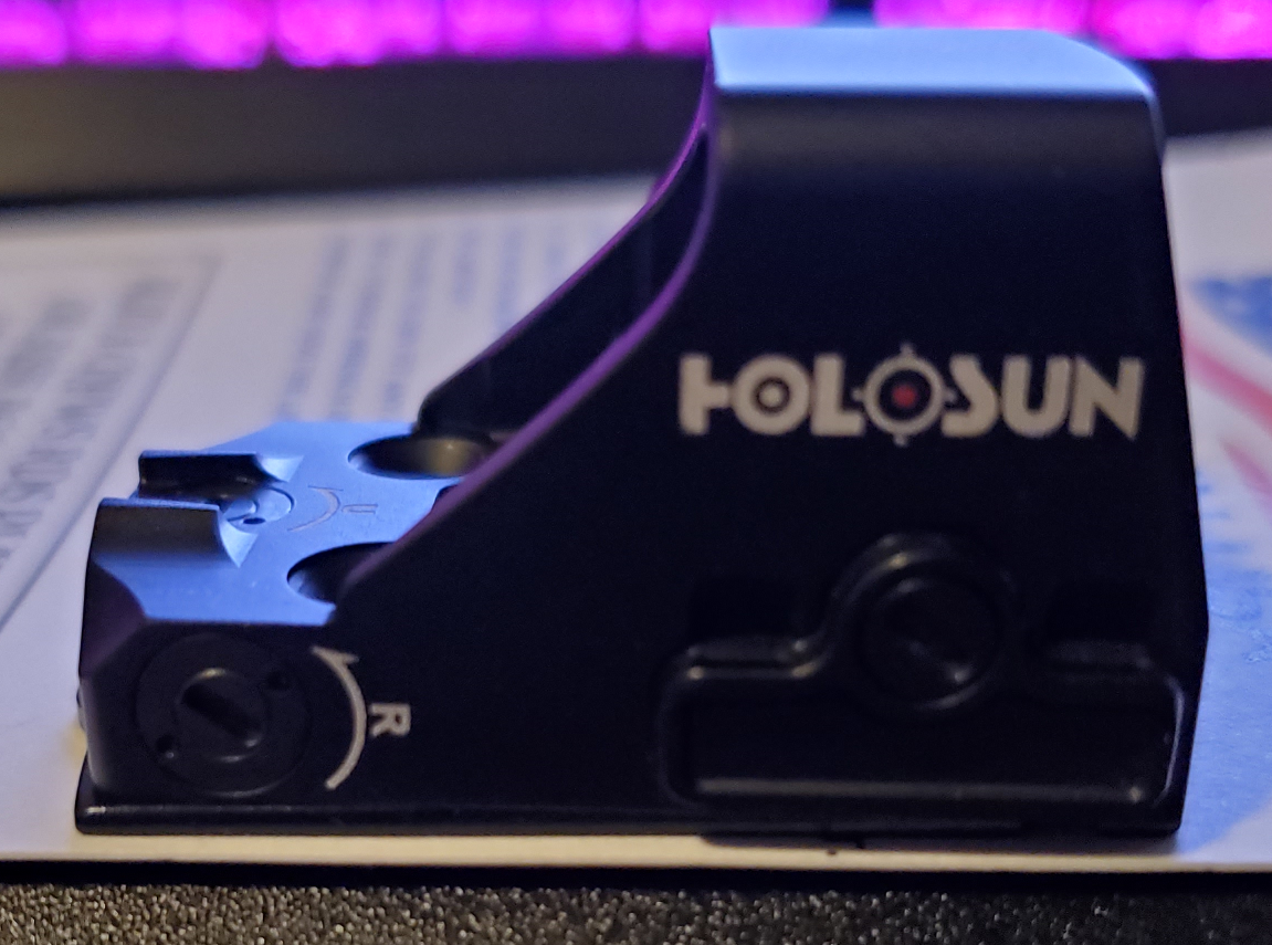

My 507k finally came in, as well as my optic mounting plate. The plate came with instructions to torque everything to 20in/b. The 507k's instruction manual says to torque to 15in/ib. I'm assuming I should go with the optic's recommended torque? Any recommendations from someone who has mounted optics before?

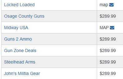

You don't need to back order it's in stock on several websites. I'd cancel that order if possible. All the sites below have it in stock.
It depends on screw size. I would go with the optics recommendation as they know the screw diameter that will fit their optic. I'm not sure why you need an optics plate but almost everyone with more expertise than me recommends against them as they make the optic sit much higher.

I'm not ready to modify my slide just yet and the plate I got is only .045″ thick which really doesn't make the optic sit that much higher. Added a picture for reference, you can barely notice the height the plate adds. Also I should probably have mentioned the adapter plate came with its own set of screws I am supposed to use. It's specifically for the 507k, so should I just go with the plate's recommended torque then since I'll be using the plate's screws?
Personal preference I suspect. I went with grinding index lugs/flush mount because I saw some posts out there that even flush, you only retain about 50% of the iron sights as usable (I can confirm this with mine). If you don't mind the "lowitness" configuration, the plate is an easier way to go.

Had mine tightened to Holosuns specs (15 lbs.). I used the one pair of screws (it comes with two pairs, thinner and thicker - Hellcat takes the thicker ones). Blue Loctite applied as well.
