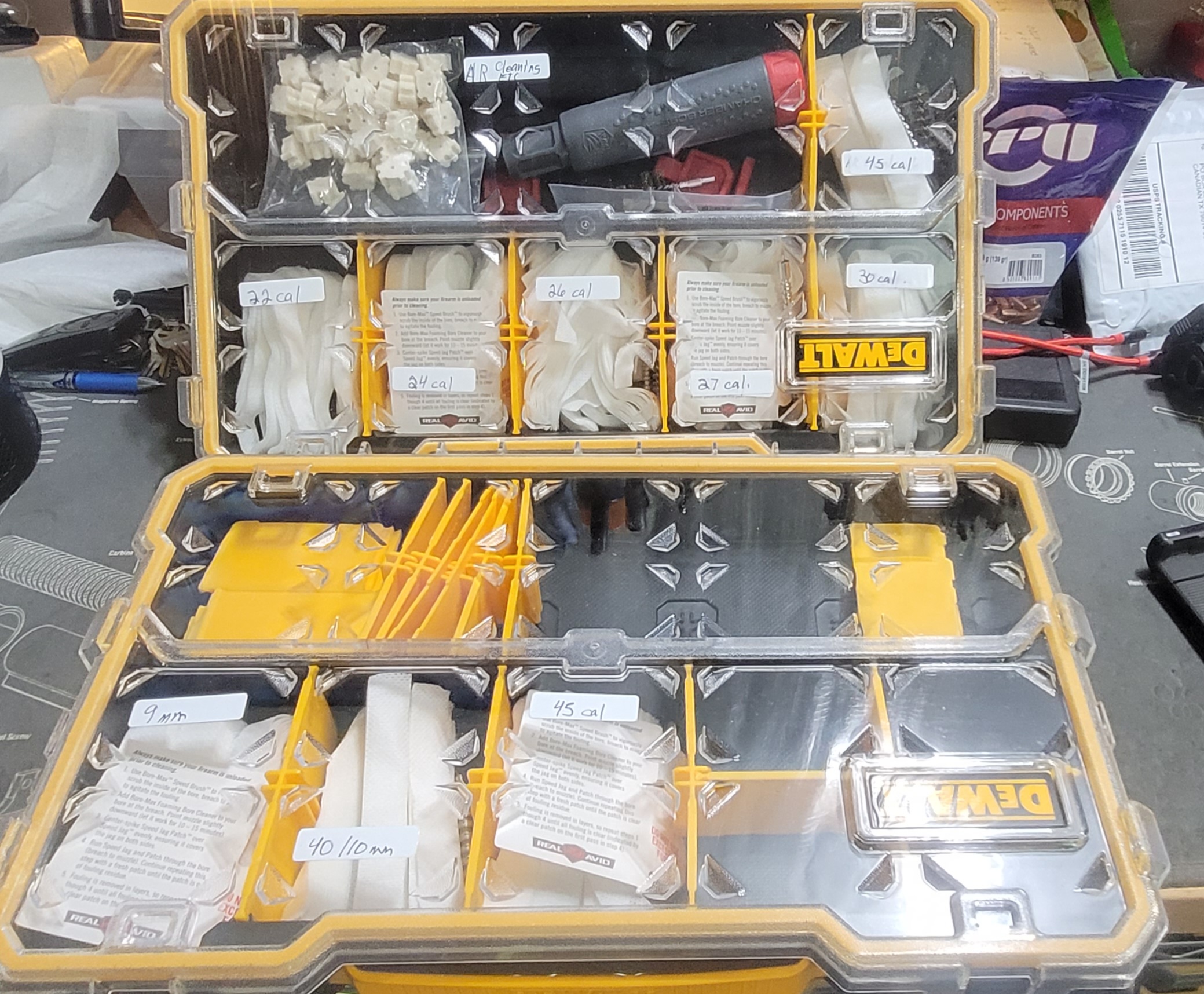

I love them! I still use stainless steel bore brushes sparingly as they do work and are not affected by cleaners. The Real Avid stuff especially the patches are fantastic. No more siting around cutting down patches to fit a particular bore size. They fit so well around the jag that you can get a good back and forth cleaning going.
Over the years I have acquired a serious selection of all kinds of different jags. My last set were hard chromed to combat the leeching of brass from copper remover cleaners. The Real Avid's have now replaced them. The length of the Real Avid's really help get a lot of junk out of the lands and grooves. A good foaming more cleaner and a set of Real Avid gear and cleaning is much quicker than days of past.
I can't be happier.
One other thing I've found to be a huge asset is the Remington bore squeeg-e
Saves on patches. You can get the first bit of crude out rinse and use over. Then get down to business with your patches.
There are actually a few companies that make a squeegee Jag. The remingtons were just the easiest for me to find online at the present.
Here's my real avid collection
