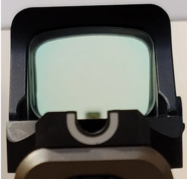

507K. To me what is in the pic is a good usable iron sight setup in a red dot. A little more is actually better, and a little more is what the Wasp gives you. I only want backup irons if the dot fails for any reason. I want them at the bottom (lower co-witness) because absolute co-witness is distracting from using the dot. Everyone is different, but that is the setup I am looking for.What sight is that jimmy? Thanks.

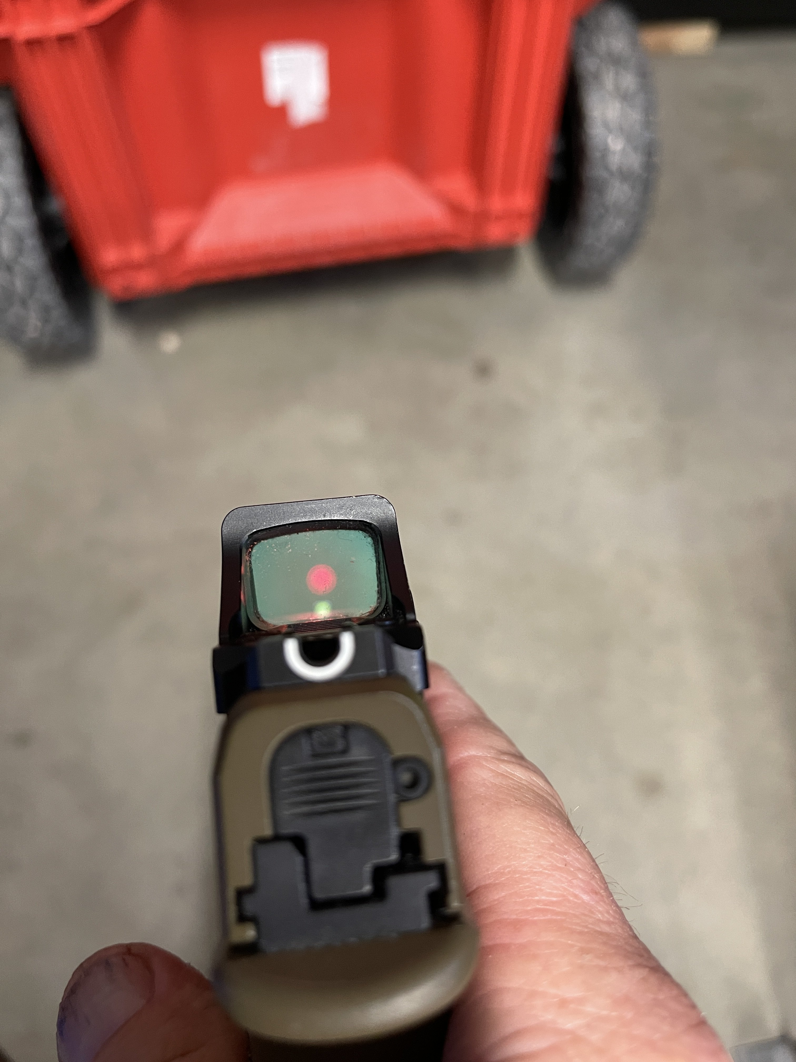

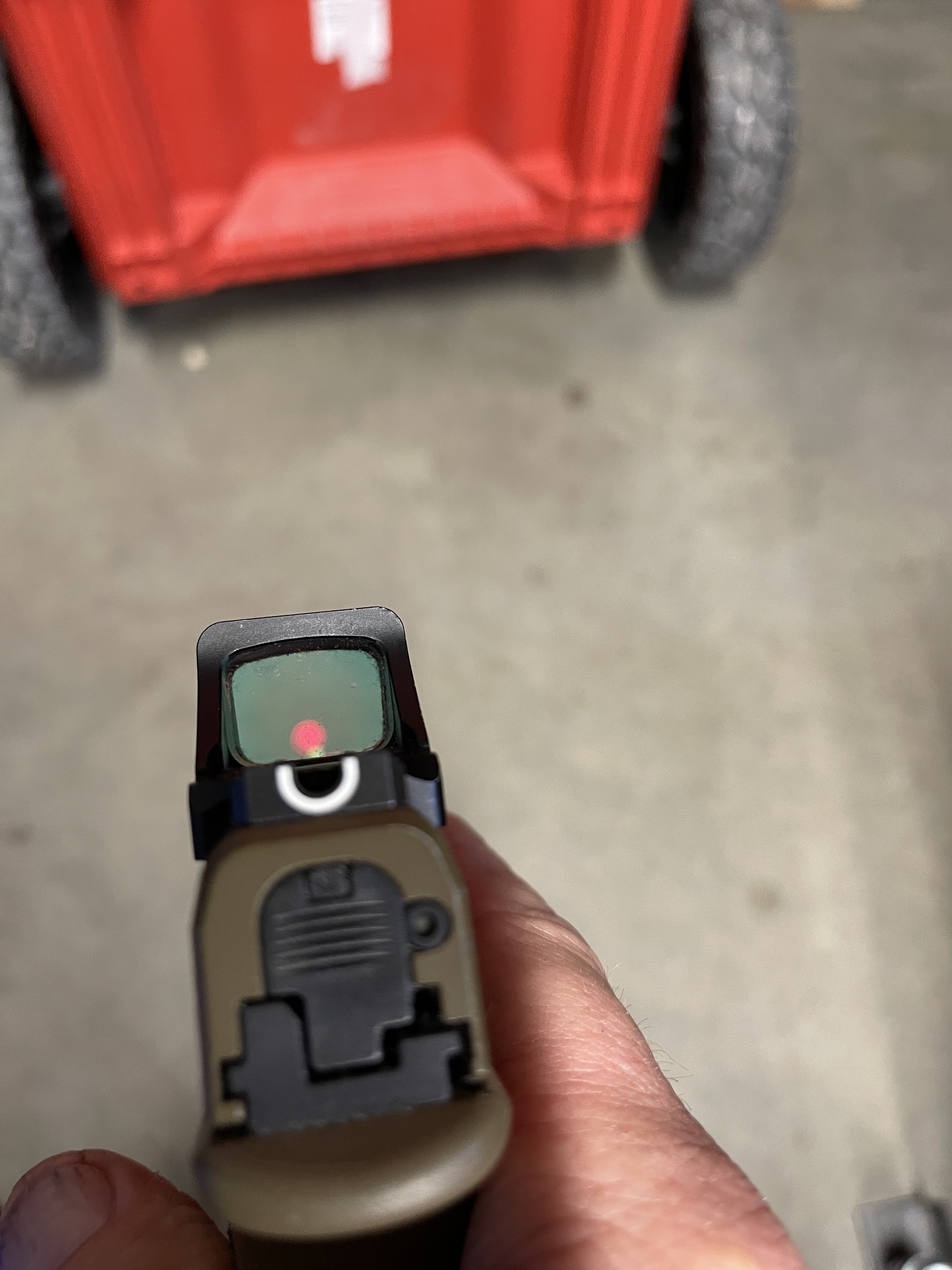

I guess I would like a little more co-witness but not much. I don’t want the irons in the middle of my glass when I’m going for the dot, ya know?Very nice. Thankx
With all due respect there Inspecta ..... true 100% co-witness is when you can see the irons correctly, as in a full sight alignment/picture along with the RDS. In your first picture the sight alignment is way off ..... actually in both pictures that show the dot they are off. In both pictures that show the dot, assuming the irons are aligned, the POI would be way high and to the right.I can co-witness w/ my 507k. The sights (front and back) are visible through the glass.
View attachment 25705View attachment 25706
Maybe I wrote that wrong but I didn’t think / don’t think I have 100% co-witness. I can barely see my irons and the dot at the same time. As far as not being lined up, that was me trying to hold the phone while pushing the focus button and my hand slipped (more than once).With all due respect there Inspecta ..... true 100% co-witness is when you can see the irons correctly, as in a full sight alignment/picture along with the RDS. In your first picture the sight alignment is way off ..... actually in both pictures that show the dot they are off. In both pictures that show the dot, assuming the irons are aligned, the POI would be way high and to the right.
In truth, you must be able to see the full iron sight configuration along with the dot in order for it to be considered 100%. And the dot will lie in relation to the front iron depending on how the two systems are zero'ed.
