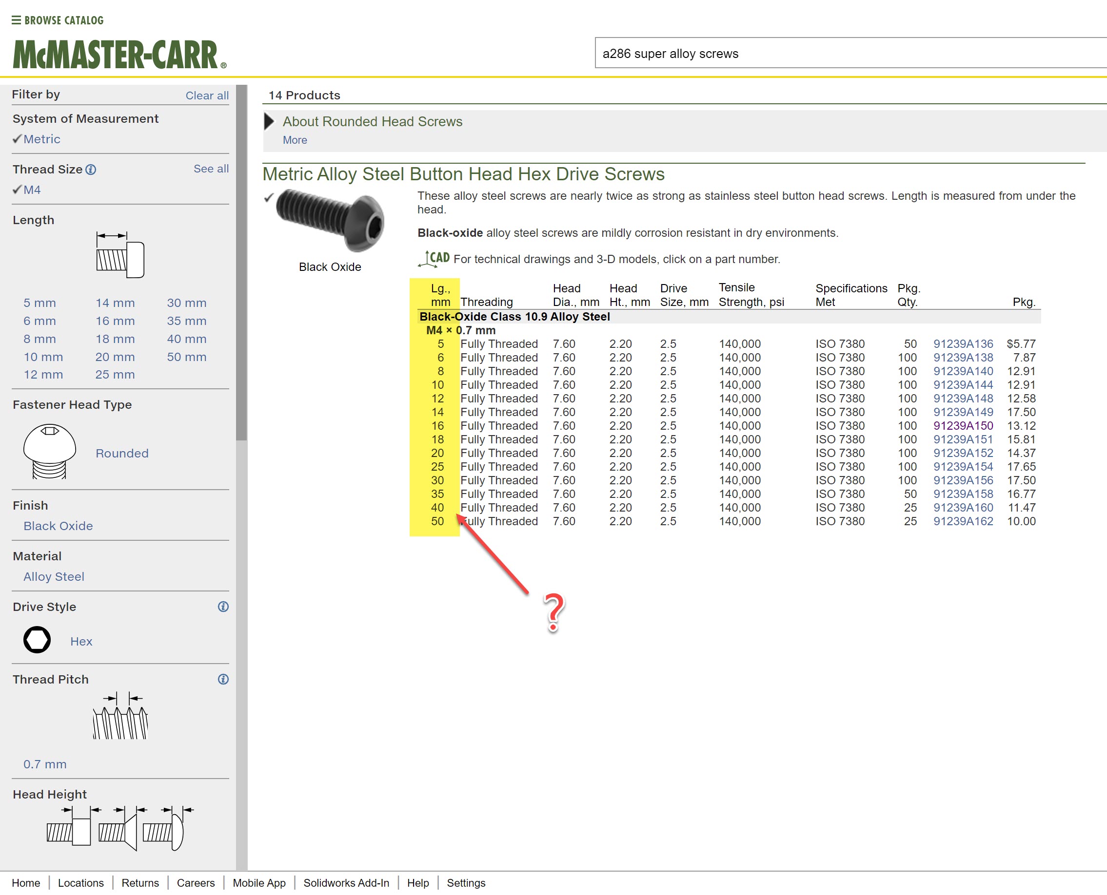

Is it right to choose M4? What length should I choose for the screw? Anyone who bought a working one from McMaster please advise.View attachment 64548
I bought some screws from MC that I thought would work but they did not. Holosun sent me more screws and a new mount and I finally got it mounted but too late to return when I noticed how bad the unit blooms.
