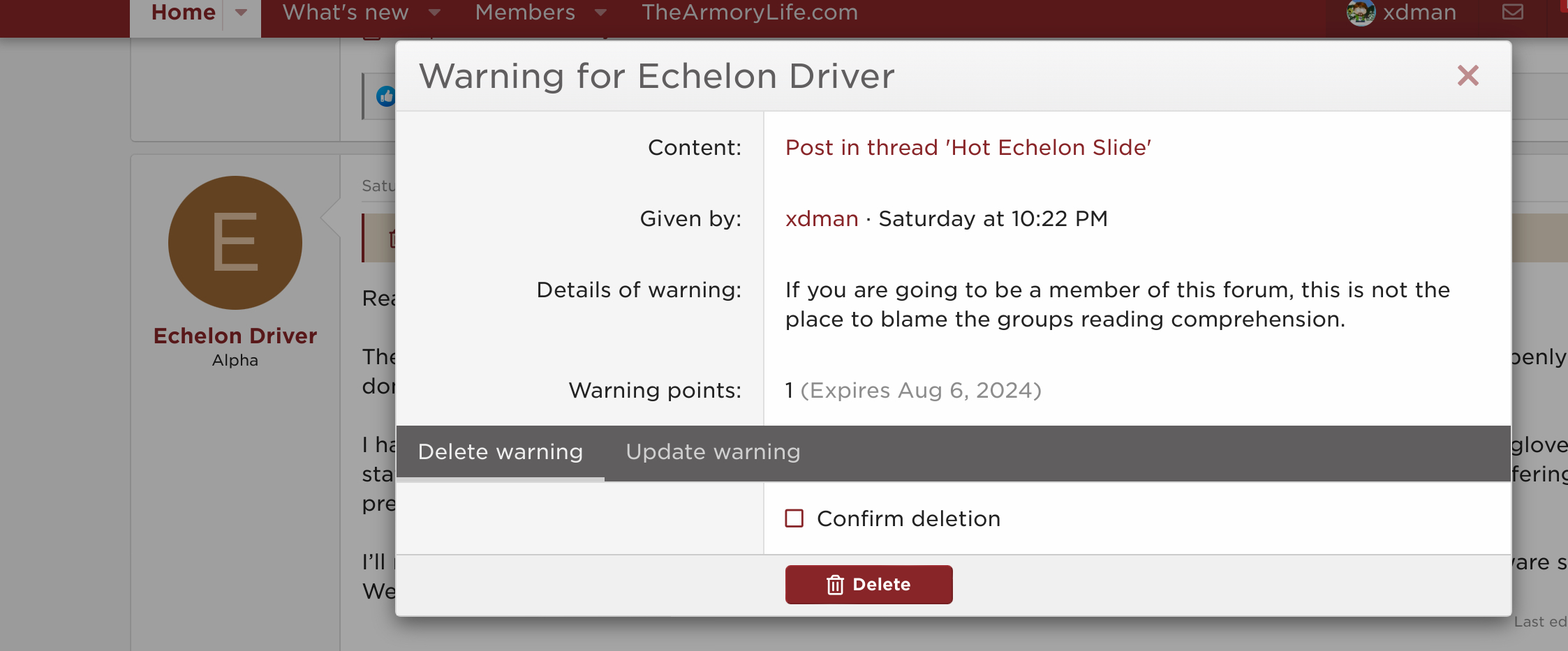

Well, I now see that one of my posts was deleted. And no notifications from a moderator. Interesting.
Well that is not true, you were also warned as well. Here is the history with the exact time and date.
Same warning other members also gave you.
While I appreciate you now telling me it was deleted, it is true.
I have never received the warning you posted nor can I find it anywhere. I’ll take that part of the discussing to a PM with you.

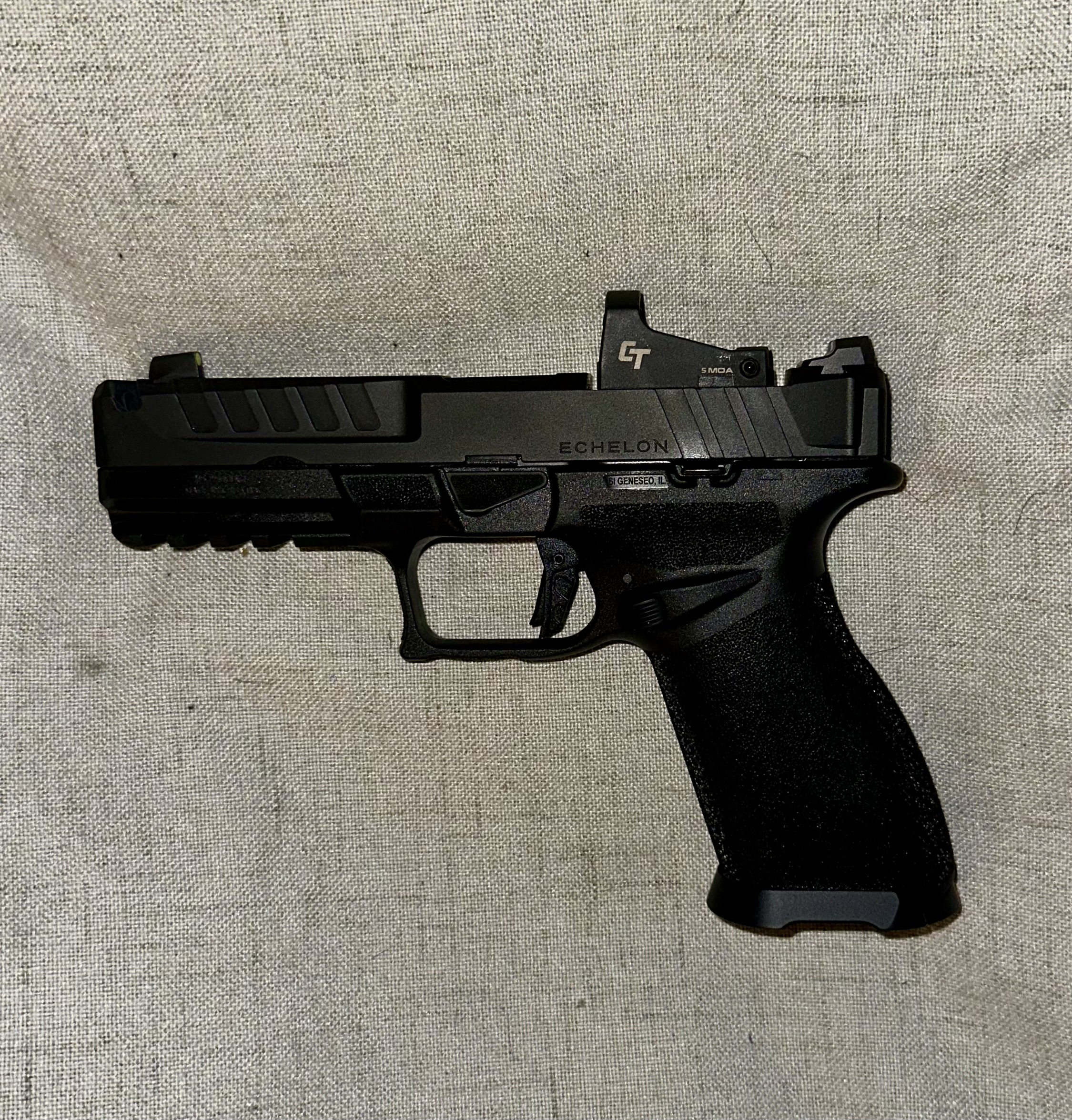

I recently bought an Echelon and I am in love with it. I am shooting very fast, more than any of my guns which includes a vp9, p365xl, Glock 42, hellcat and Kimber grand raptor 2. I have changed a few parts to make it even faster, I upgraded the guiding rod to an MDZ and trigger from tyrant. Today I went to the range and I shot 300 rounds as fast as I could and at approximately 200 rounds it was impossible for me to place my support hand on the frame. The slide release was on fire, but then I started to think that maybe all of the guys with the same slide release mechanism probably have the same issue. I will have to do a bit more research about it, maybe try to shoot as fast with my other guns to compare. On the other hand, I must say that I have never experienced my Glock getting heated in such a was, but to be fair I have never shot my Glock that fast neither. Now I am thinking that I should probably get a G17 and modify the hell out of it so it can shoot as fast as the Echelon and see what happens.
