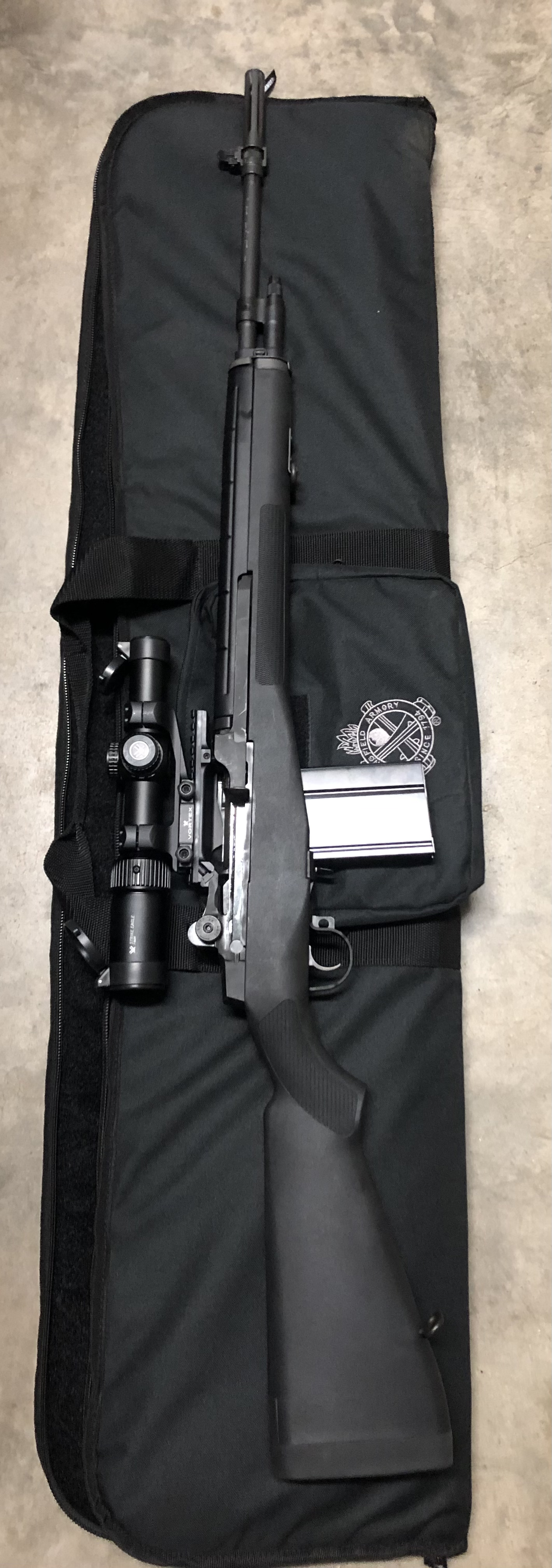

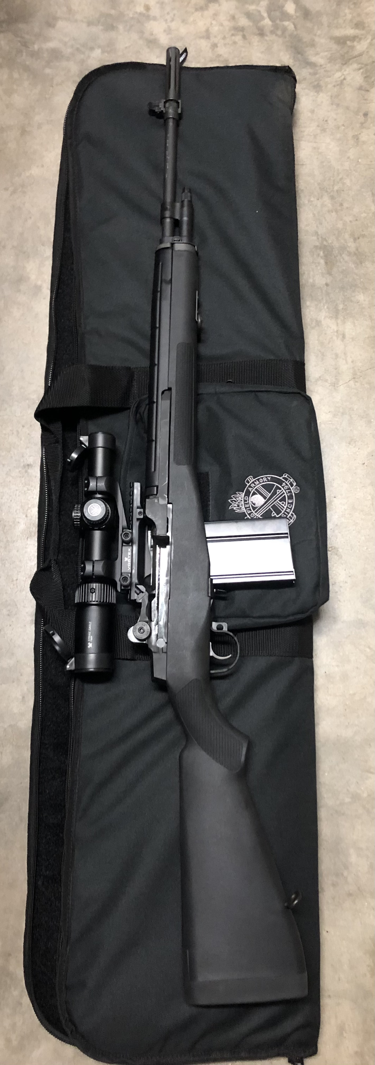

Best scope mounts for the M1A: Sadlak
Over the top of the ejection port mount
Here it is on my m1a :

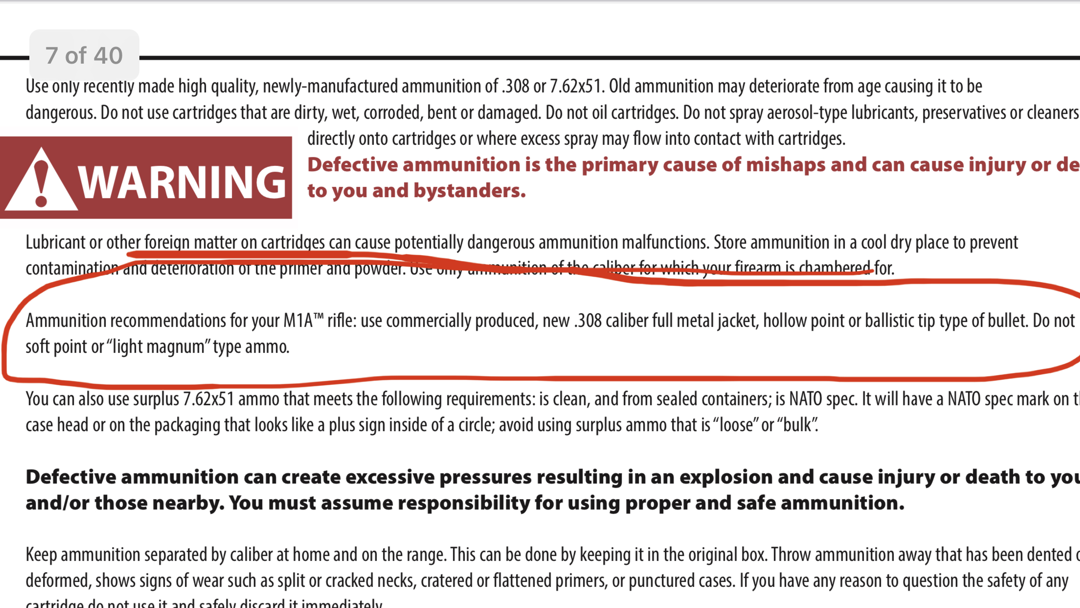

Read some interesting articles about Soft Points and these M1A rifles. Many advising not to shoot soft points. Anyone have any bad experiences with this? I have about 120 rds of soft points i'd like to eventually get rid of.
Never heard of that. I have no issues with Rem or Win brand .308 soft.
My M1A did not shoot Lake City M118 175 gr though. Primers were too hard for it. firing pin strike indentions.
Switched to commercial grade Winchester and Remington .308 and have had zero issues since.
Bummer since I have couple thousand rounds of M118. Guess more for the Saint and FAL

Usually 308win chambers won't chamber m118 ammo? Must be throated longer in your guns?
If it works, why not!
I know that this flies in the face of other admonitions in the manual regarding reloads, BUT if you do reload one could easily deconstruct that soft point ammo and pop in a FMJ in its place.
OTOH can anyone expound on the consequences of shooting soft points through their M1A? At least one previous poster claims no ill effects but what about the other way?
