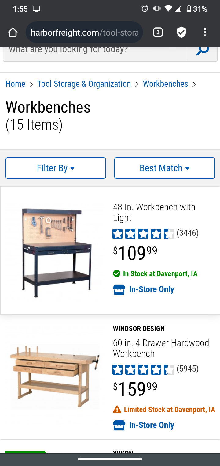

Looking for a budget work table. Lumber is too costly right now so I'm trying to decide between these two tables for general gunsmithing. Between the two, which would you pick?

Unless in a real tight squeeze, would pass on both of those HF work benches because of them being light weight. Have looked at both online and in person, the metal one is fairly flimsy metal, the wood one's better and more stable, but is designed and intended for wood working. The wood working bench one looked at there was so-so. Drawers left a bit to be desired as far as construction. Either work bench could work in a pinch though. But, remember they are lightweight benches.
Me? Work benches? Don't like to throw away money at all. Always try to find something very durable that will last quite awhile. Guess am a bit of a scrooge too? :)
On looking for a good work bench, personally tend to go for heavy weight for stability, durability and storage. Added storage drawers and or closed in shelving's a big plus. Seem to never have enough for tools or parts. But, all of that is my opinion from over the years.
If can swing it, these two mobile benches @ HF are much better and heavier duty construction:
Here's one at H Depot that isn't too shoddy and a bit lower priced than the two mobile versions:
Other thoughts are to build one out of 2x4 lumber and plywood if know how to use or have space to use basic woodworking tools.
Or, can build a good work bench out of premade kitchen base cabinets that have drawers and or shelving preinstalled and some sort of heavy weight counter top. Have built a few over the years out of various materials and still have them. A good cheap source for prebuilt cabinets is Habitat for Humanity Stores or garage sales.
