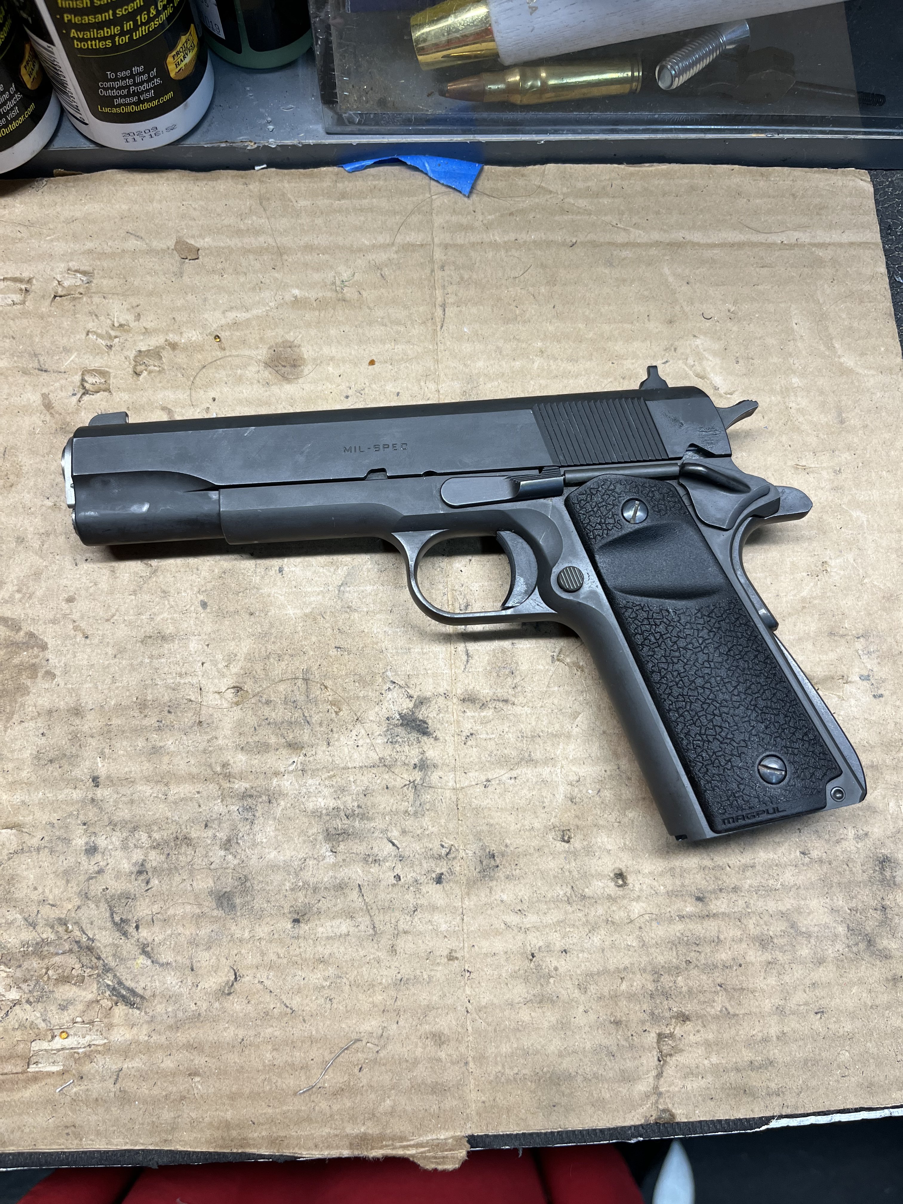

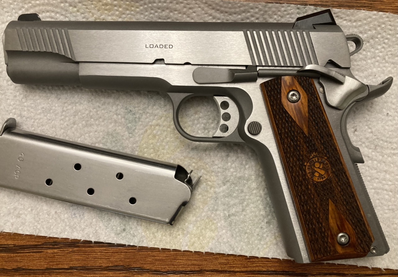

Next up is the second Springfield Loaded in 45 ACP. This is the version that was recently discontinued. It does not have the pesky lock in the main spring housing that the CA model has.
This gun did not do great on the first magazine. Had 3 out of 7rds that failed to feed and the slide did not lock back on the empty mag. As mentioned previously, I sanded the engraved area on the bottom of the slide, ran 3 more magazines through it and it ran flawlessly.

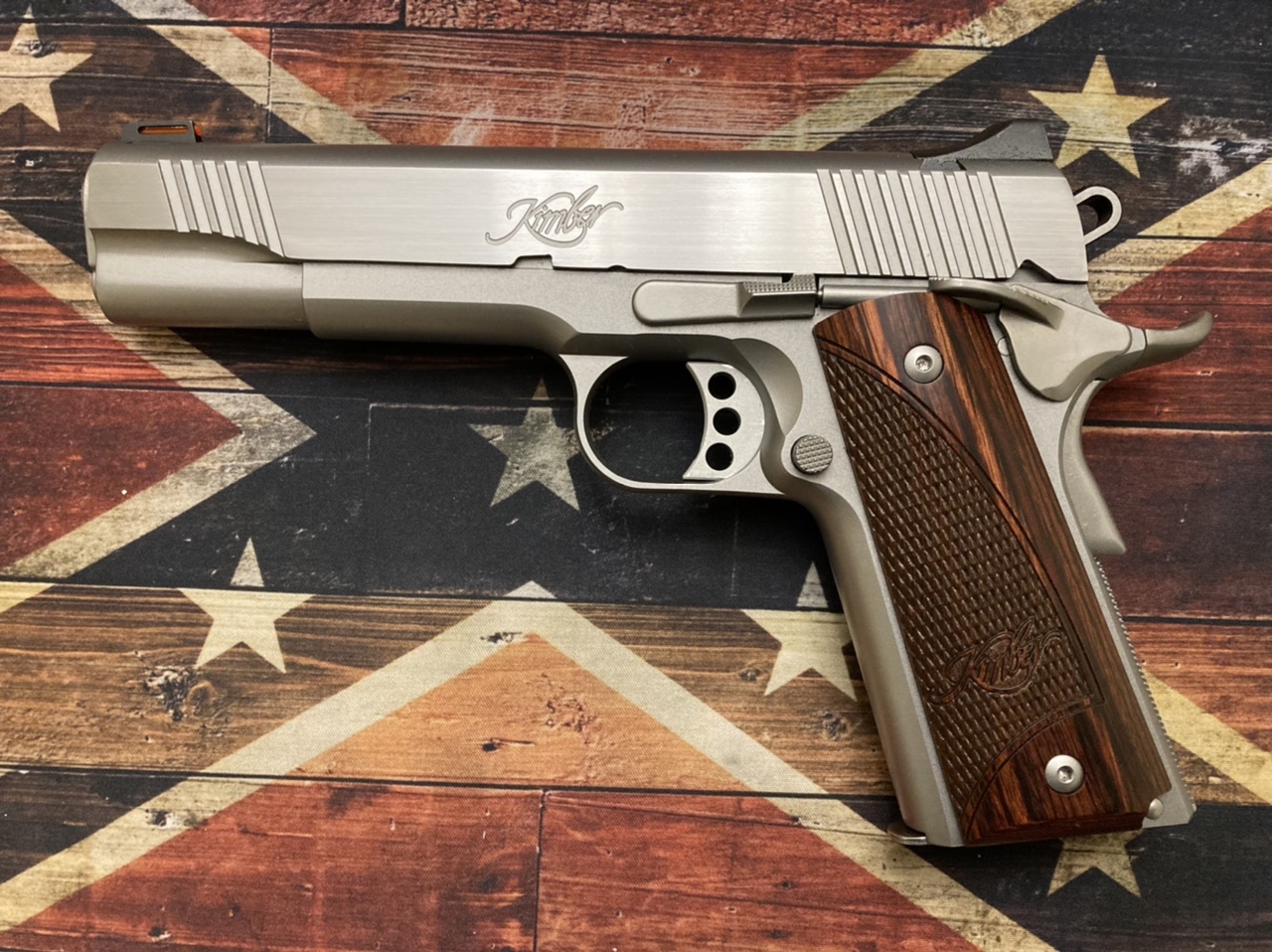

Next, is the Kimber Stainless II in 45 ACP. This gun was an excellent example from Kimber. No issues with it so far. As mentioned in previous posts, I sanded the slide and removed the matte. The original finish was very well done but I preferred the machined slide look.
This gun when originally tested ran flawlessly. As expected, it performed very well today as well shooting a 5 shot group at under 1”. It still shot a little left as it originally did. That can be fixed with a slight sight drift.
If you can’t tell by the photo, I toned down the sheen on the slide with a light dry sand with 600 grit.

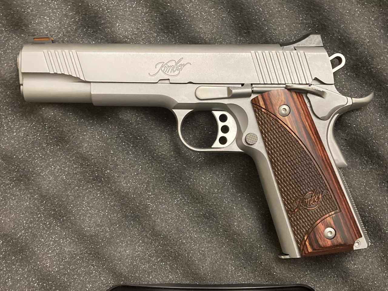

Next is my newest Kimber Stainless II in 10mm. This was my anniversary present from the wife. Pictured in its original state. This gun had never been fired until today.
The good news is, it grouped well for a 5 shot group at roughly 1.25”. Fired in the same conditions immediately following the initial 3. It appears that a slight drift might be necessary as it favored right.
The bad news, every single round tested failed to feed except the initial chamber. I thought I heard some sounds that indicated the mag may have been binding so I changed ammo and changed the mag to an unbranded mag that worked in the other Kimber 10mm. That did not fix the issue. The first round chamber failed to feed as well as 3 of the 4 remaining rounds. So far, there have only been the 2 rounds that fed properly.

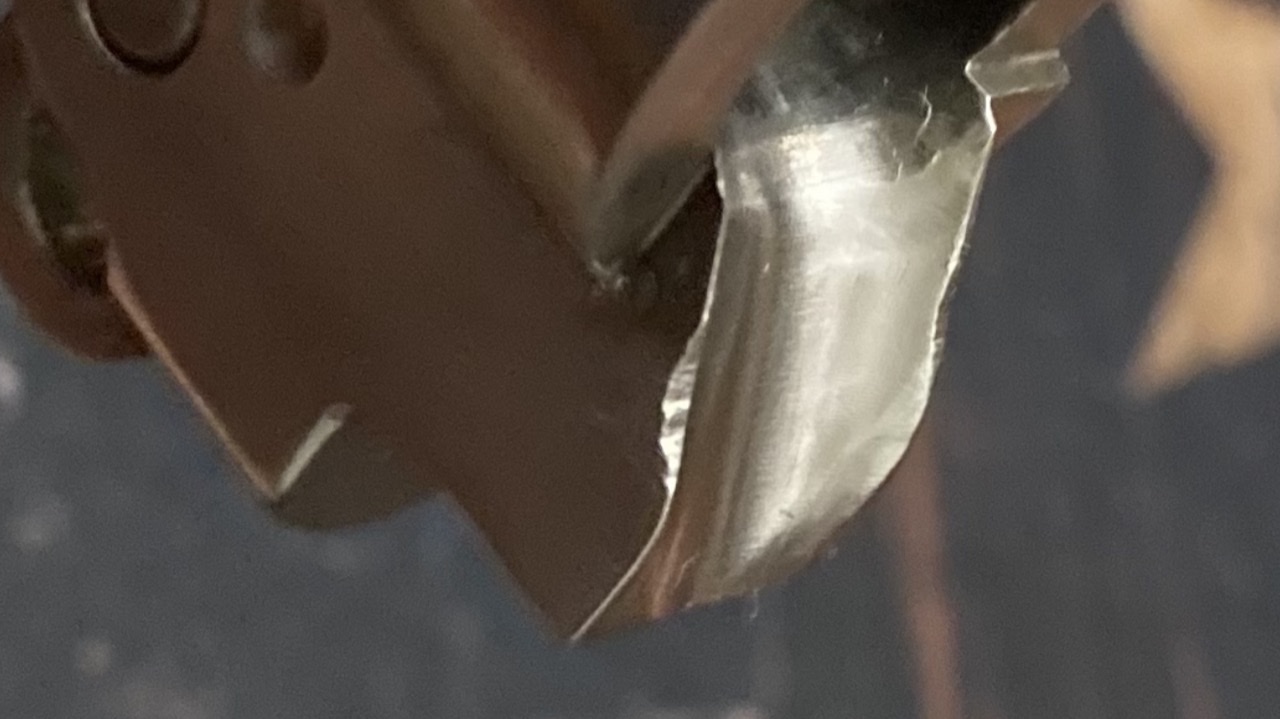

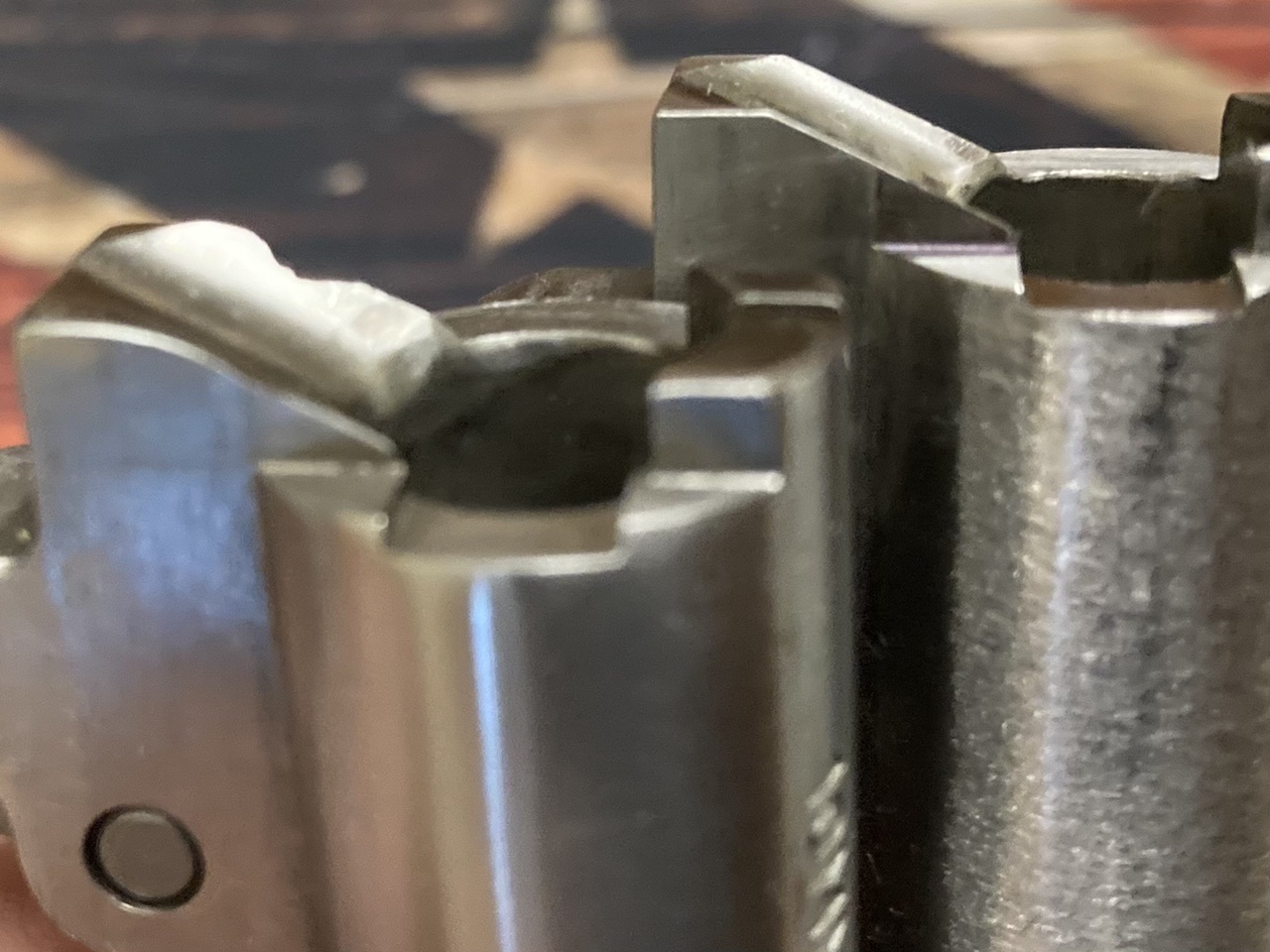

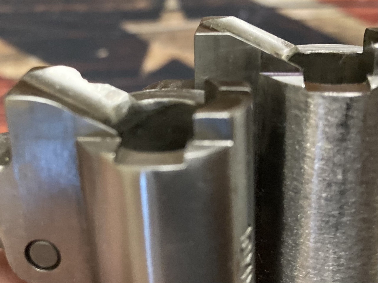

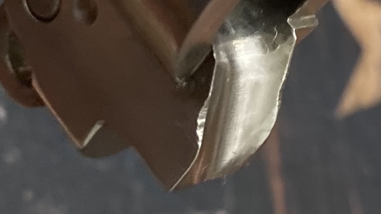

I opened the Kimber 10mm again to look for obvious issues.
The only thing that jumped out right away was that to be a chunk of the feed ramp missing.
Here is the barrel next to the other 10mm barrel. The other side of that feed ramp doesn’t look so hot either.
I don’t know that this is the problem but it did seem like the rounds were favoring that upper left corner to get hung up. I’m sure this doesn’t help.
I'd send that thing back immediately.
