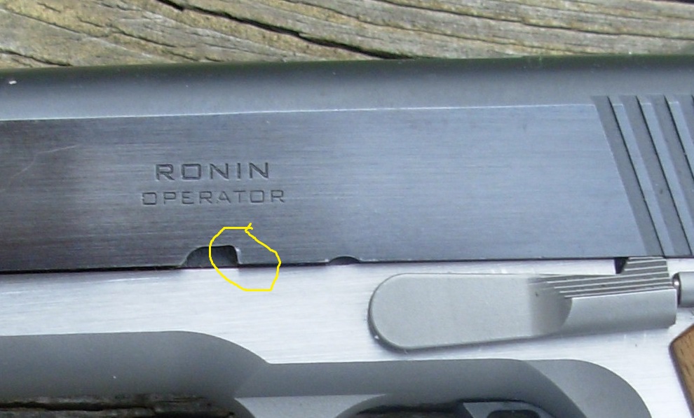

My Ronin (9mm 5") shows some light peening on the slide stop notch. Very slight but it can be felt.
Questions: Is this common? Causes? Is it self limiting? Leave it alone or address? Lightly tap raised material back flat or stone and touch up?
I have had one range session with this one but it was purchased used and it may have been there although I don't think so.
I put a 12# Recoil spring in it: Too much spring causing it to hit the stop too hard on last shot?
It had a few failures to lock on the lighter loads.
I was using the slide stop to release the slide on a new loaded magazine. I know better now and will pull back the slide and release (slingshot?) in the future.
Loads ranged from mils Blaser Brass 124 grain to +P 124 grain Gold dots. All factory loads
Observations / advice please

Most of my 1911’s show this, to me it’s normal, not a issue

I'm pretty sure that USGI slides were spot-hardened in that area, and you can actually see a difference in color on some of them. Maybe SA (and others) aren't doing that anymore?
Just took a quick look at my "house gun," which has a USGI WWII Ithaca slide. I straightened and polished that slide, then had it sandblasted, then matte-blued around 1985 or so, then put about 25,000 rounds through it, with the slide reliably locking back, and I ALWAYS dropped the slide using the slide stop (i.e., I NEVER "slingshot" this or any other 1911). There is NO wear whatsoever in this area. ;) (y)
Thank you for the input. It appears to be a normal thing to occur so I will leave it alone and won't worry over it.
