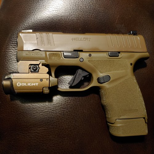

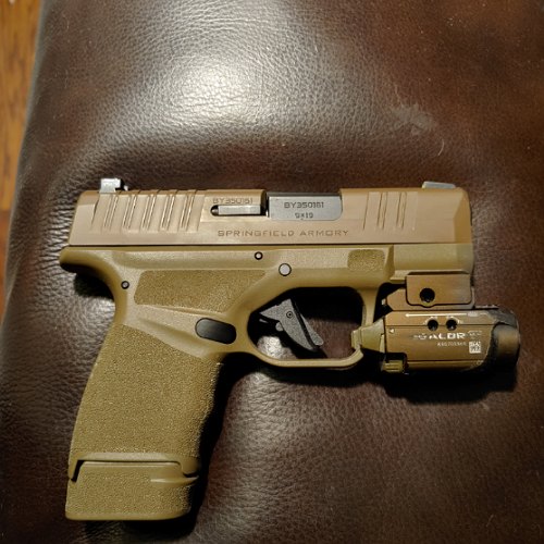

I looked through the thread and don't think I posted this yet - I have an O-light Baldr-mini on my Hellcat. I removed the flipper-handle rail attachment, and replaced it with a screw from Lowe's (I want to say an M3 size - it fit the factory nut and spring setup, I just got rid of the handle that stuck out). I have no windage problems, it clamps to the rail quite nicely with the bolt setup. I suspect because I can clamp it tighter than I could with that flipper handle. I lost the "quick release" function, but I'm fine with that. I keep the USB charger shoe accessible in my safe, and it charges every night and there's really no reason to remove it. It also got rid of that bulky flip-handle, which makes it a LOT easier to holster (I made my own kydex shell, for use with one of my Alien Gear IWB backers).

@Peglegjoe would you mind posting a pic when you have a chance? I think I know what you are saying but would love the visual.
Here it is. No more flip-lever. I also dremeled down the hard corners on the leading edge, rounding them for easier reholstering.
