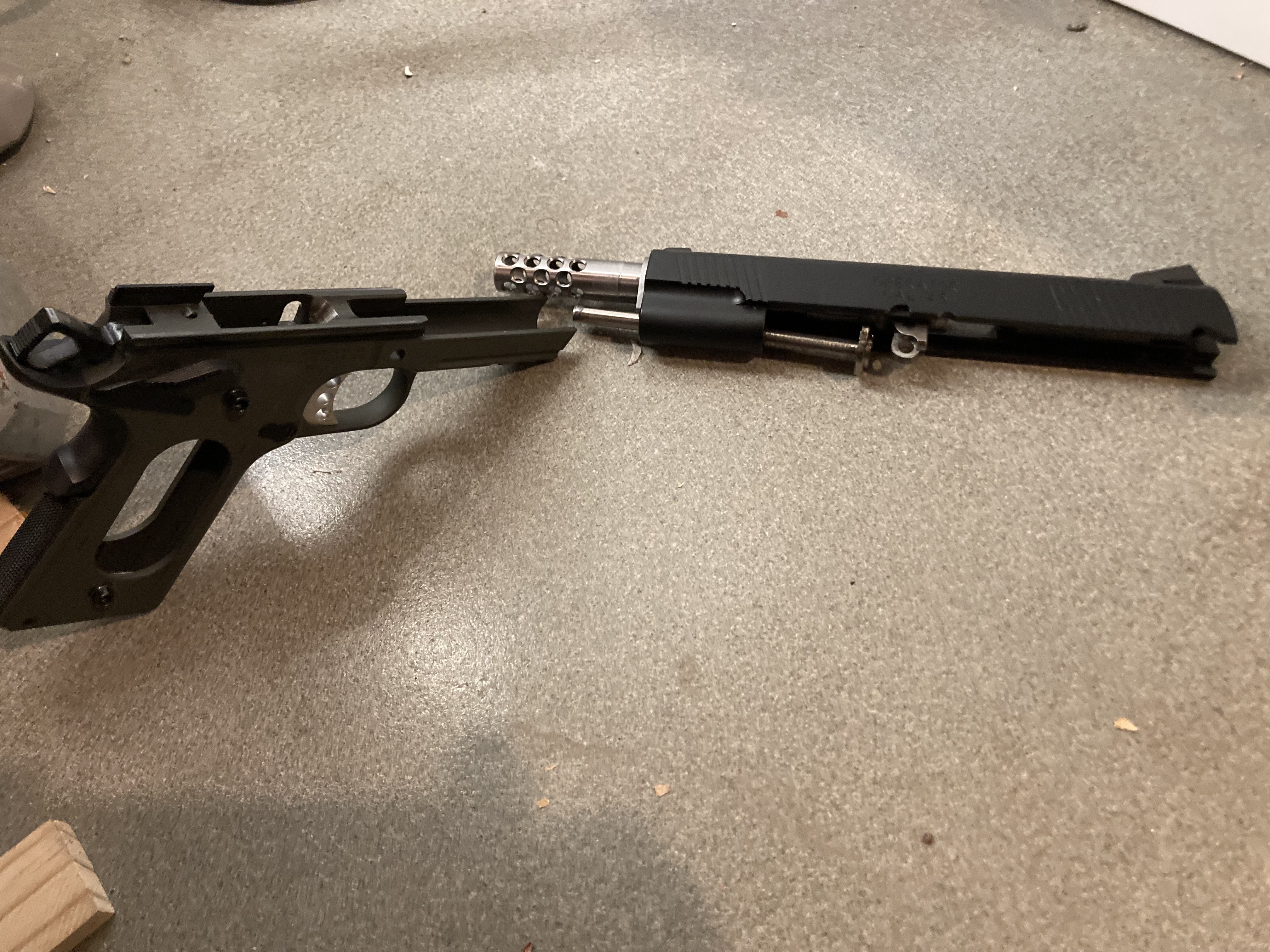

Very appreciated for everybody's feedback here. So as we knew there was some metal piece blocking and like some stated it's normal for 1911 and needs to slam it forward. I took that into consideration and used a hammer to hit a small wood precisely behind the slide and it came right off.

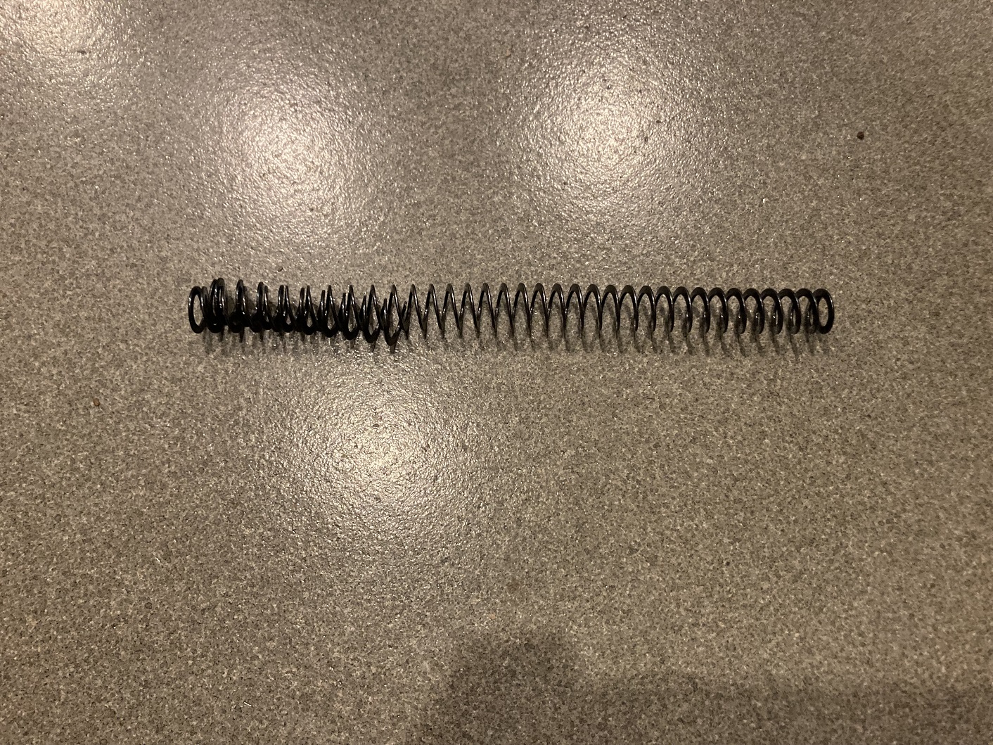

ok putting this back together. does the double spring side goes to the top of the barrel? I forgot now with all that ordeal i went through

i have no idea on that piece of metal that i am seeing, but you had better check that guide rod's "horse shoe" area. if it comes from there, do not reassemble, get a new one
it can be from the inside of the frame, anywhere, maybe even from the barrel area where the holes were drilled.
i am not certain, but it "might" go onto that "tip" of the guide rod, i saw in your few pics you posted earlier, i just cannot say for certain.
look for a smaller diameter on that guide rod for where it might fit.

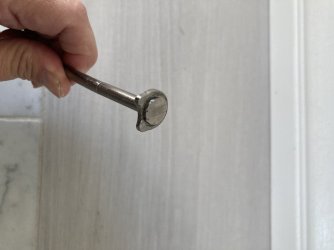

The double spring would go at the end of the guide rod under the chamber. That picture with the slide off and showing the guide rod and barrel, that horse shoe end of the rod looks all boogered up. Something is a miss.
yeah, it looked that way to me as well, i just don't know if that small piece of metal, comes from that or someplace else.

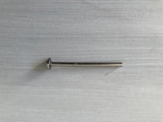

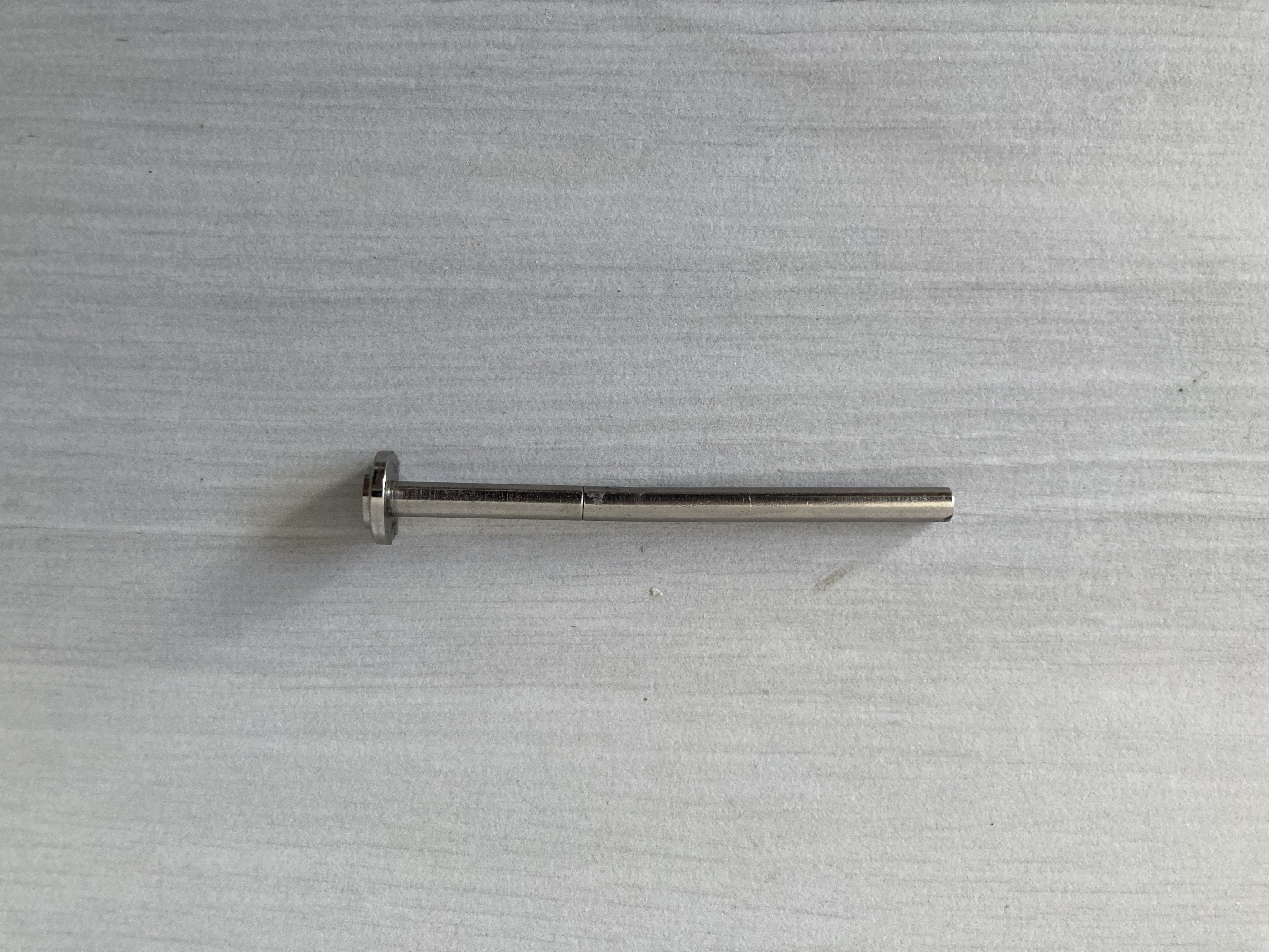

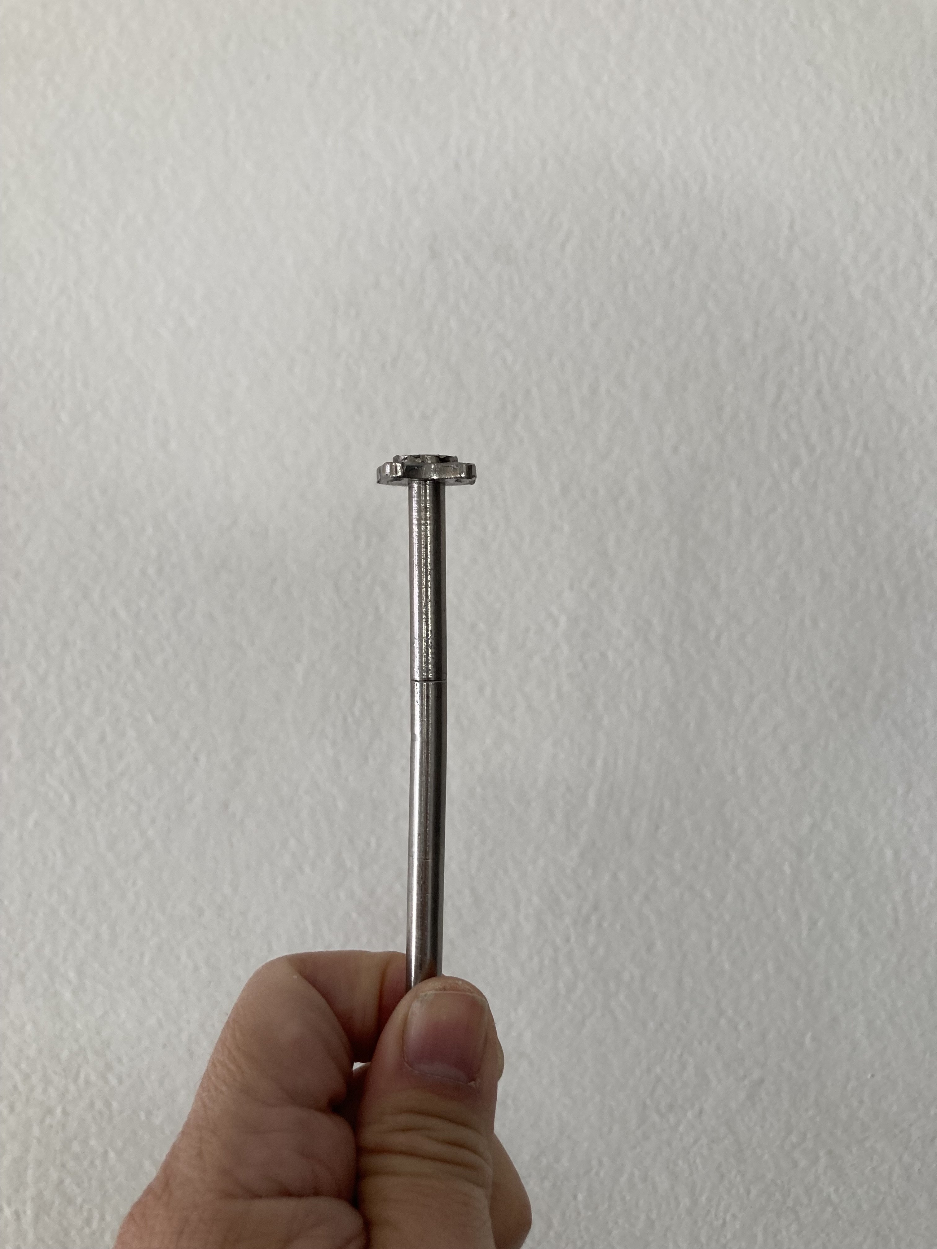

and you guys are right, that guide rod is so screwed up, it's bent. What would be a good ideal guide rod to buy in place of this one, this one needs a allen wrench and it's comes in 2 pieces
I would contact Dawson Precision and see if they make a toolless recoil rod. Wilson Combat also does toolless recoil rods.
