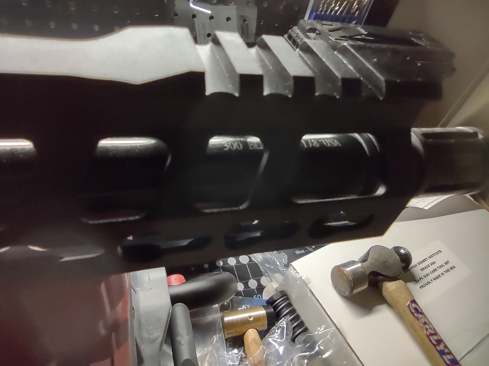

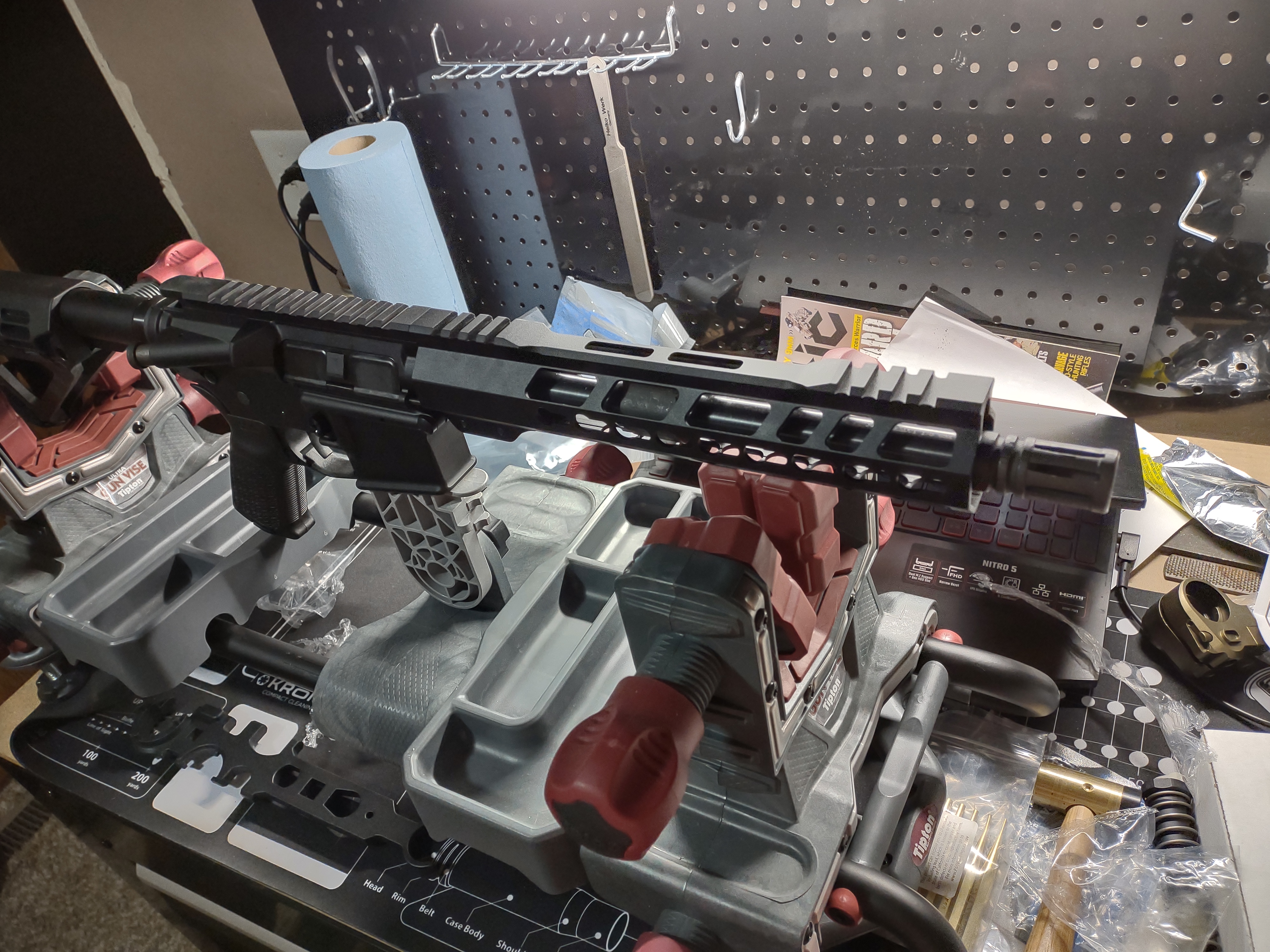

I did choose a complete upper. I went with a 10.5" 1:8 twist upper from CBC, keymod furniture. I found that on sportsman's guide. Got a basic and generic lower parts kit from PSA and a basic stripped lower as well. The brace is an SBA 4.
I went with a PSA MPI nitride full auto BCG.
Just in case anyone wanted details
