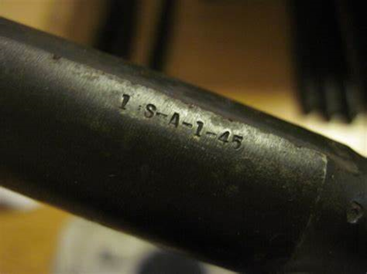

This is what Scott Duff has posted on his web page: "As all M1D rifles were rebuilt rifles, the receiver may be of any manufacture and of any serial number produced prior to the date of the rebuild. The same applies to the individual components, any part made prior to the date of the rebuild is correct. All M1D barrels were made by Springfield Armory. The earliest observed M1D barrel is dated 5-51. M1D barrels have been counterfeited and merit carefully examination. Nearly all M1D barrels were stamped with drawing number D7312555. M1D barrels manufactured through the fall of 1952 had the drawing number stamped on the top, underneath the rear hand guard. M1D barrels manufactured after the fall of 1952 had the drawing number stamped on the right side, adjacent to the date."

Here's a wartime M1 barrel for comparison. Notice there is no raised metal around these letters.
