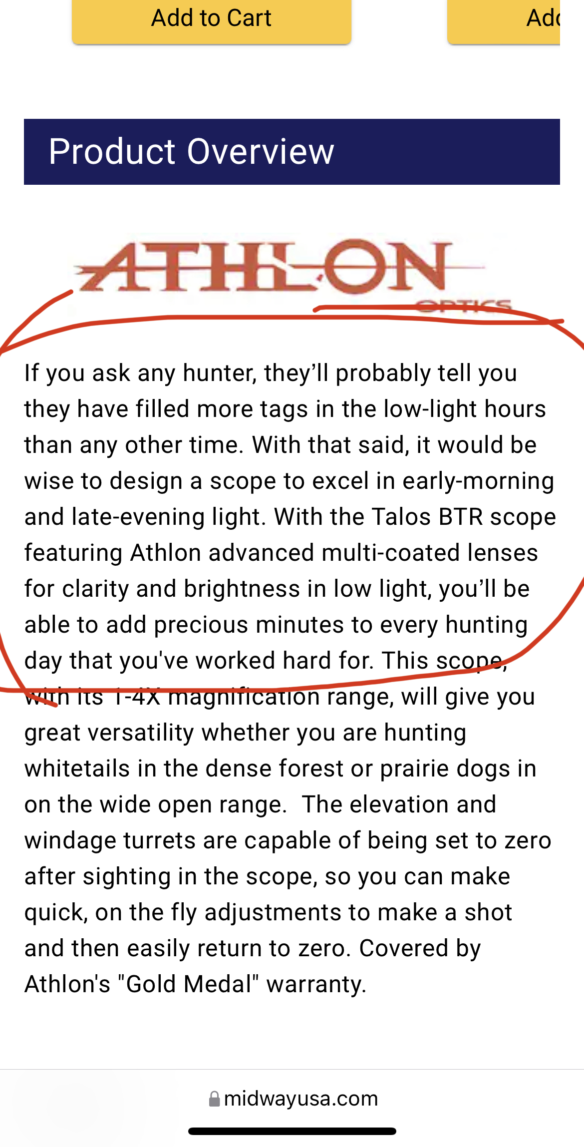

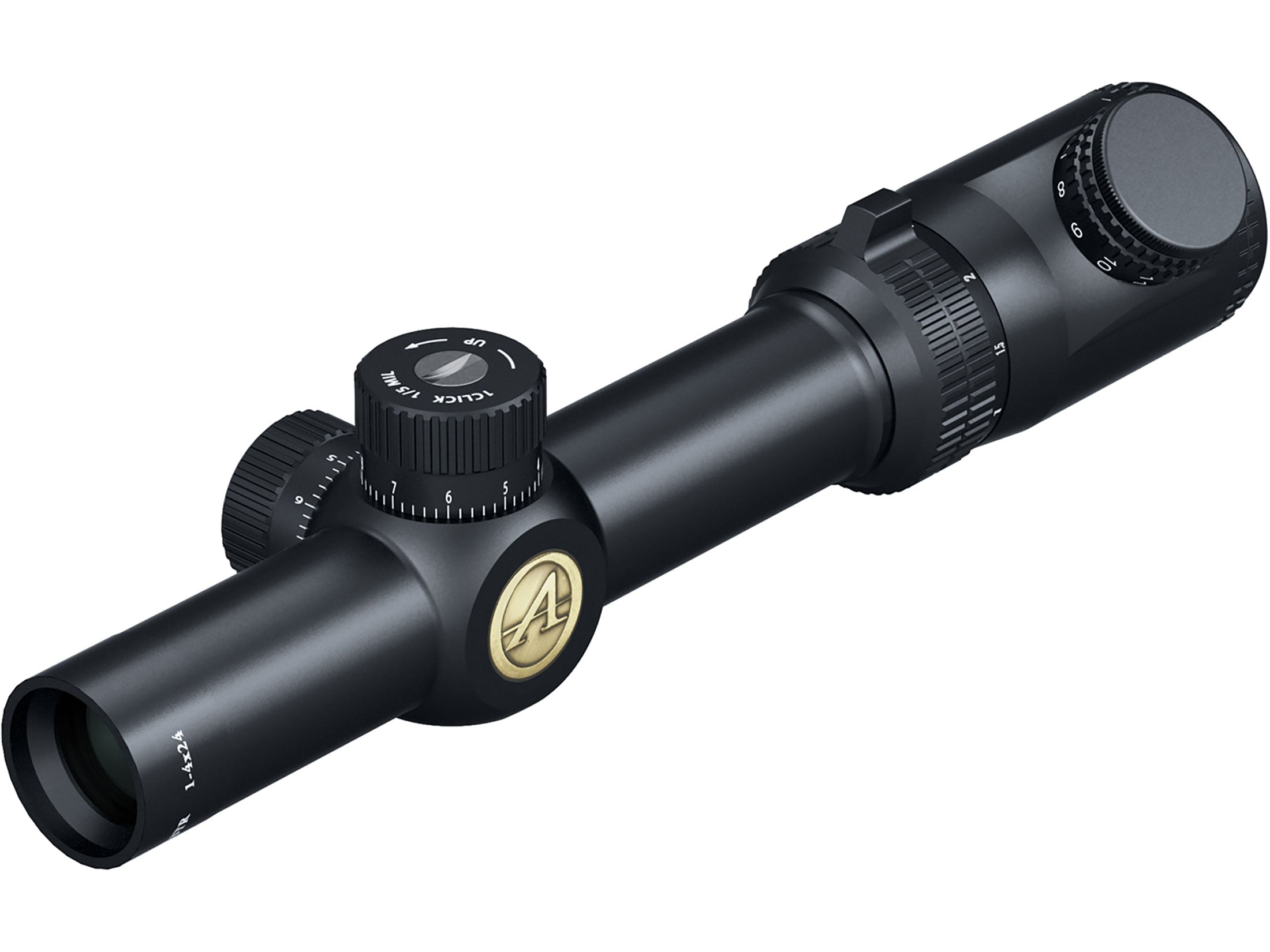

I'd get one of these when they came back in stock...
That is the truth in the product description.. agreed.
What I said previous post about low light. I Usually end up taking game at first or last light when they’re moving from or to their favored area

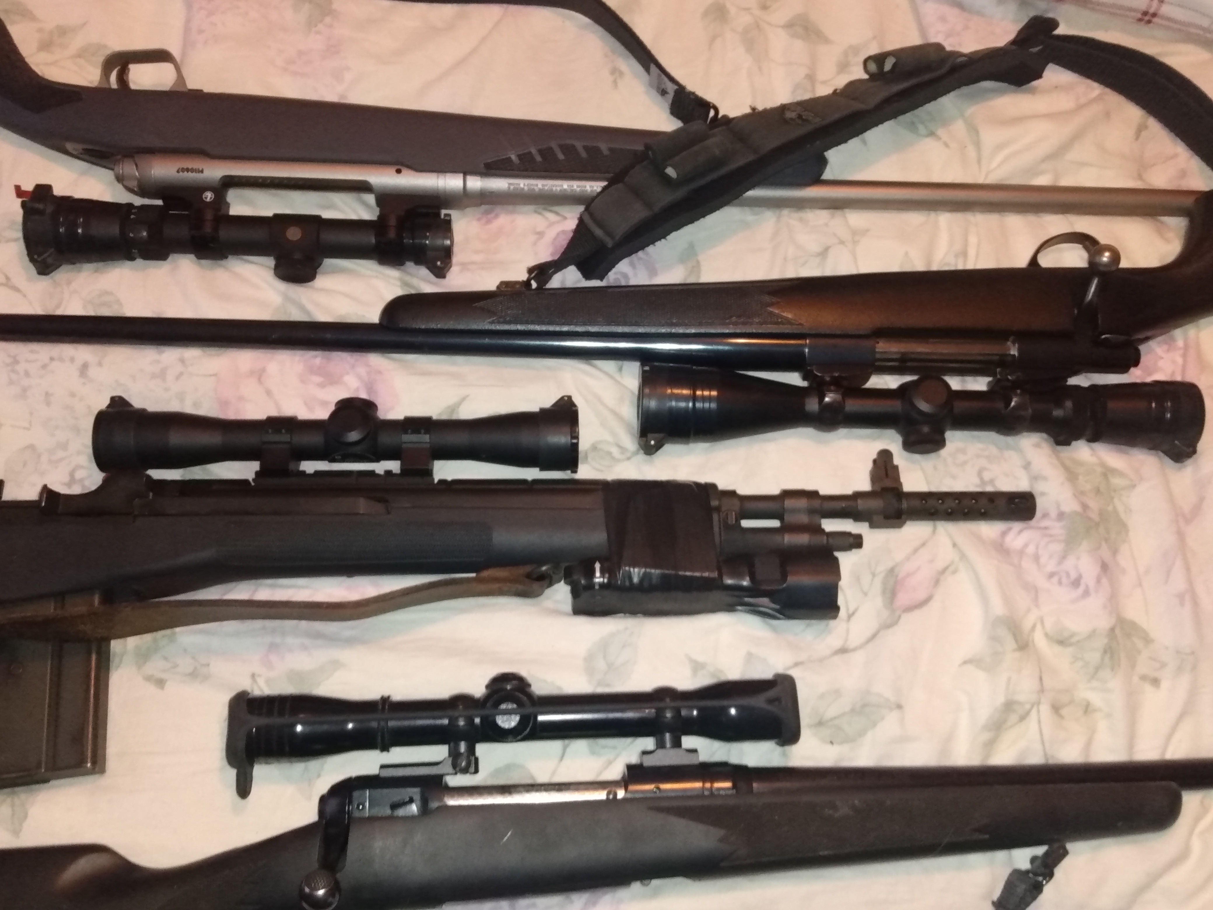

Here you go! All hunting optics. All SFP optics. All with low profile dialing turrets. All with protected turret covers. Note: The bevilled surface on the turret caps for even better snag deflection. Two of these optics are fixed power and have only two adjustment dials on the entire scope. Three out of the four optics are Leupy's, but that's just my personal preference.

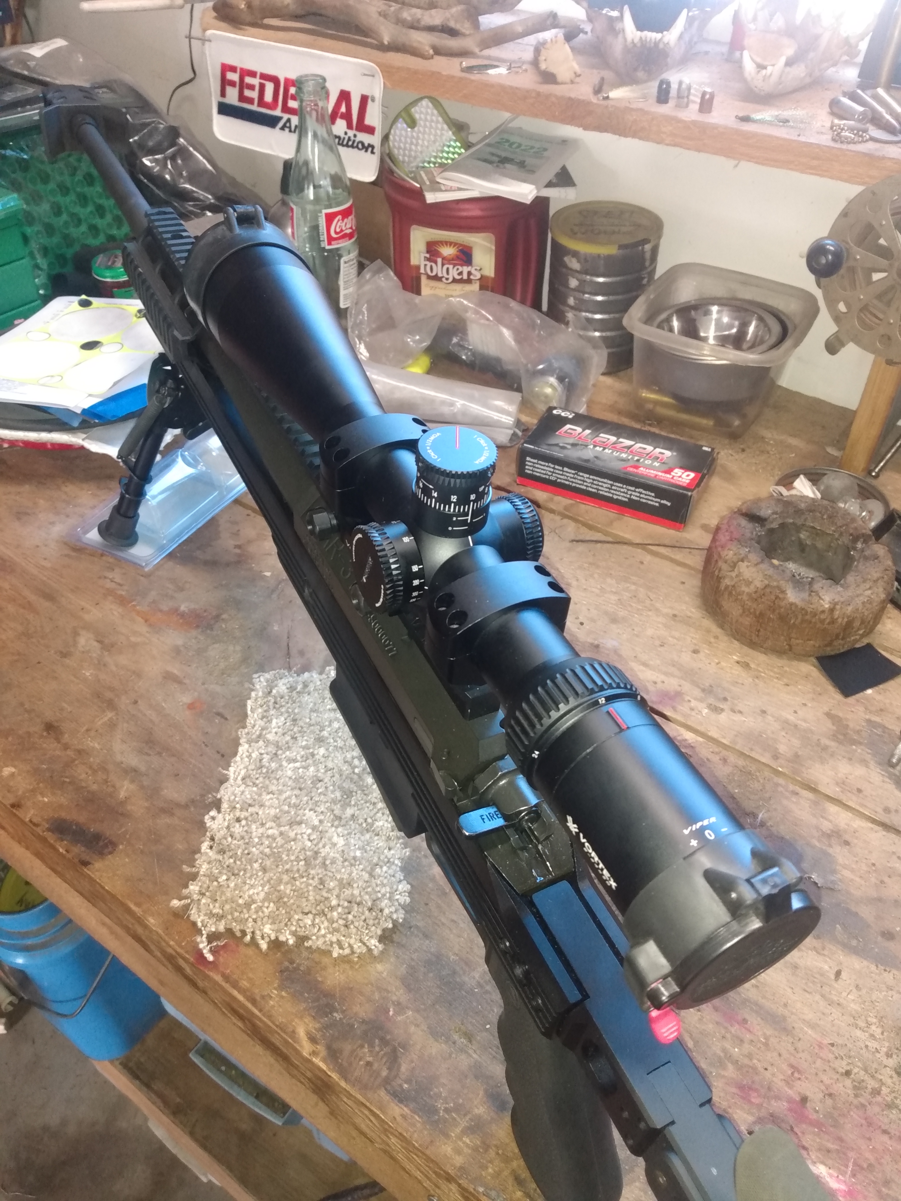

Not a good hunting optic in my opinion! A FFP optic. It has FIVE!!! adjustment dials! Only two are low profile. The zoom and the the eye piece focus adjustment. Only one of the three turrets has protection caps to prevent accidental turret adjustment. High magnification = poor performance in low light. Hope all this info helps!
