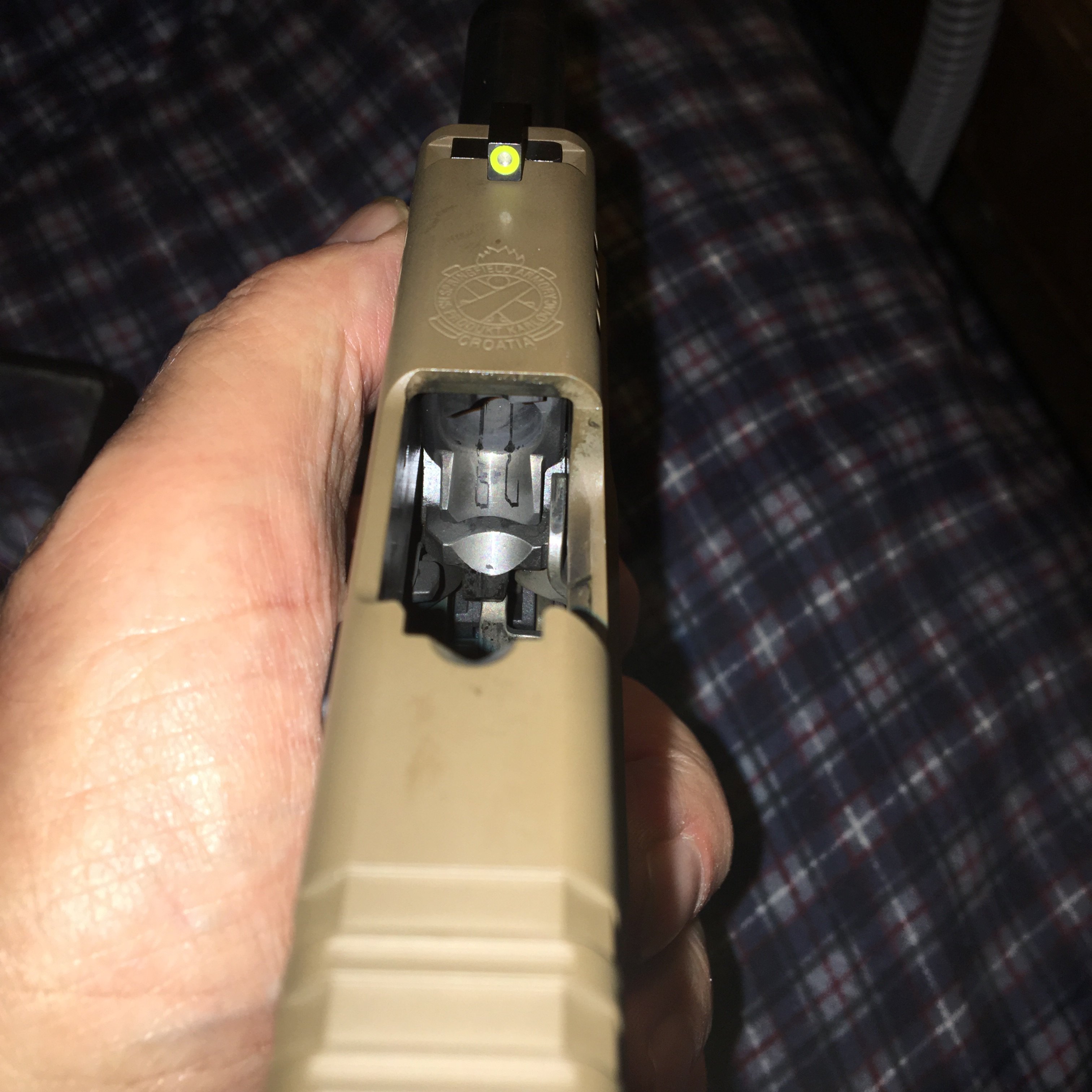

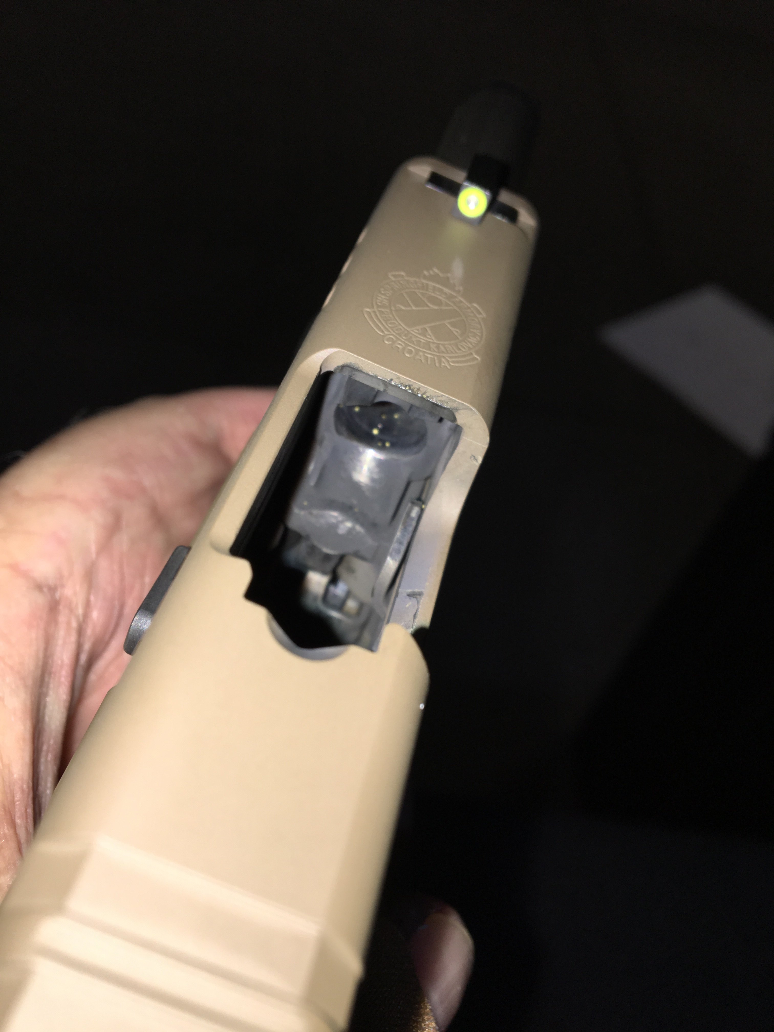

I appreciate the feedback,.. I considered that, except I rented the range's Hellcat prior to acquiring mine and didn't have a single issue with it. I also rented a Glock compact,.. (48 or 45 I can't remember). I didnt have any issues with that weapon either.
Springfield warranty had it for two weeks and I just got it back. Haven't had a chance to run any rounds thru it yet, but plan to this weekend.
They wouldn't tell me whether or not they could reproduce the issue,… But they polished the chamber and feed ramp and it looks significantly different than it did when I first purchased it.
This is what it looked like when it was jamming,…
This is after polishing,..
(...I have no idea what those marks are. It's not excess lube as it didn't wipe off.)
I read the earlier posts about making sure that the feed ramp was all bright and shiny and as you can see initially mine wasn't that even looks like it had rough striations on it,… Was that slowing down the feeding of the rounds? Would that have been why it was failing to return the battery properly?
I'm a little miffed that I can't get any details from Springfield but I've been informed that that's pretty much the way they work. :Shrug :
Your not taking into account the HellCat you rented probably had a ton of rounds through it and yours is still breaking in so keep shooting it and concentrate on your grip as mentioned in a previous post.
