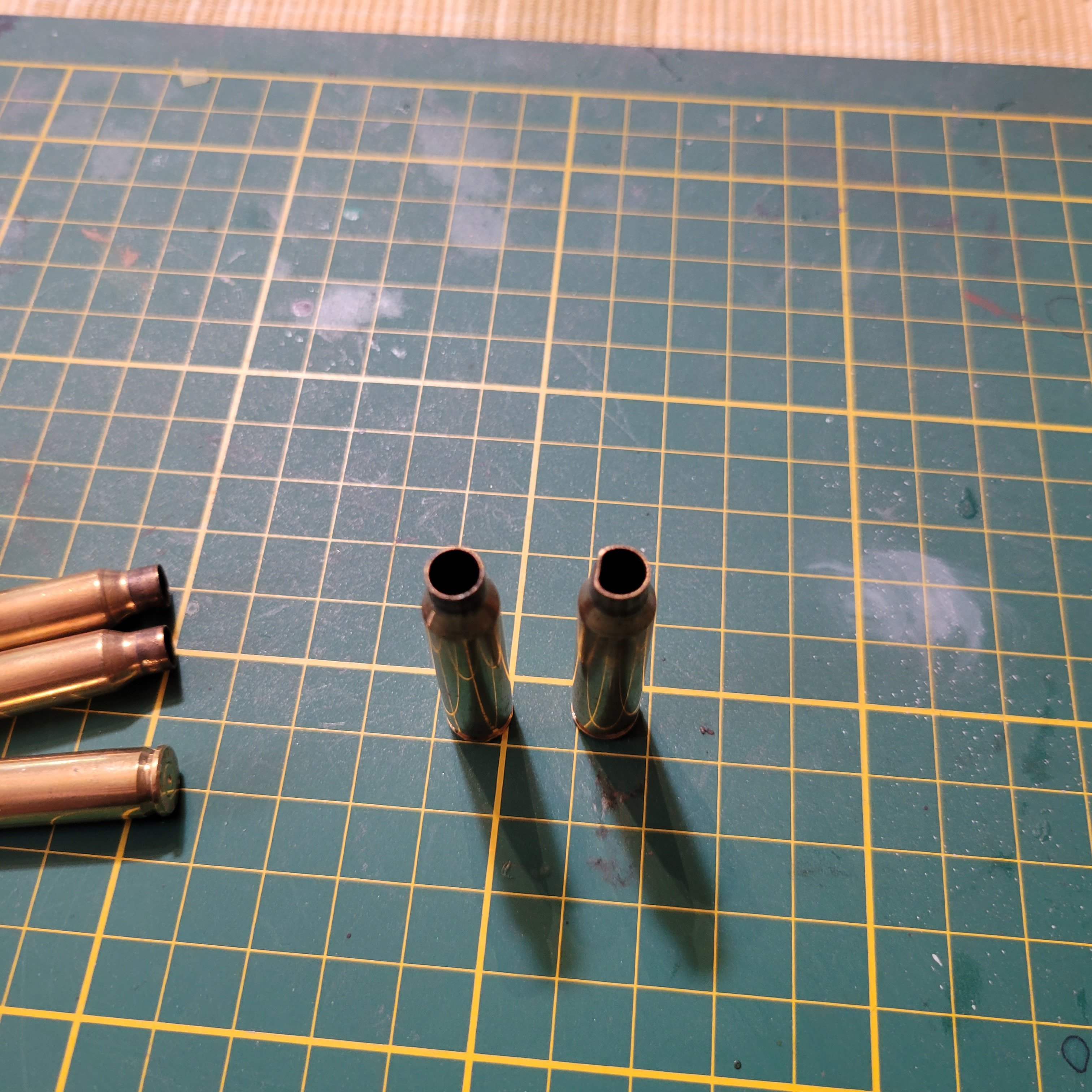

Hello everybody. I've recently up a Hellion and have put around 180 rounds of PMC black and bronze 55gr .223 through it. Of the 180 or so rounds only 20 have been ejected without a dented case mouth. Has anybody else ran into this problem? I'm running the rifle on the normal gas setting so I'm not quite sure as to why this is happening.

Pic for reference:

Pretty sure its the brass deflector on the upper causing the dents as the brass strikes the deflector .
My AUG and Hellion both do that
I have a big aftermarket deflector from Corvus defense on the AUG.
You’ll prob notice a lot of brass marks on the Hellion deflector
