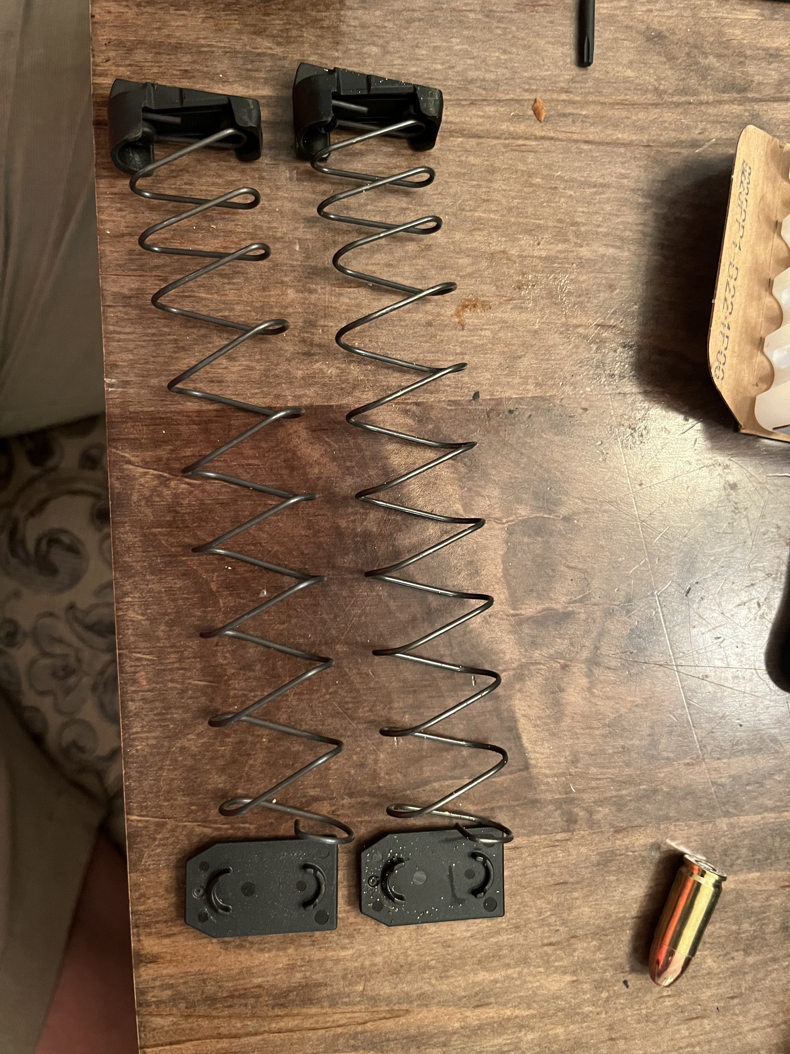

I just purchased a new Prodigy that came with a 20 round mag and a 17 round mag.
20 rounder runs perfect. Zero issues.
17 round mag will only take 16 rounds and the gun misfeeds about every 3 to 4 round. Is there a know issue with the 17 round mags?

Did you disassemble the mag and reassemble? I had a factory P365 mag with an upside down spring.

Pull the bottom off the 20 and the 17.
Make sure the spring is situated correctly in the 17 By comparing to the 20.
I had 3 17 round and 3 20 round mags when I had my prodigy.. all fit max capacity.
Out of over 5K round count through that pistol, I think I pulled the mags apart and cleaned them once, but never had an issue with the mags not holding advertised capacity. I did have an issue with one that didn’t lock back, but…it was me, put the spring back in backwards.
Prodigy mags are made by Dura Mag. Used them in my Prodigy and my Staccato P… no issues other than above mentioned self induced..:)
The only possible issue I see which would make sense is the 20 round mag and 17 round mag have the same spring. See pic of side by side. If the 20 round spring is longer, then the math adds up.
Too long so it won’t compress enough to allow 17 rounds. Too much upward pressure causing mis feed.
