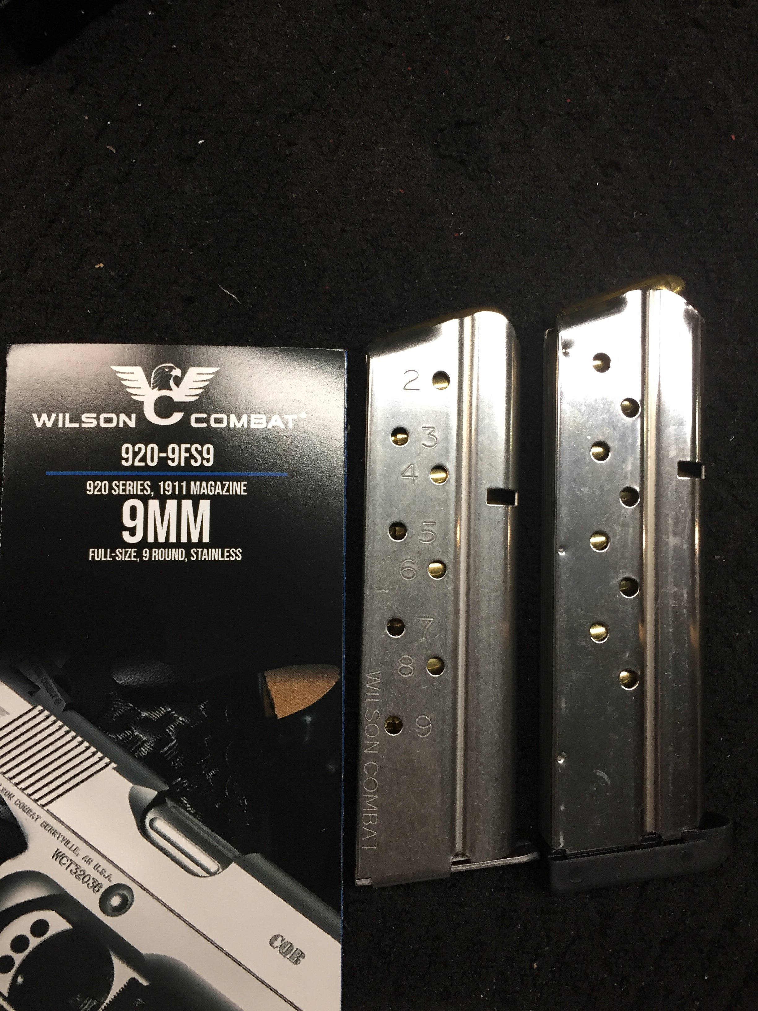

So my new Wilson Combat mags showed up today. The instructions that came with them recommended loading the mag and letting it sit overnight prior to use due to how heavy the spring is in them. I was only able to get 8 in the mag as 9 and 10 were going to go in rather hard. The magazine on the left in both photos is the Wilson. As you can see the spacer at the rear appears to be plastic or some sort of polymer. This is Wilson part number 500-9...1911 Elite Tactical Magazine 10 round with ETM Base Pad. I’ll report back after I get them to the range.

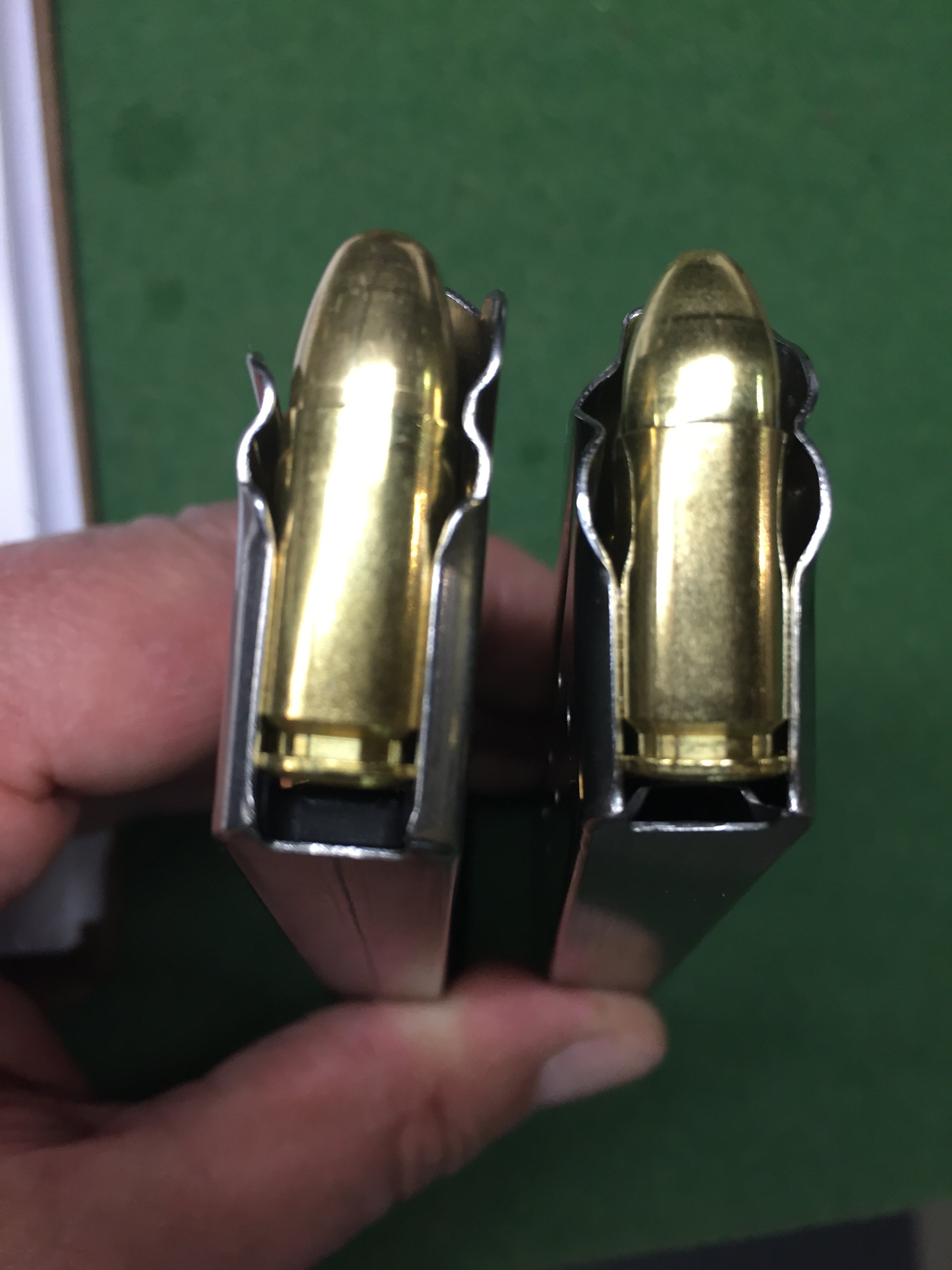

I also purchased this Wilson Magazine as well. It was slightly cheaper than the Wilson mag in my other post. As you can see this is a 9 rounder with no base pad however it’s drilled and tapped for one. This Wilson mag has the metal spacer at the rear of the mag similar to the factory mag. This mag does not nearly have the spring pressure of my other Wilson or factory mags. I was able to load 9 rounds into it very easily. This mag is part number 920-9FS9, 920 Series 1911 Magazine 9 round.
